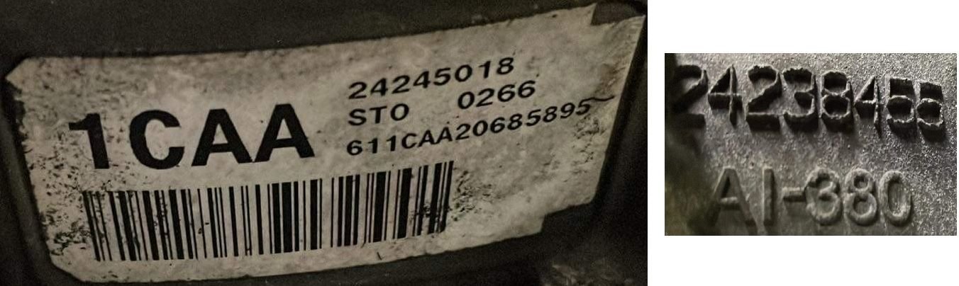

Hi, wondering if someone is able to tell me what transmission this is and possibly where it came from? Believe it might be a 6L80 from a 2WD Escalade but not sure and am looking to buy it. Thanks

If you goggled it you would find: http://oemcats.com/oem-parts/24245018.html

6L80
Avalanche; 5.3L; 2WD. Escalade ESV; 2WD. Silverado, Sierra; 6 Speed; 6L80; 2WD. Tahoe, Yukon, Escalade; 4.8L, 5.3L; 6 Speed (6L80); 2WD. Tahoe, Yukon, Escalade; 6.2L; 2WD. Yukon XL, Suburban; 6.2L; 2WD.

The 1 indicates the year. I'd say 2011 in this case. Doubtful that it is 2021.
