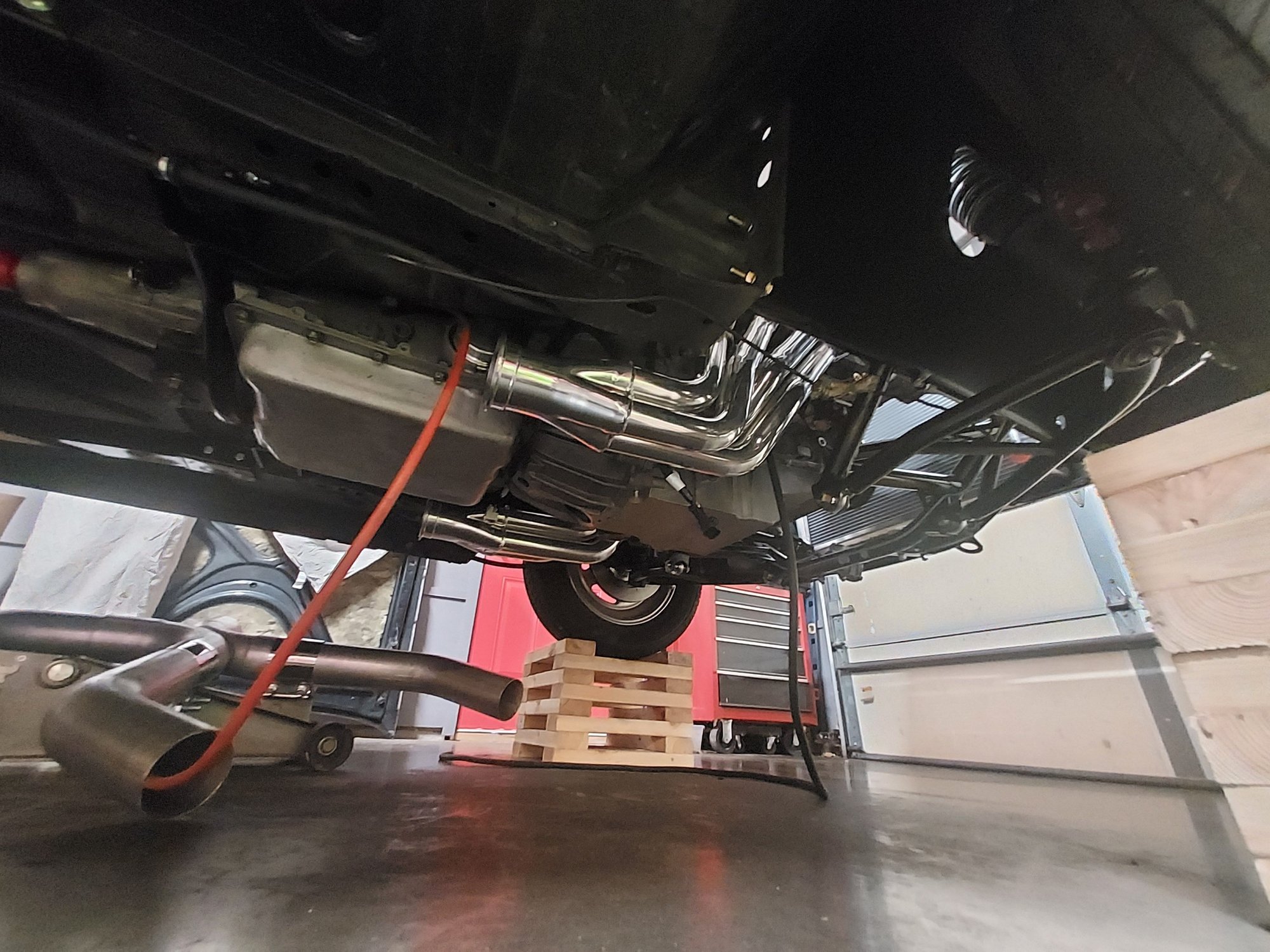

Wilwood street brakes and QA1 single adjustable front struts. 14" x
TCI 1 7/8 long tube headers so much room the headers will fall from the top all the way to the ground.
3" x pipe gonna reuse my flowmaster 44s. Will eventually switch to borlas or magnflows .

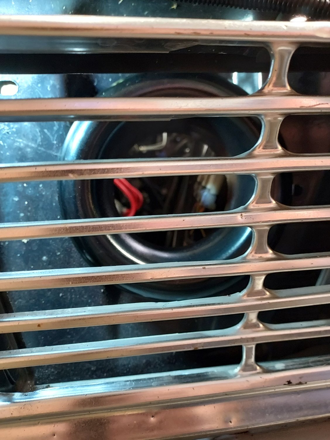

Terminator x harness has to be made for a truck. Some parts are way too long and others are parts too short. I understand its a universal harness but wow.
Building the intake tube was pretty easy so far
Going to place a small flat filter infront of this bellmouth

Added tail pipes to the exhaust.
