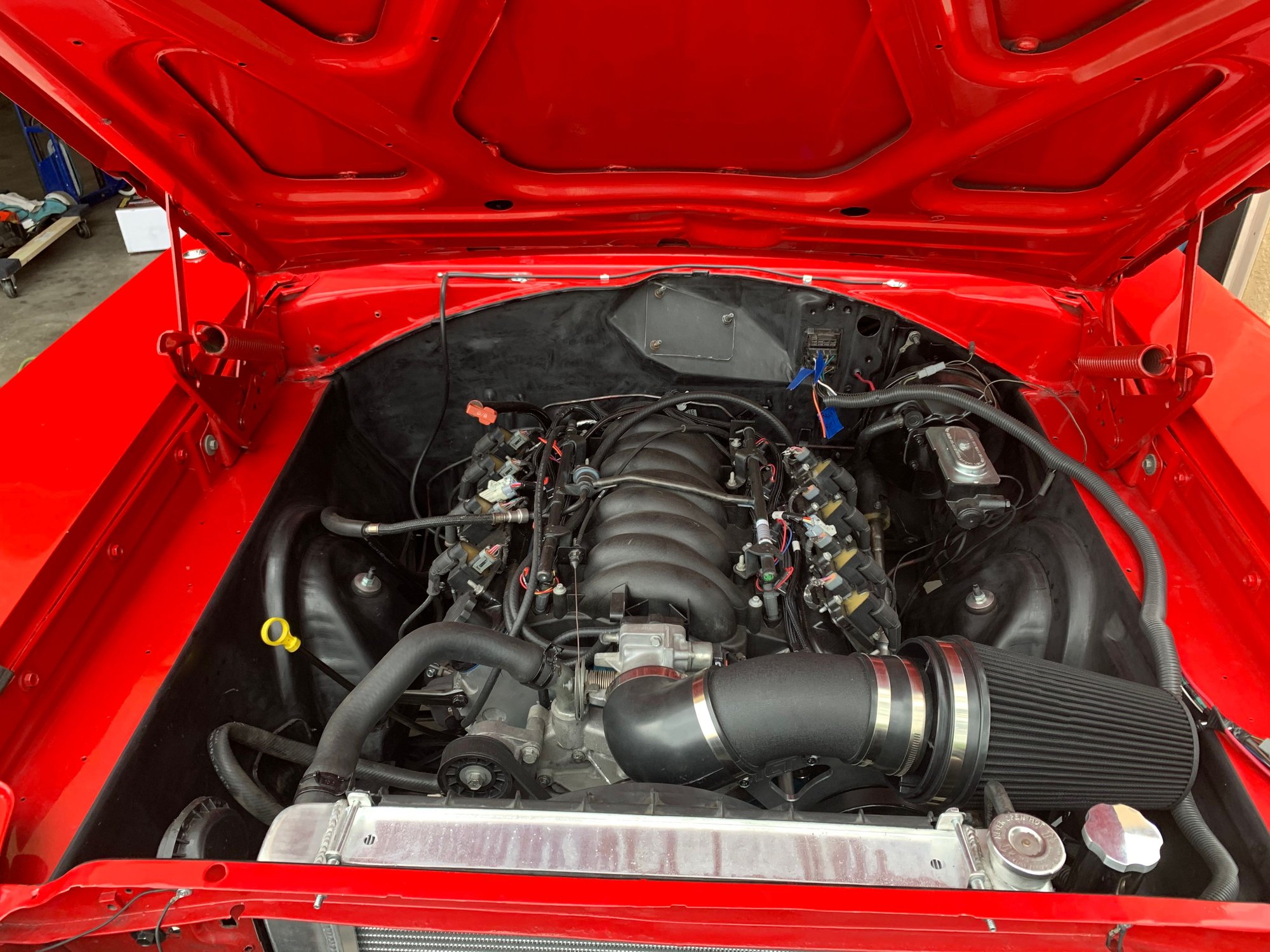

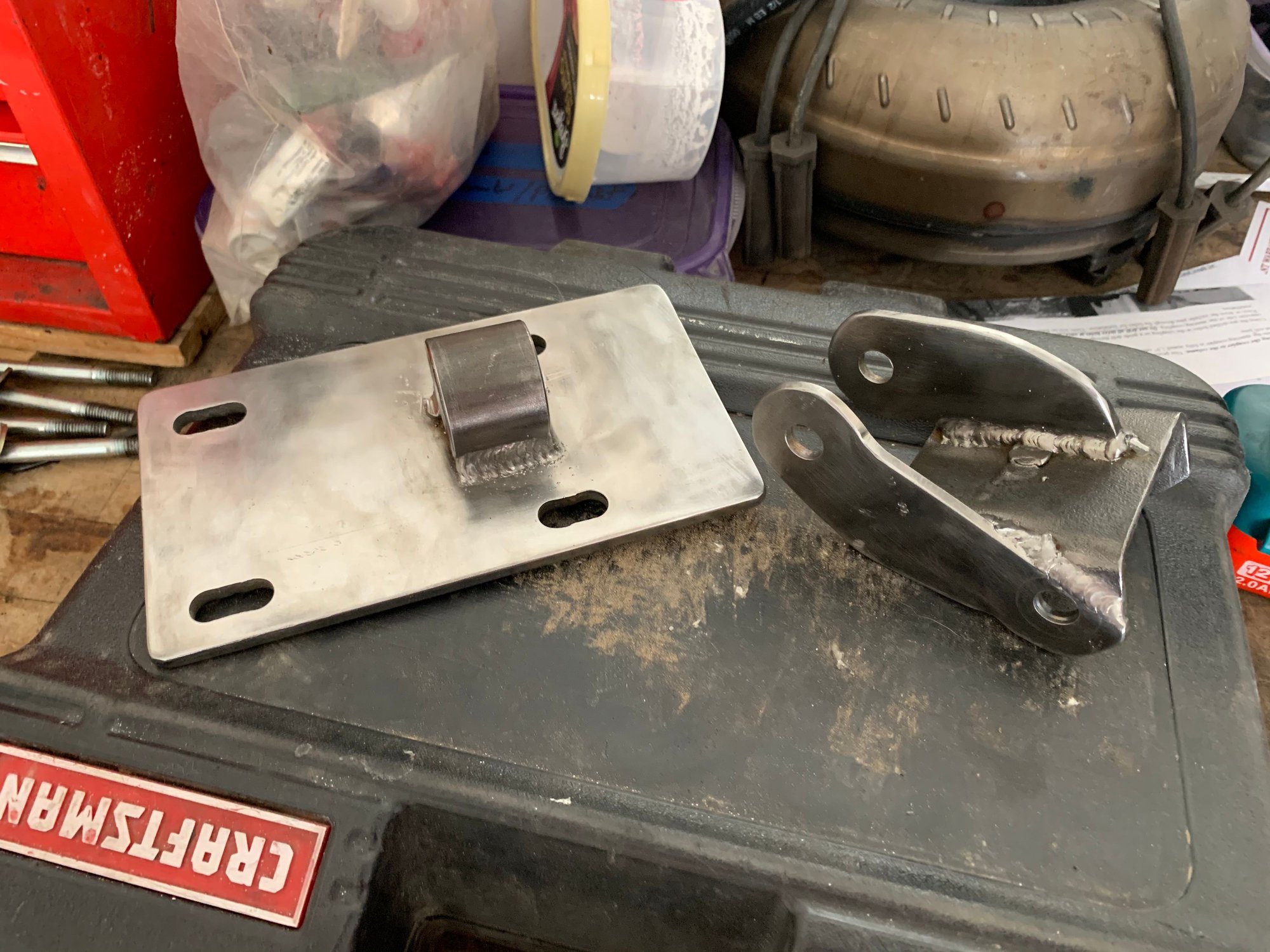

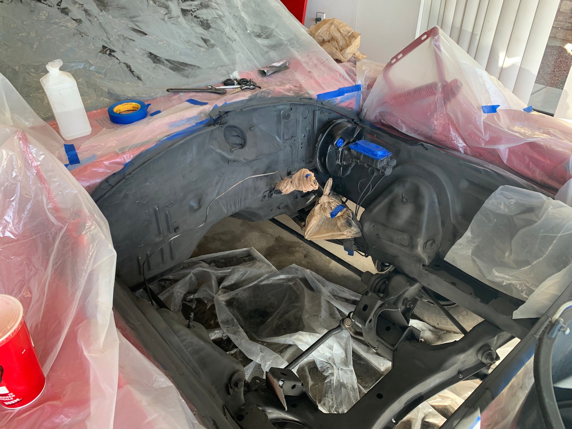

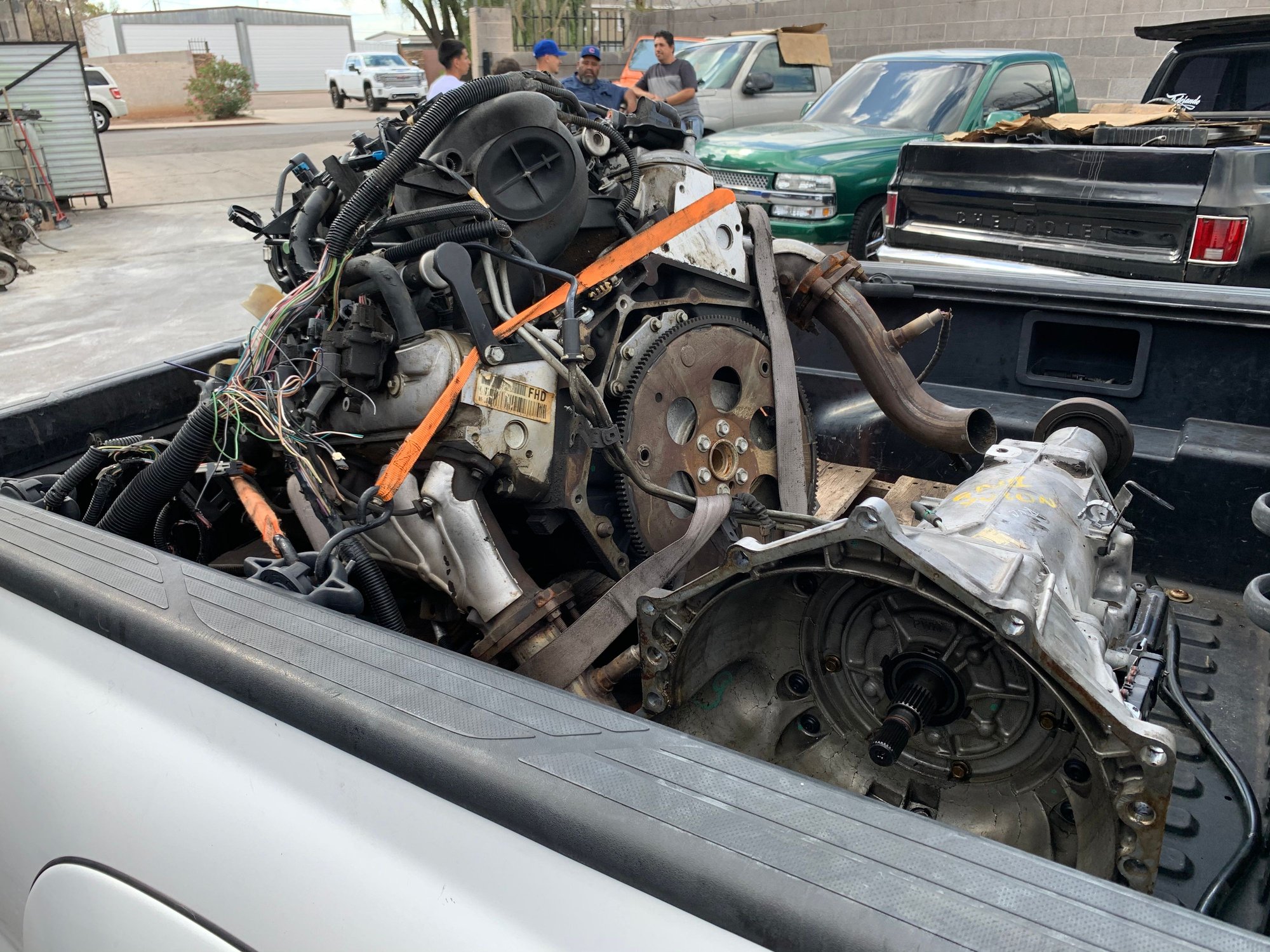

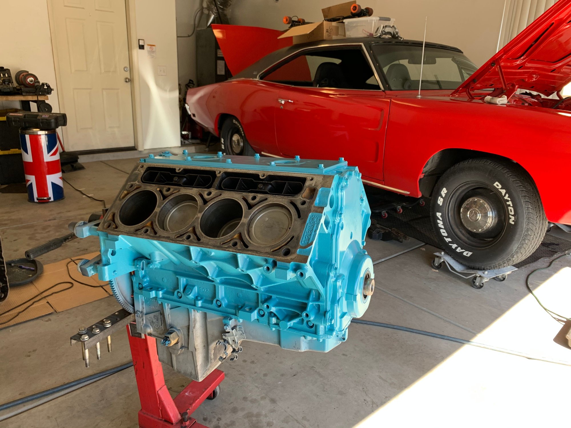

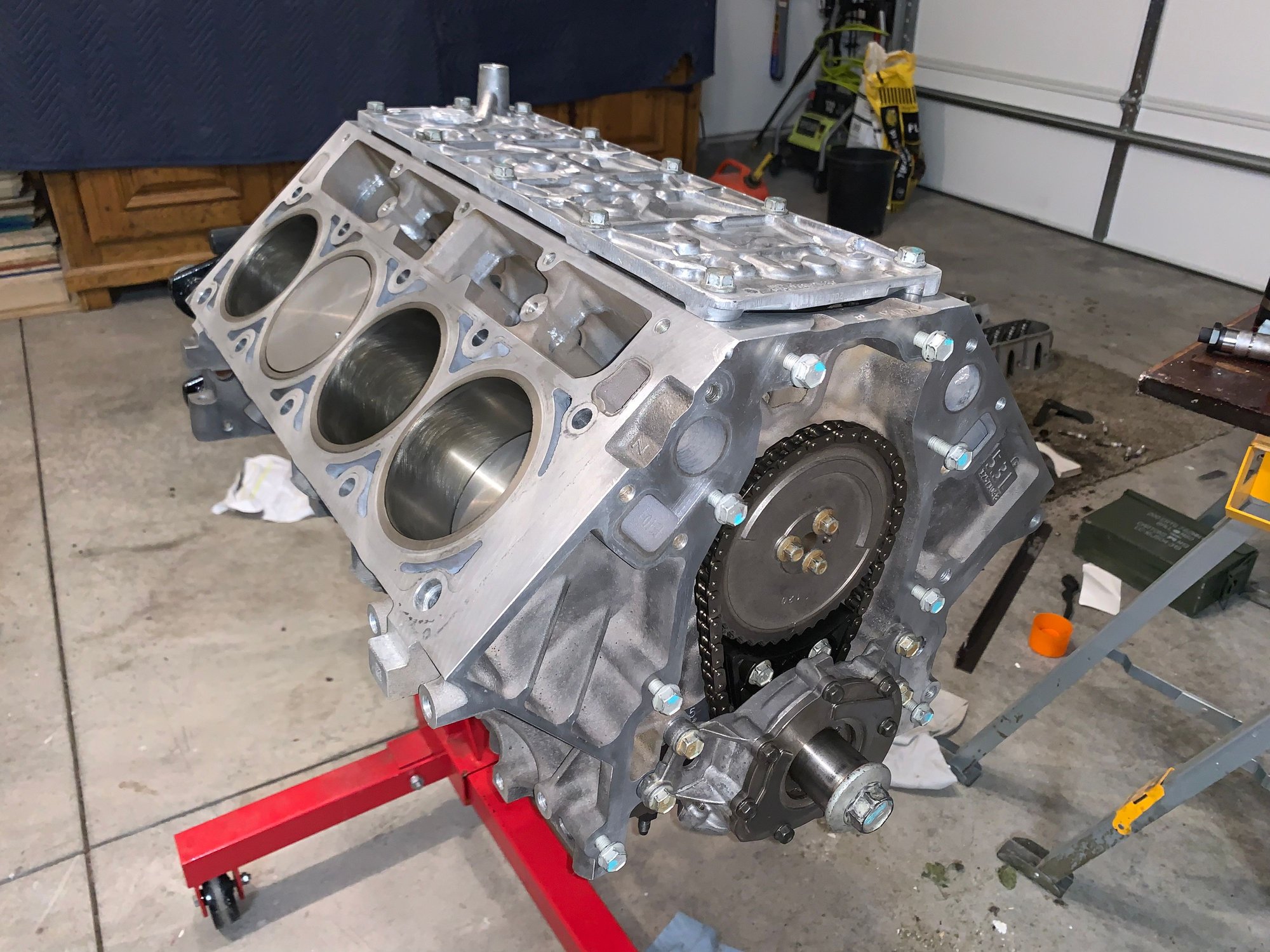

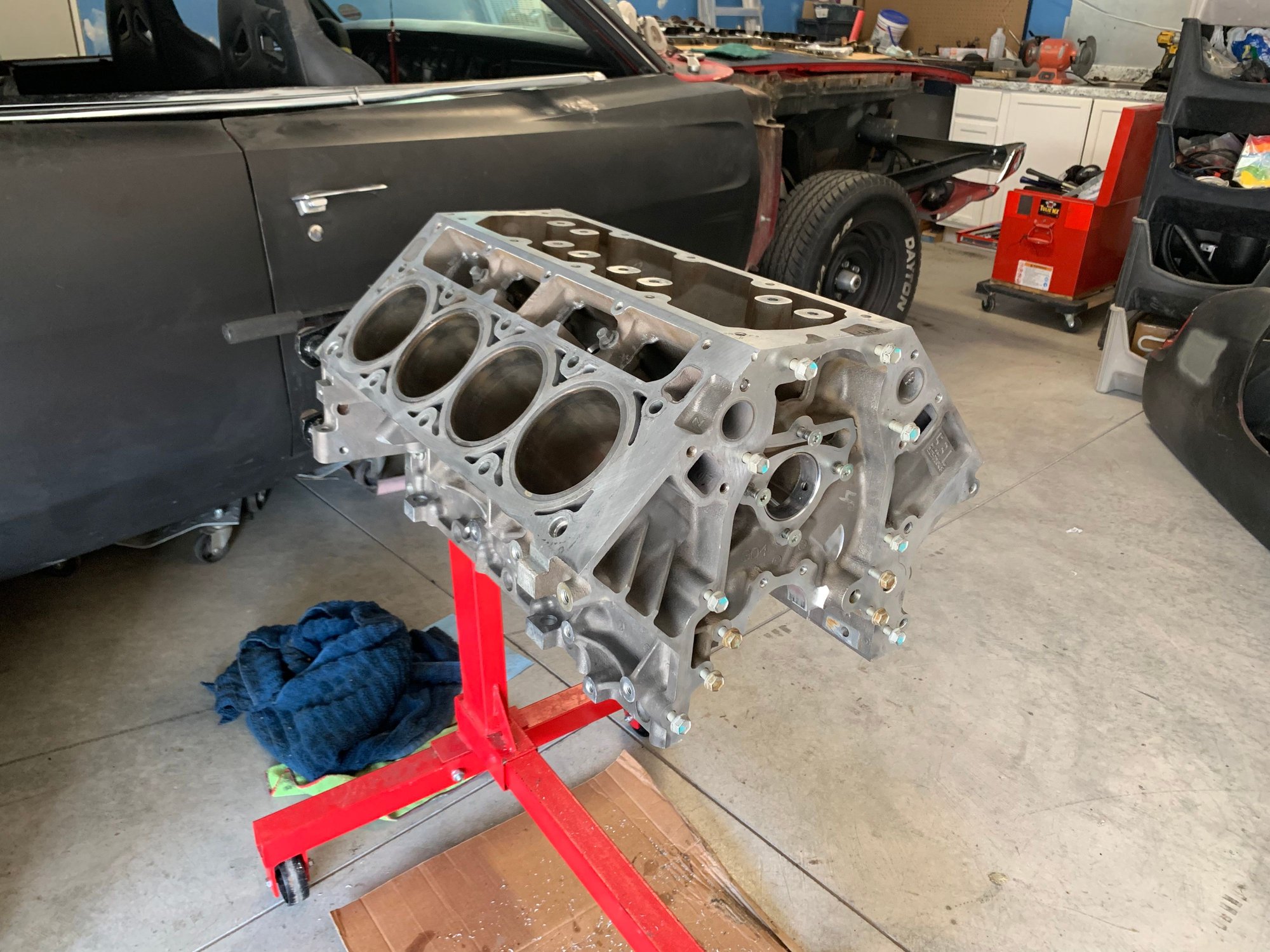

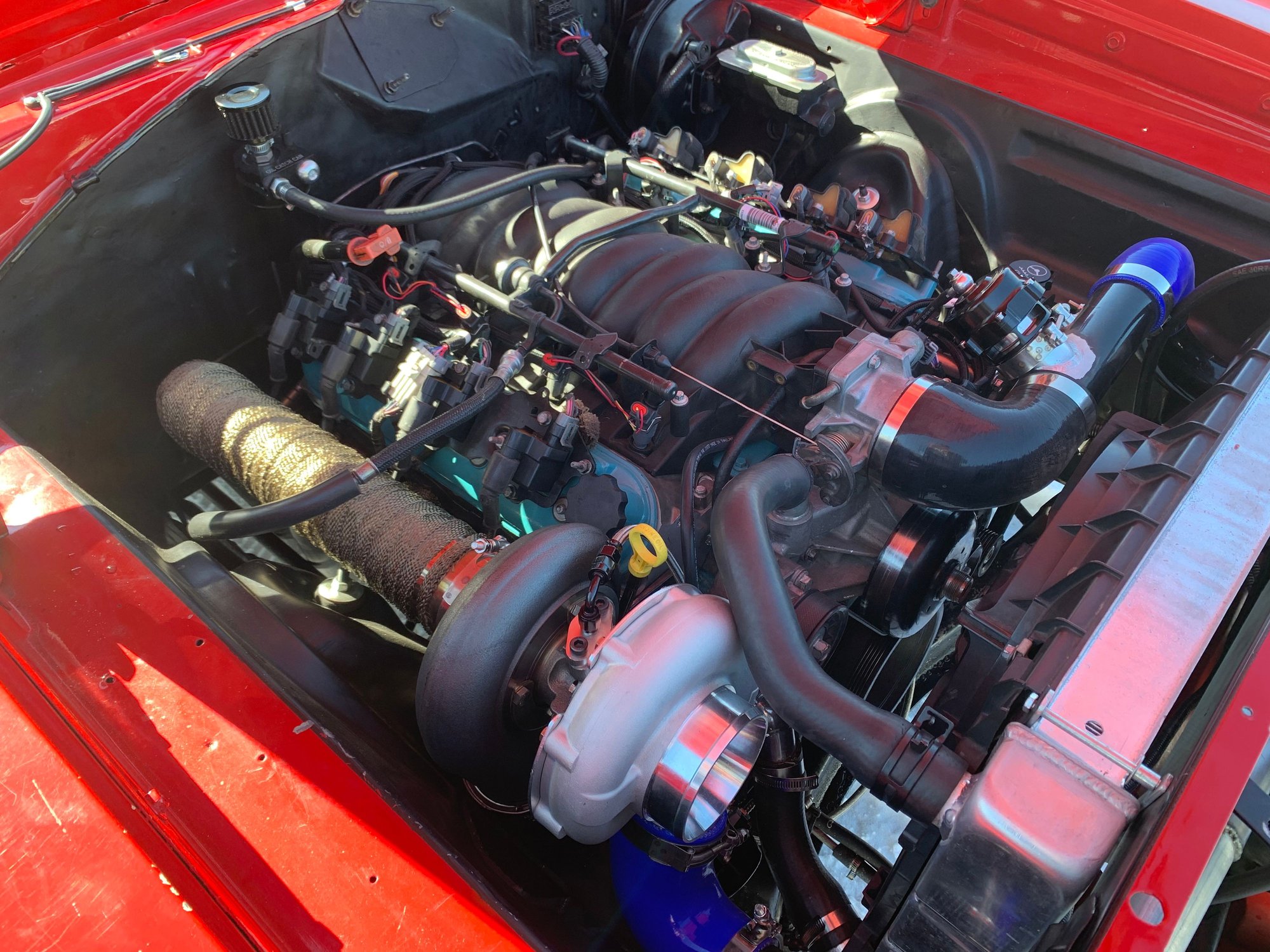

I have a thread on FBBO but I figured I’d start one here as well. Here’s my 69 Charger road race/autocross project car. I pulled the 440 out of it and swapped an LM7 and 4l60 into it about 2 years ago. Ran it N/A for a while before putting some boost to it and melting some holes in a couple pistons. It sat for about a year and I just got around to building a new aluminum block 5.3 for it. Just a pretty basic engine with flat top pistons, BTR cam, 706 heads, ls7 lifters, ARP head bolts, etc. It should be around 10.3:1 compression which is a little higher than I would like, but I'm thinking it'll be fine on E85. It'll take 100 pounds off the nose and hopefully make in the neighborhood of 800whp this time
