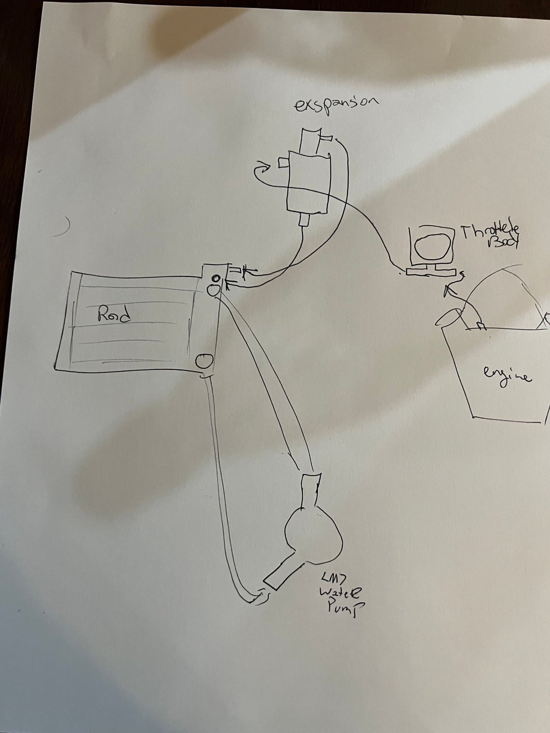

Have a Lm7 swaping into an e46 . It has a whipple super charger on and a summit racing radiator and we have a moroso tank trying to figure out how to set it up . Because of the supercharger the top radiator hose sits pretty high to trying to get above.

Unless you are going to run the car in cold weather I wouldn't bother running the head vent line thru the throttle body. I'd just run it directly into a fitting on the radiator. Then the exspanion tank can just be an overflow tank.
Just my .02.

How much of an effect does it have in the cold if you don’t run thru the throttle body, it’s in colorado so the winters are quite cold ?

I don't think the hose through the throttle body really changes anything. I'm in St.Louis, and it gets pretty cold here too. I've never had any issues. The cold start and warm up will mostly be based on the cold start enrichment table settings, and as long as the rest of the tune is correct.

On my 98 Wrangler LS swap I deleted the coolant hose to the throttle body. I use it to plow my drive way in the winter. Starts and runs great even at -20.
