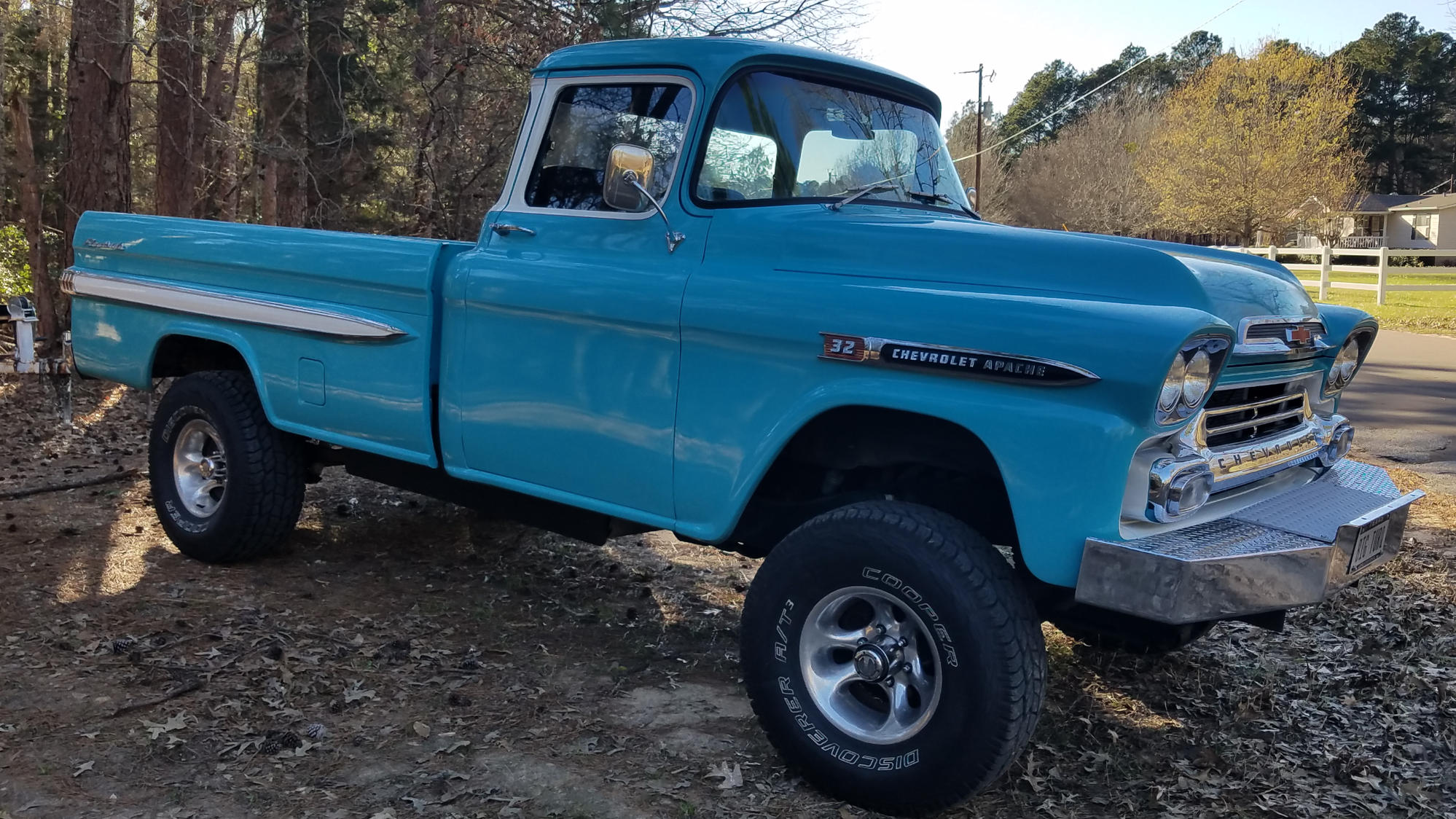

Hey guys. I'm relatively new here and looking for some advice.
Here is my journey:
Mine is a 1959 Chevy Apache long bed, mounted on a 1979 K20 4x4 frame. Its sports an LS3 430 Hp, 430 FT/lbs connect and cruise from Chevy performance. It has a 4l70e transmission. 4.10 gears in both axles.
Some notables: Dakota Digital cluster, vintage air a/c..... DD cruise
The truck has about 55,000 miles on it since the swap.
The first 35,000 miles were amazing and trouble free
Then the drama began.
What I've tried since the P2138 code started:
replaced Throttle body, ECU, pedal , Changed both wire pigtail ends, DD cruise to pedal harness.
Like others, there is no rhyme or reason. I have driven a few thousand miles without and issue, and other times I can't go 1/10th of a mile.
For the longest time, I thought that it was the DD cruise control. I drove without the pedal harness attached and thought I'd solved the issue.
When it started again, I completely removed the cruise....wiring, box and all.
Again, because I drove a couple of thousand miles without the code, I thought it was fixed.
nope
So lastly I attempted to replace the pedal pigtail again. It seemed that every time that I unplugged and plugged it back in, I experienced some success.
But, now the truck immediately throws the code and it won't reset
So what would yall do?
1) replace the TB, pedal , and harness as a group? about $1500 in parts
2) do the conversion from a drive by wire to a cable driven setup? not sure the cost
3) other
thanks in advance
