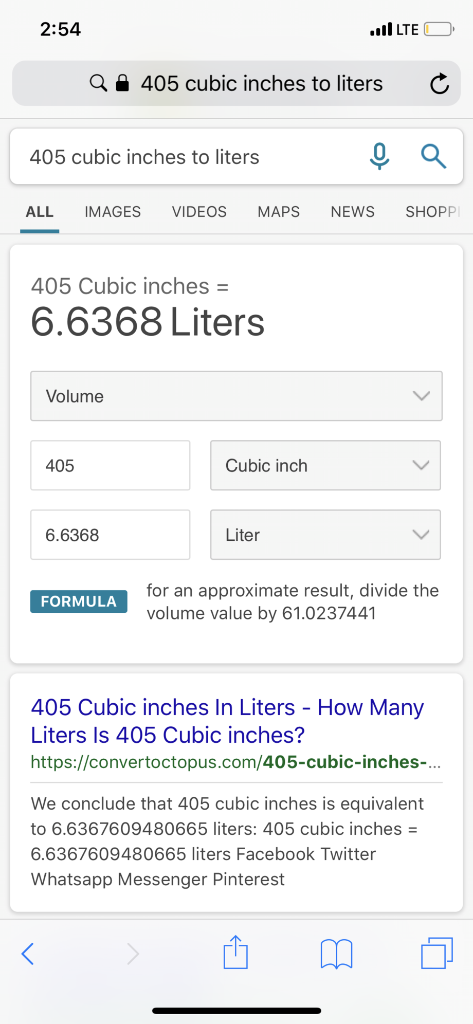

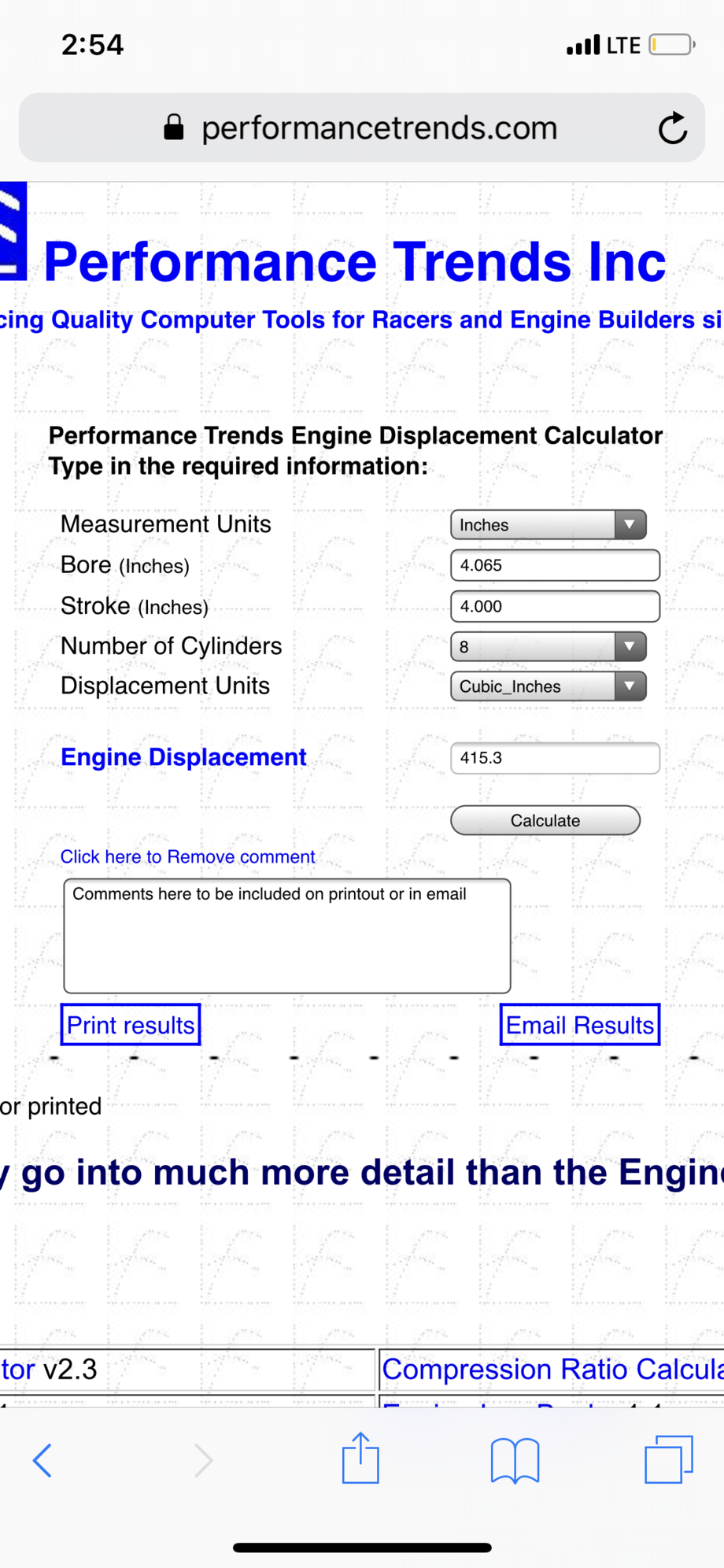

Alot of people dont realize this but they offer a 3.900 stroke crank that makes an Ls3 a 405 cubic inches.
https://www.lsxceleration.com/k1-tec...aft-012fae390/
