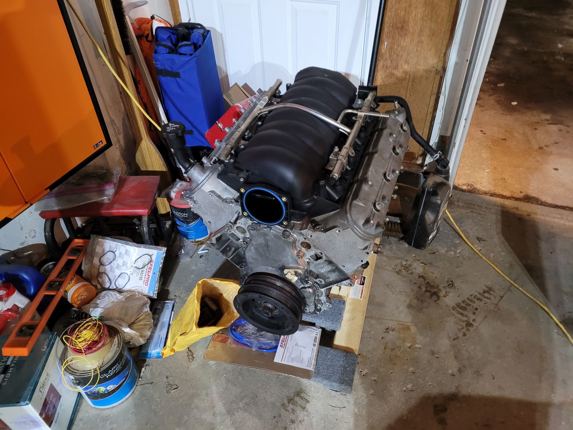

I picked up a L76 from a G8 last week, to put into my 84 Trans Am. As soon as I build my account up again I'll be on the look out for a T56.
As you can see I have to piece it together as previous owner kept most the parts since he's swapping a LS3 into his G8.
things i know about this L76
has 110ish k mi on it.

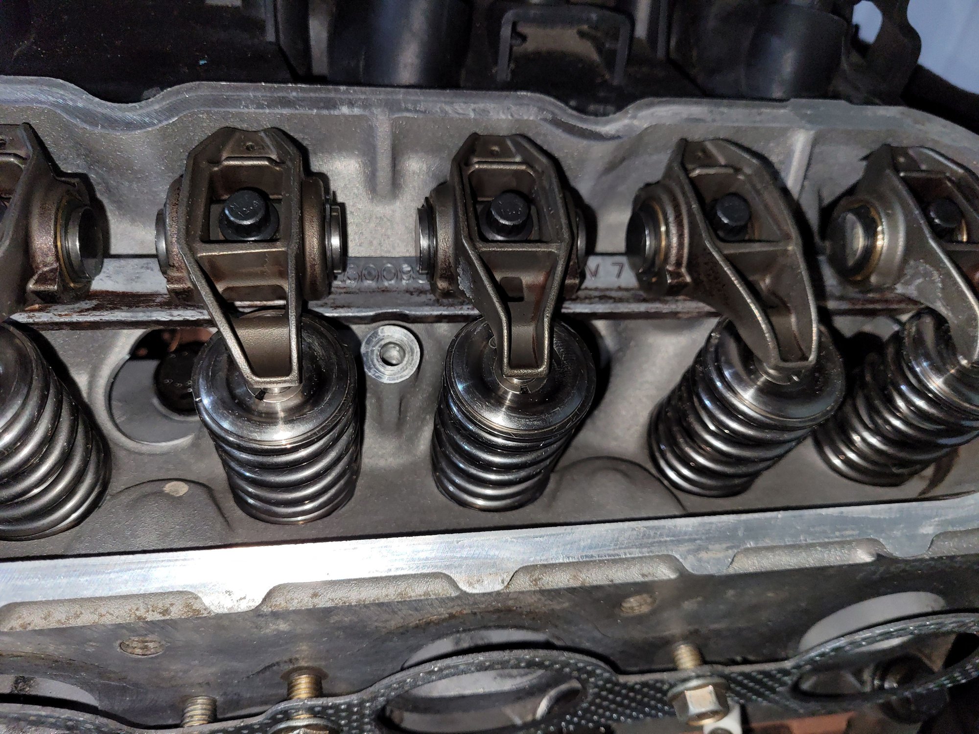

This is list from P.O. of things done 500ish mi ago.
Ls7 lifters, thumper cam, new timing chain, tensioner, timing gear, lifter trays, LS9 head gaskets, oil pump, gaskets, arp crank bolt, arp head bolts, exhuast gaskets, oil pressure switch, valley cover is non dod, ls3 intake, valve seals, dual btr valve springs. I probably missing something. 😕

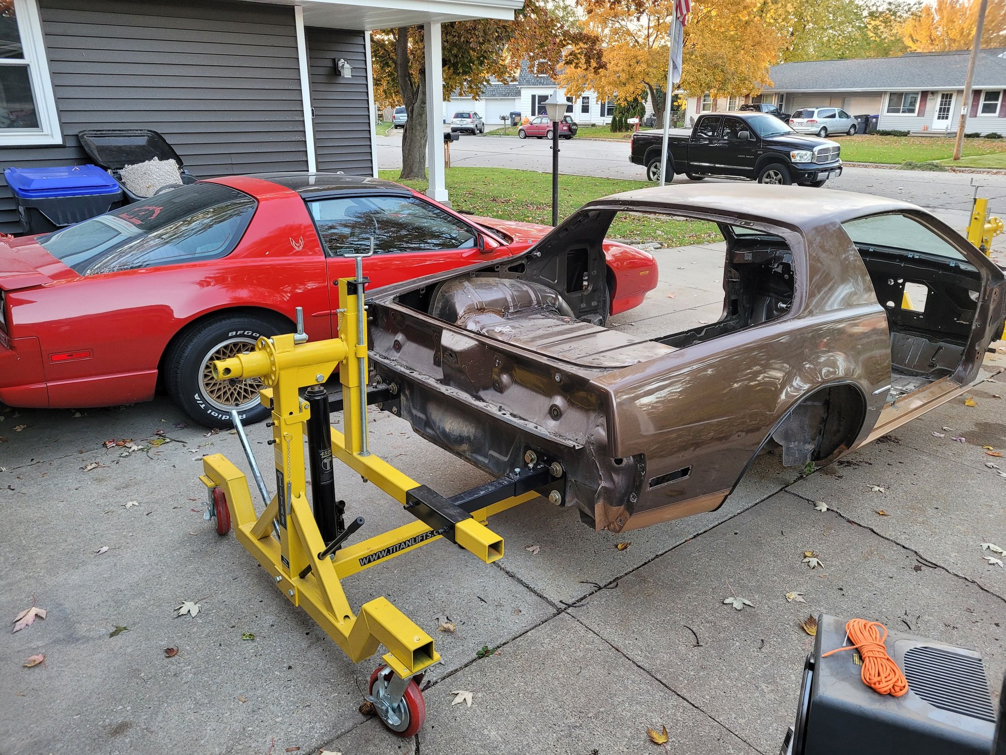

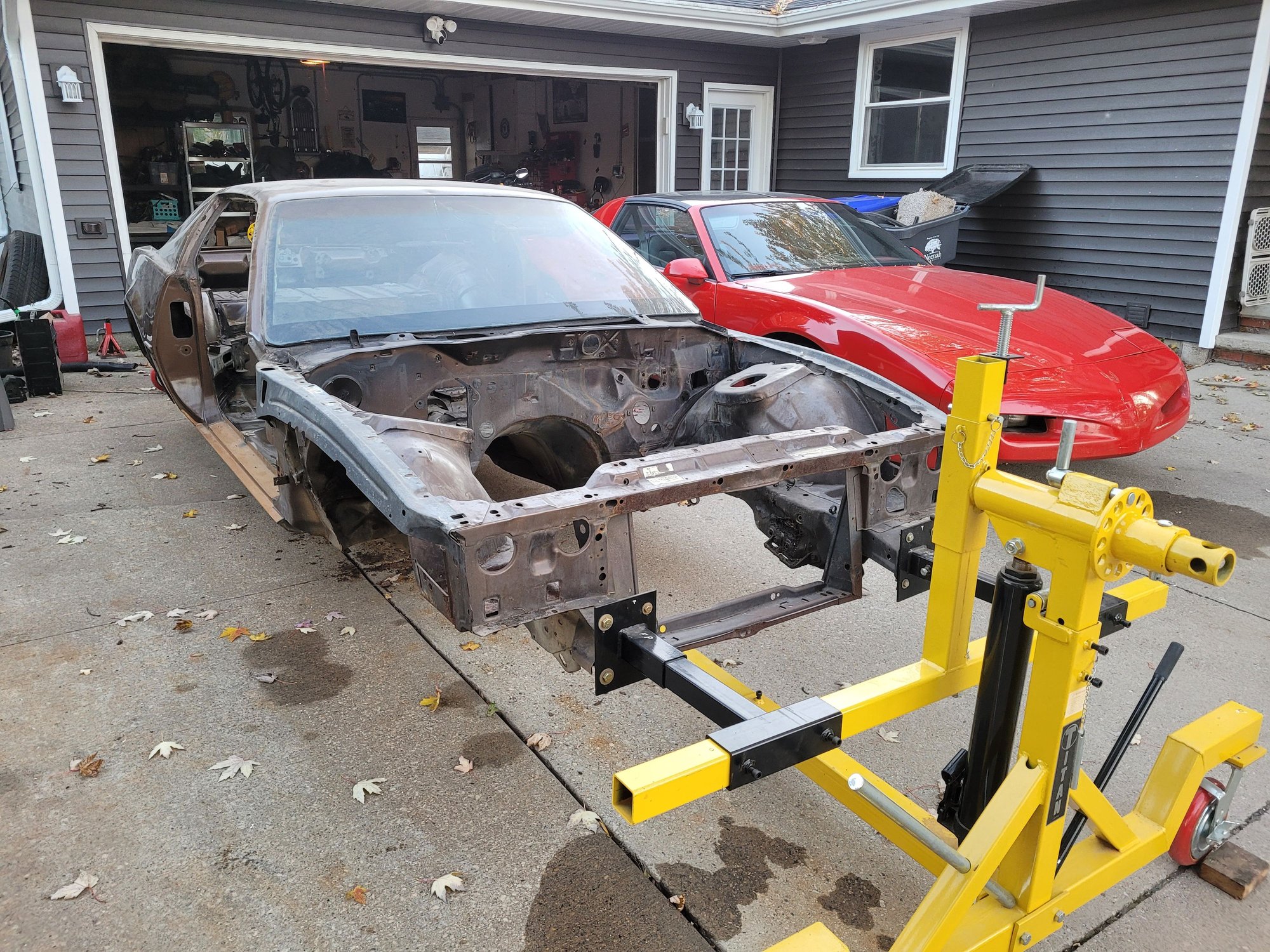

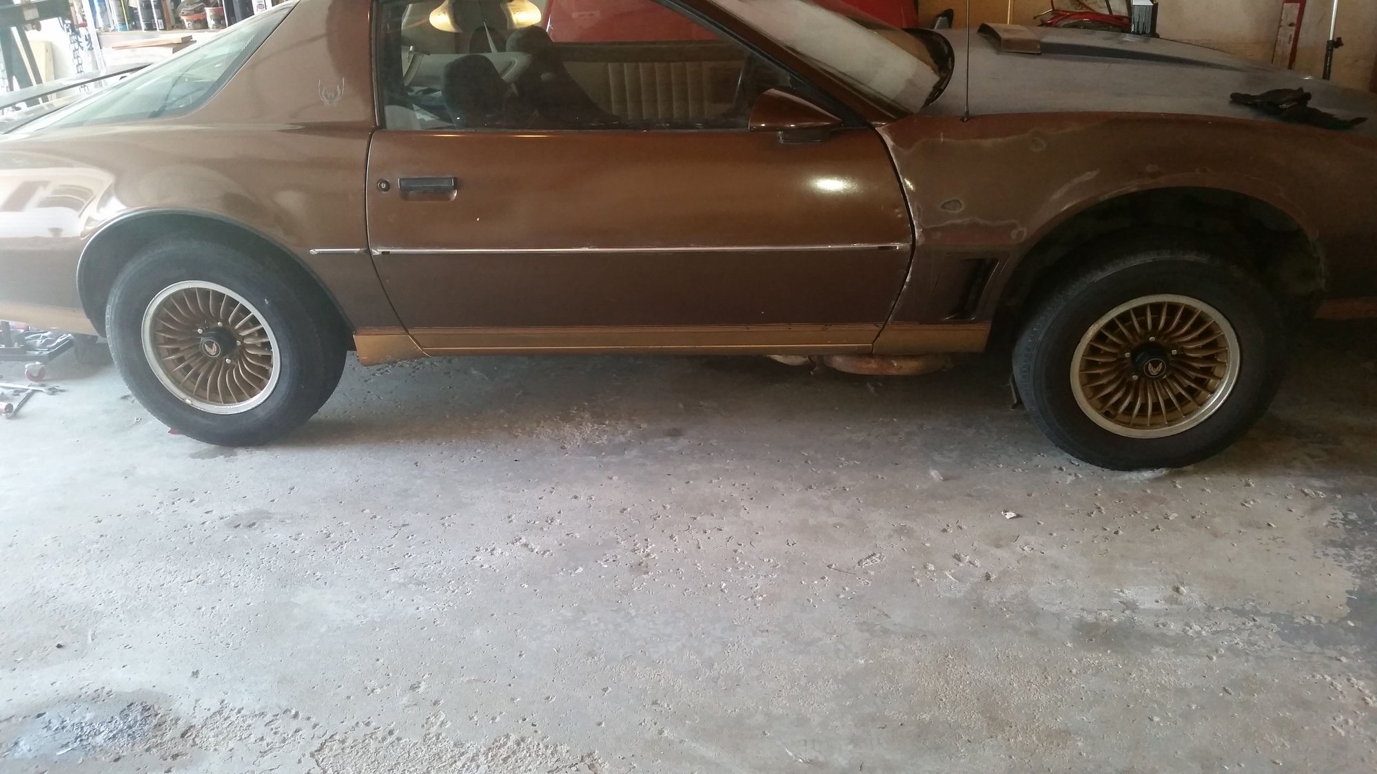

I'll put a couple pictures of the car as well. I've had it since I was 15 and only drove it for a month before the 305 let go. It's been sitting ever since. Finally started tearing into it about 2 years ago.
When i first bought it
Another from when i first got it
Fast forward 20 years later. Car had been stored in back woods and a barn during that time before i had a garage of my own.
From this fall
Another from fall

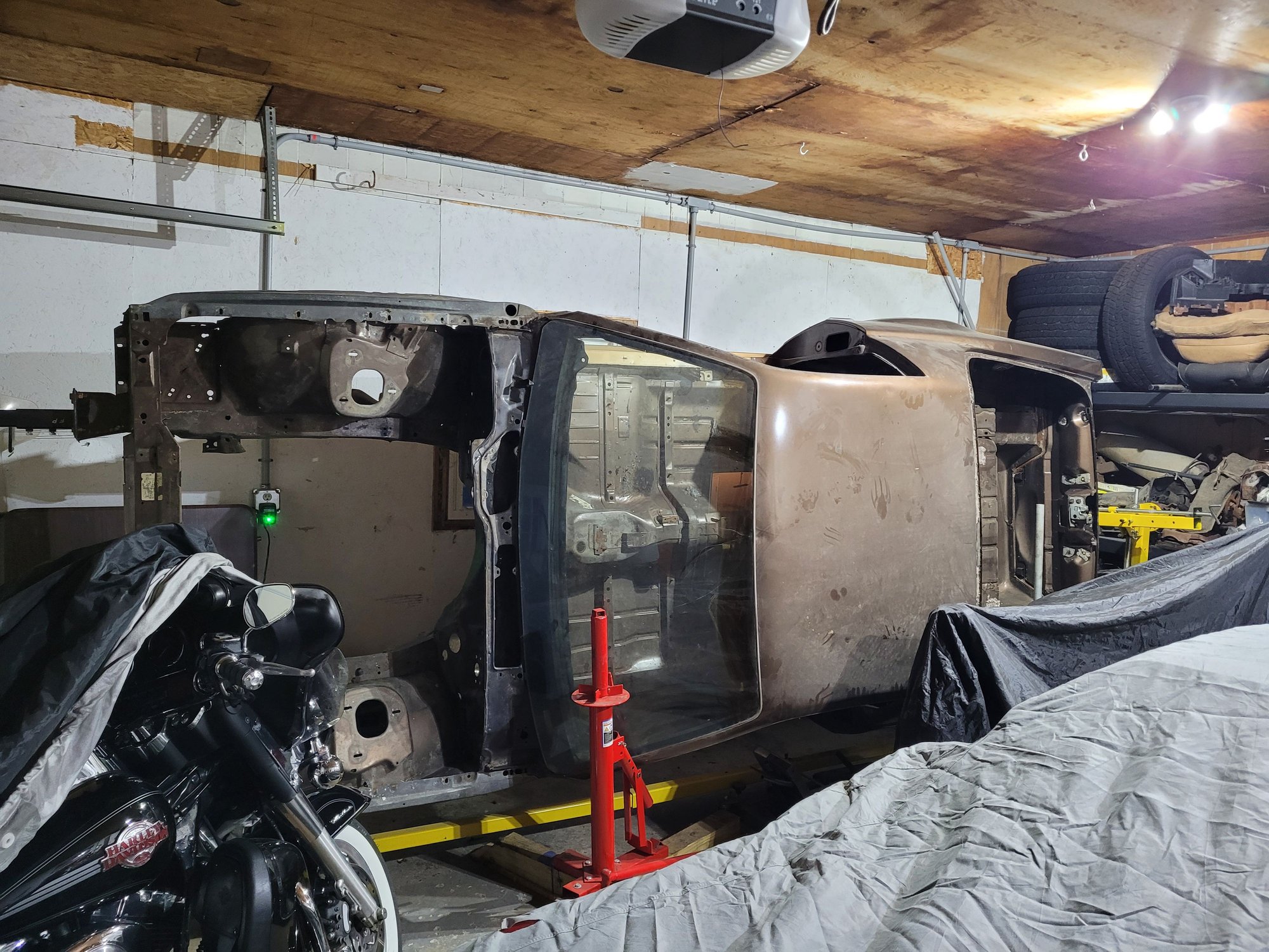

Couple weeks ago. On its side to make more room for the winter
