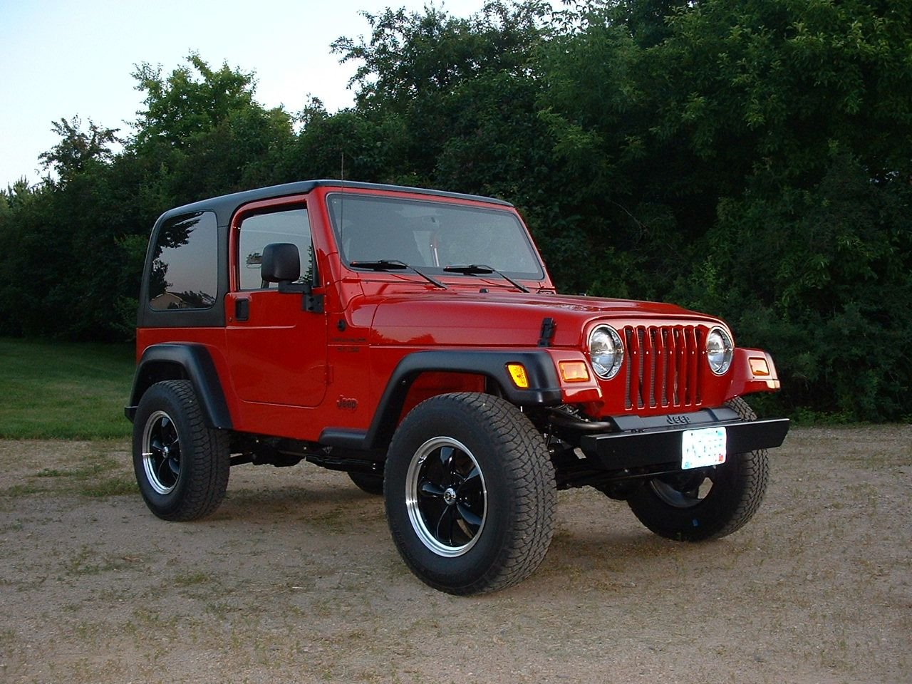

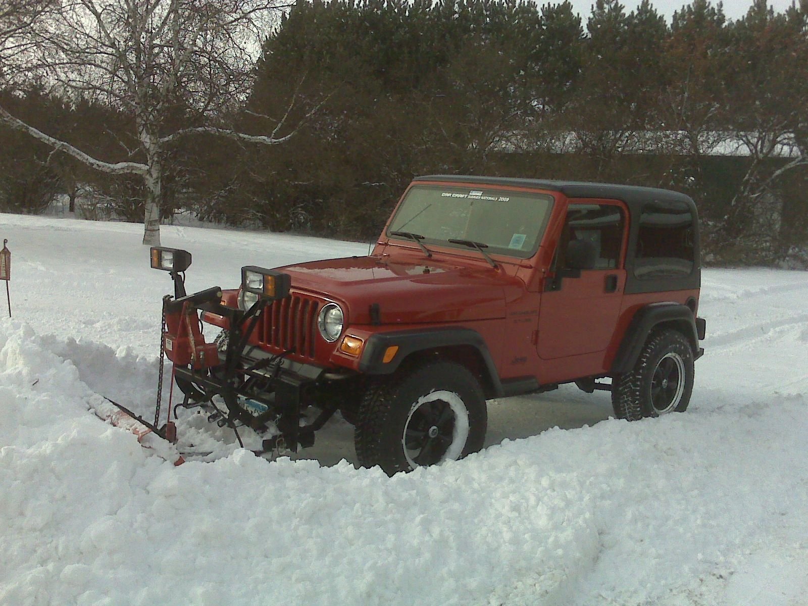

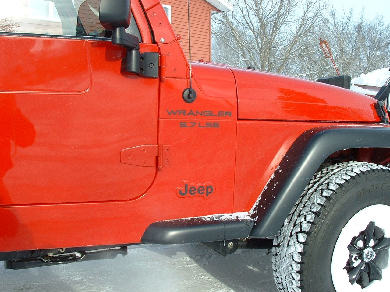

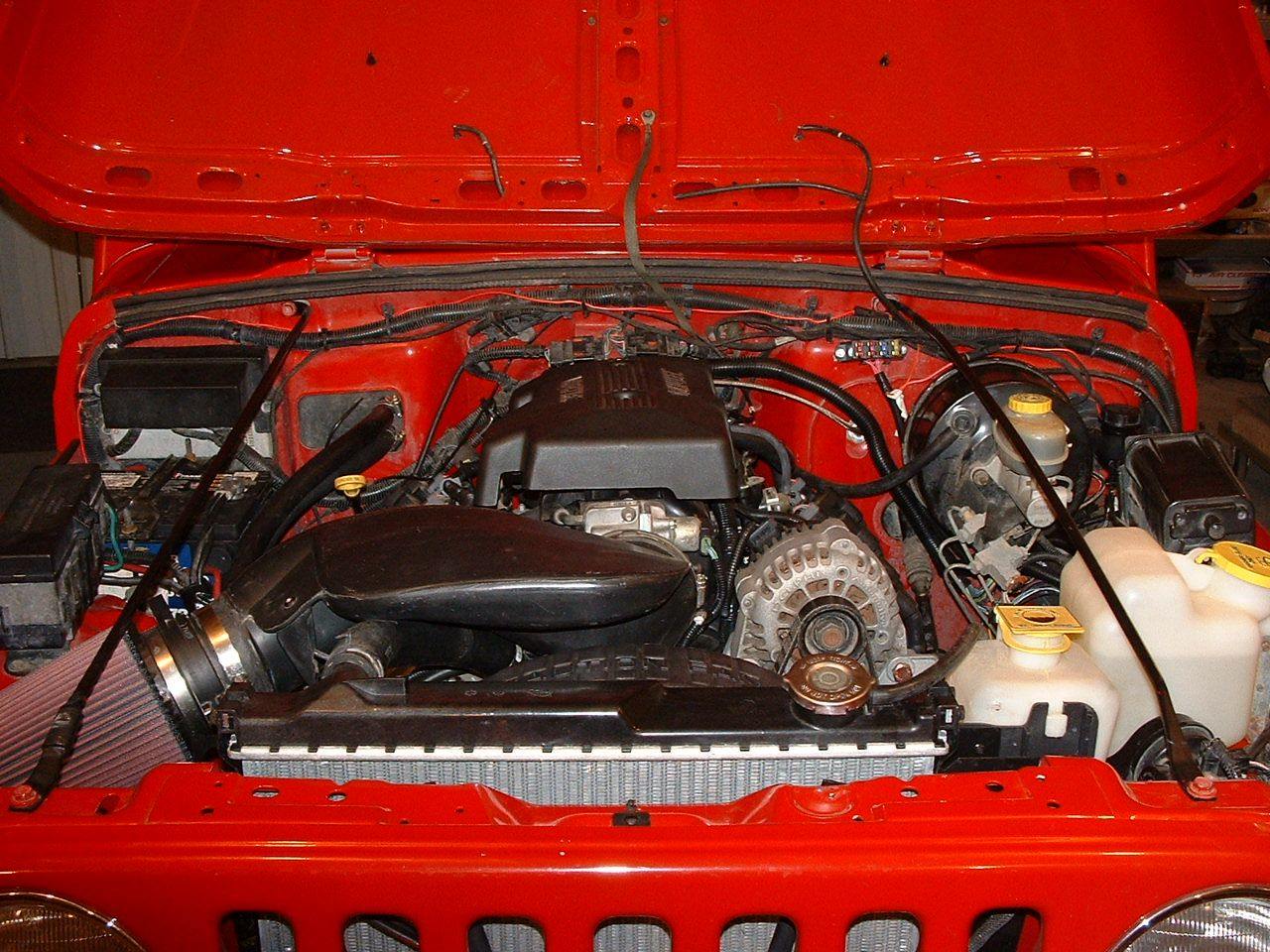

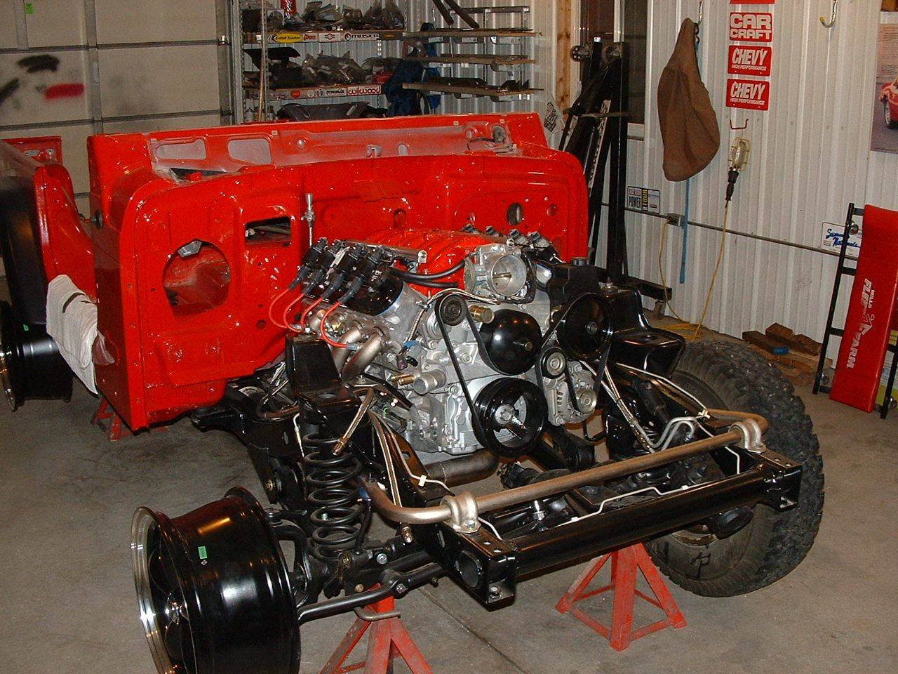

A few pics of the Wrangler. First two as the Wrangler sits today using 2002 Camaro BBK intake and FEA.. Third is when I built it the first time using a truck intake and truck FEA.

Yeah my TJ suffered serious project creep. The third pic is when I first built the TJ. It was a rust free Texas TJ that was a theft recovery. The engine you see in the third pic is a 4.8 with a AX15 5 speed trans. The 4.8 had a mechanical fan. That's 4.0 radiator/shroud in the pic. Worked well. Never over heated. Decent combo but I also plow snow with it in the winter. Got tired of shifting.
So I bought 2002 LS6 and 4L60E.
The paint wasn't great so I decided to paint it and then soon had the body off the frame so I could powder coat the frame and other assorted parts.
One thing I would say on the first pic is that the LS6 I used the 2002 Camaro front accessory stuff. It works well except when I put the plow on and the left upper control arm mount has touched the bottom of the alternator. I had to lift the TJ 2-3 inches. If I had to do it again I would use C5 front accessories. Moves the alternator up.
I will say it again its a great swap. My TJ is a true mall crawler. Never seen mud. I did have it on a gravel road once. LOL.
Snow pic.
