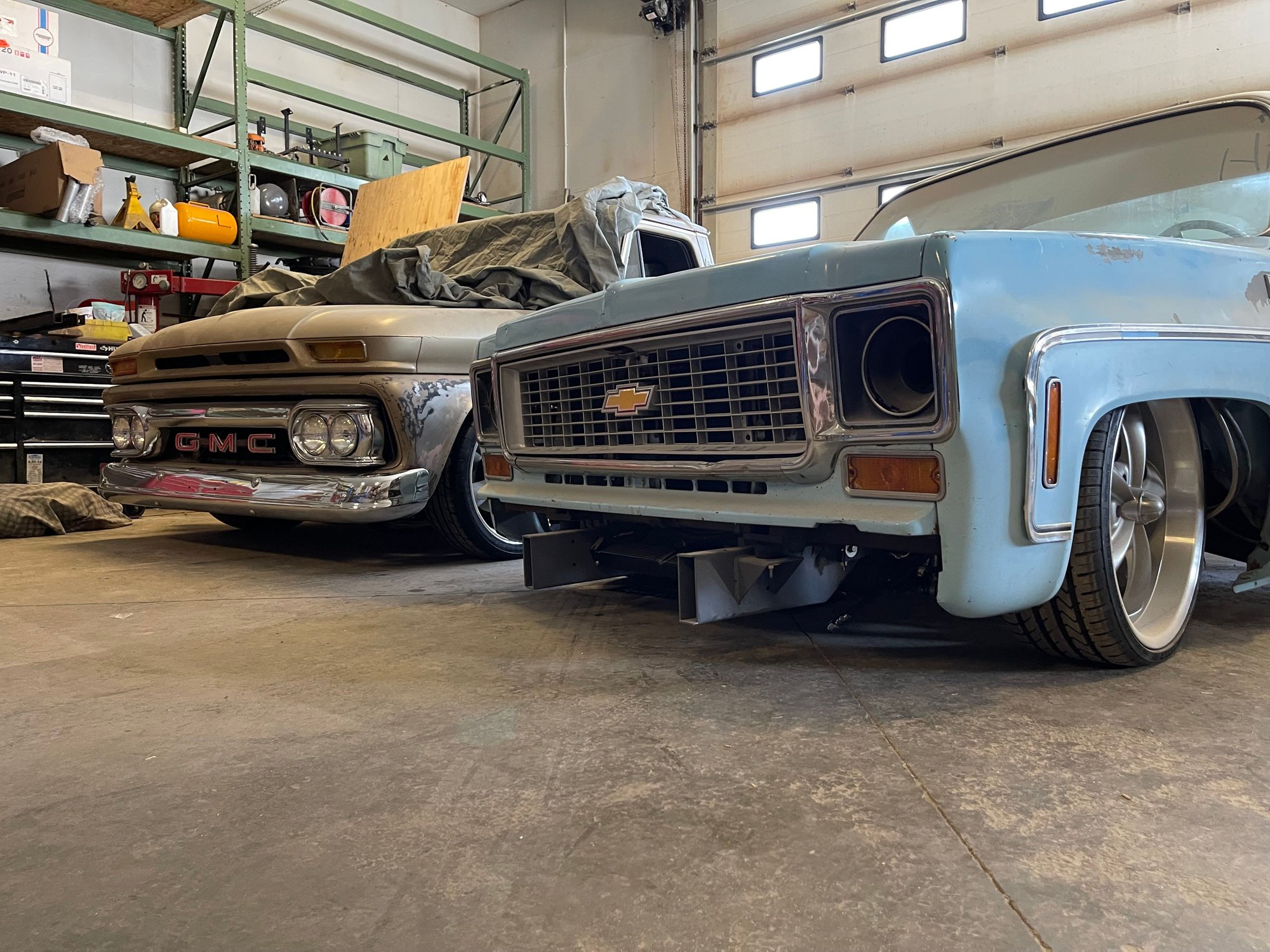

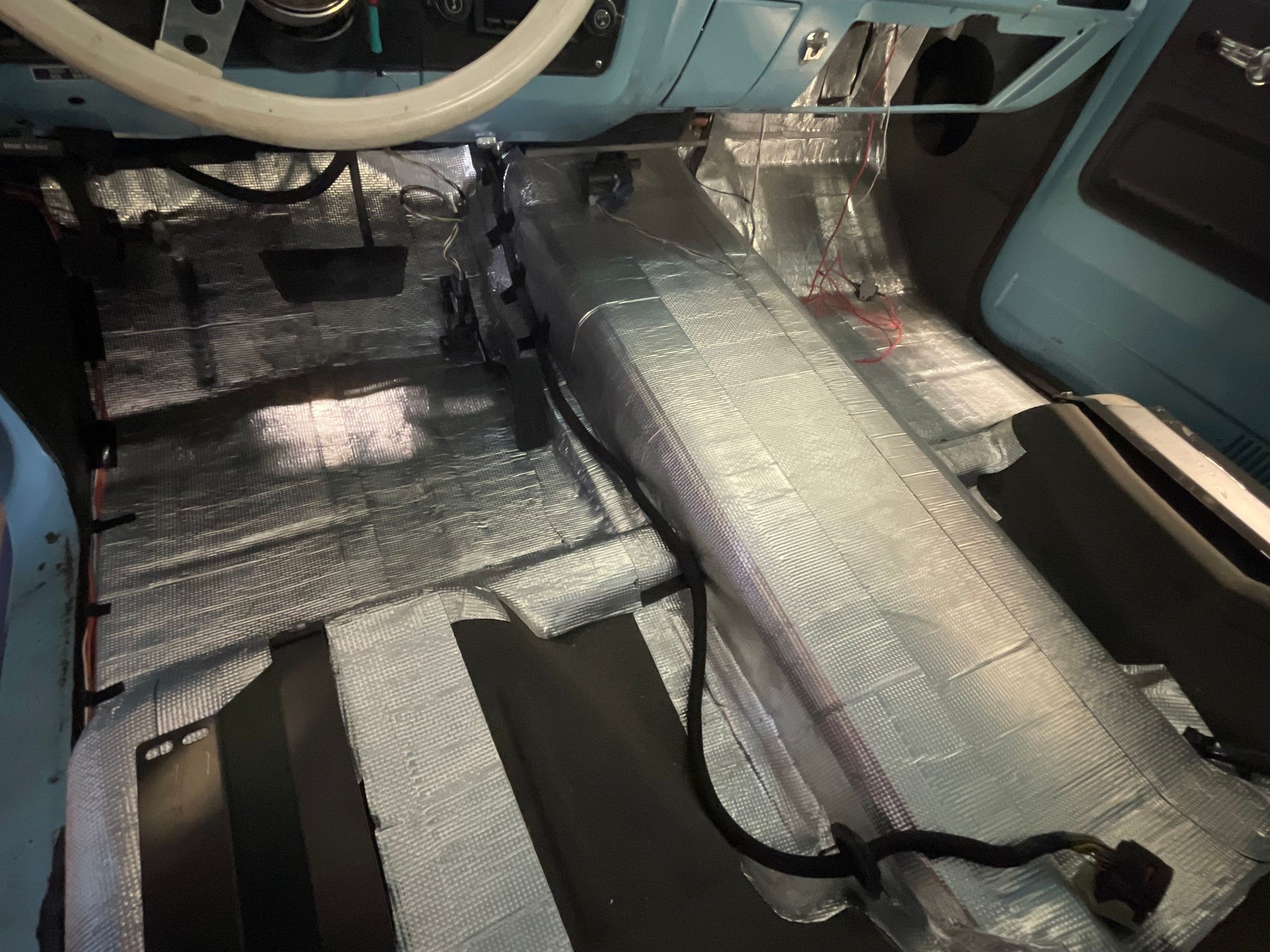

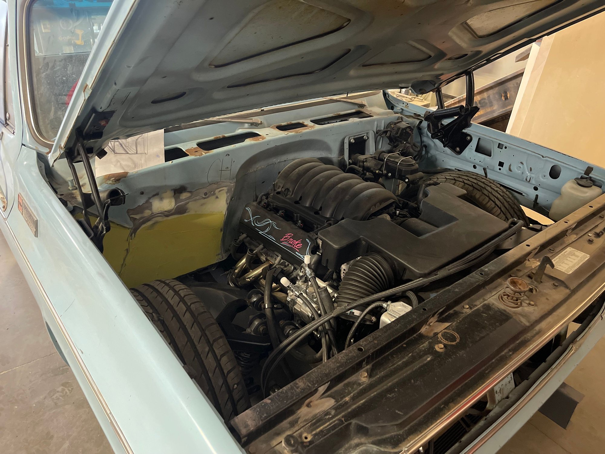

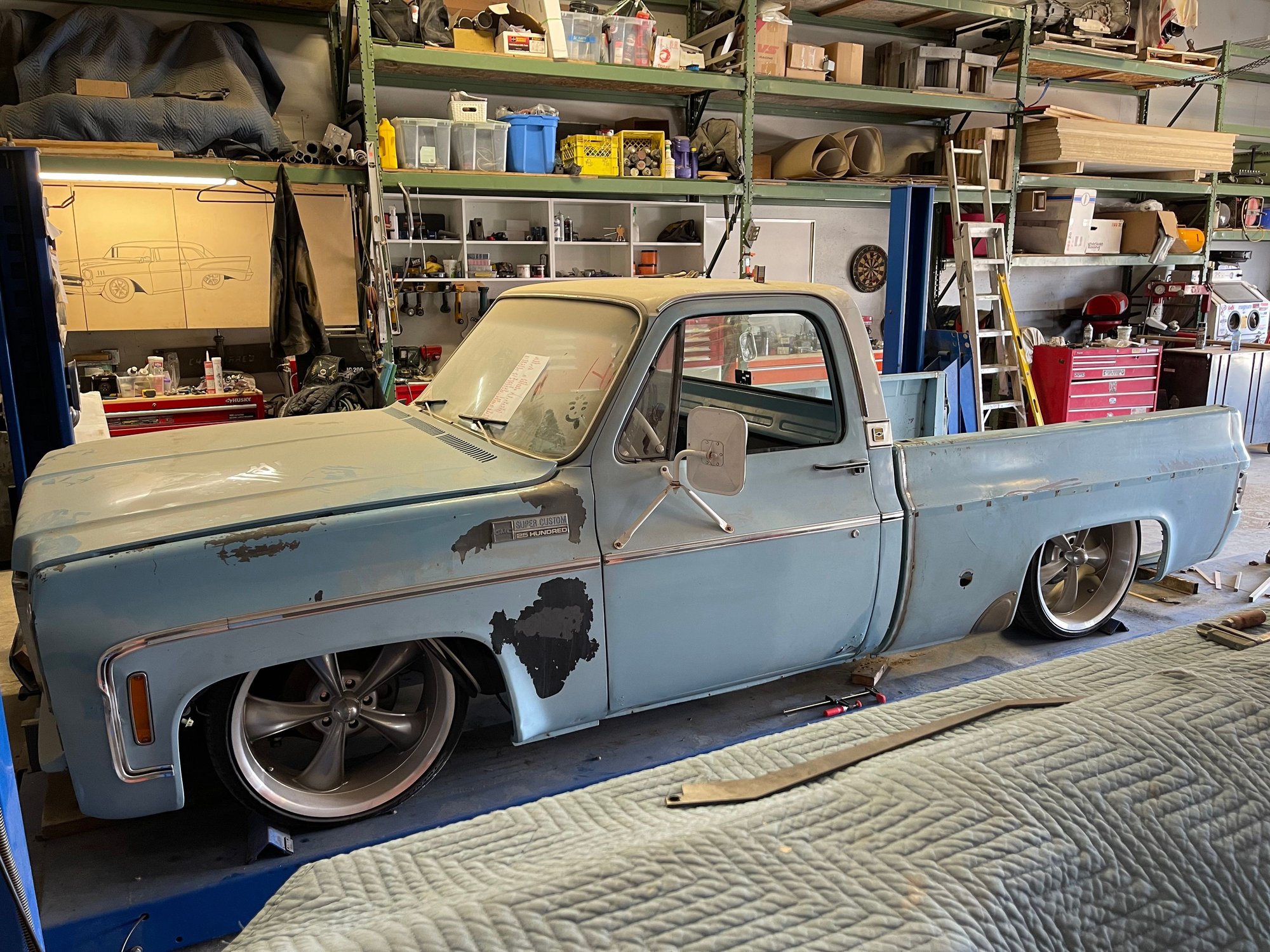

couple photos, don’t be to hyper critical, still no where close to where I want it. Custom frame, 4 corner coil, truck is body dropped to sit low over the frame. Been building it the last two years.
