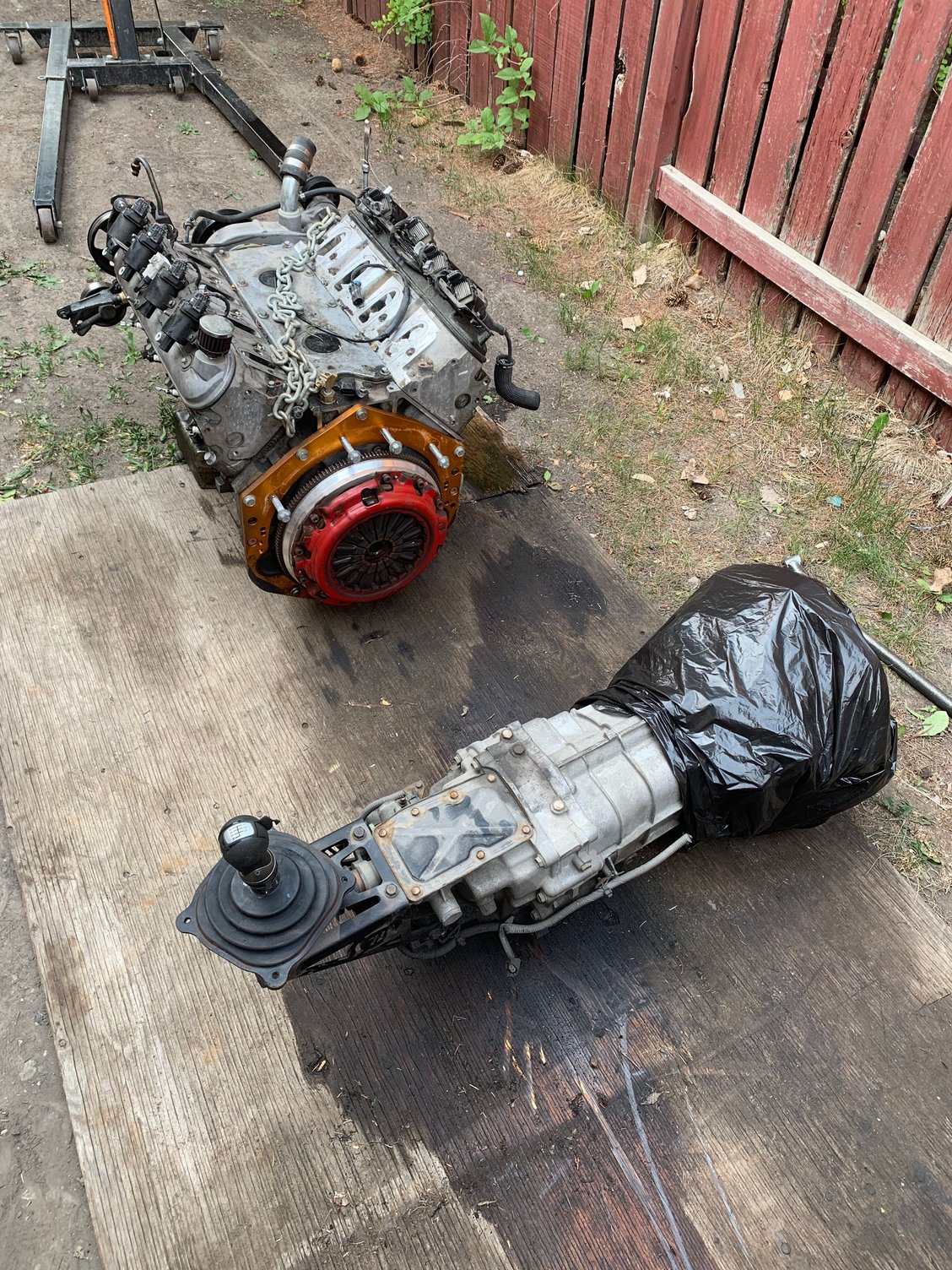

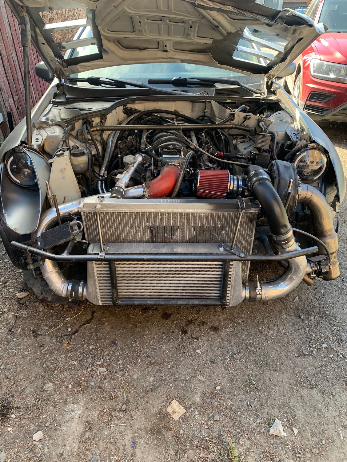

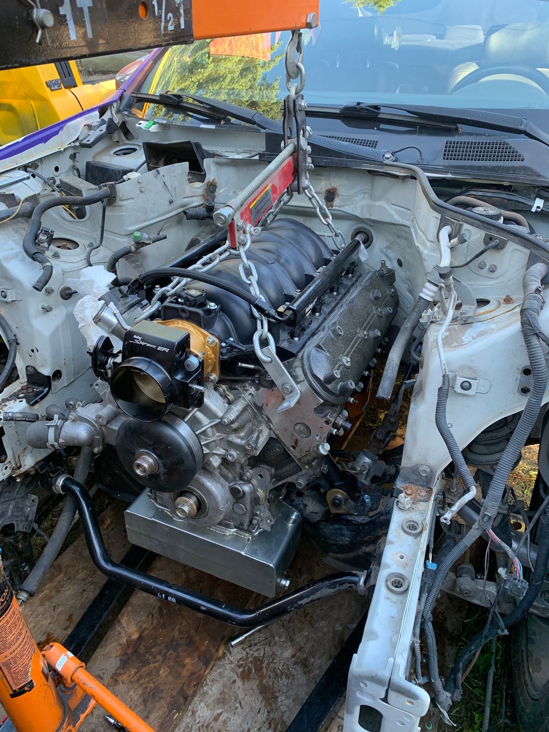

No, I’ve been meaning to make one tho. I had a cammed 5.3 in for a few years. Then I boosted it, drove that for a year until a bearing spun. Then I bought a cheap cheap junkyard 6.0l and threw that in a year or so ago. Not trying to high Jack your thread but here are some pictures
This is how it sits in its current form. 6.0l and a 78/78 turbo
Cammed 5.3 with eBay turbo
