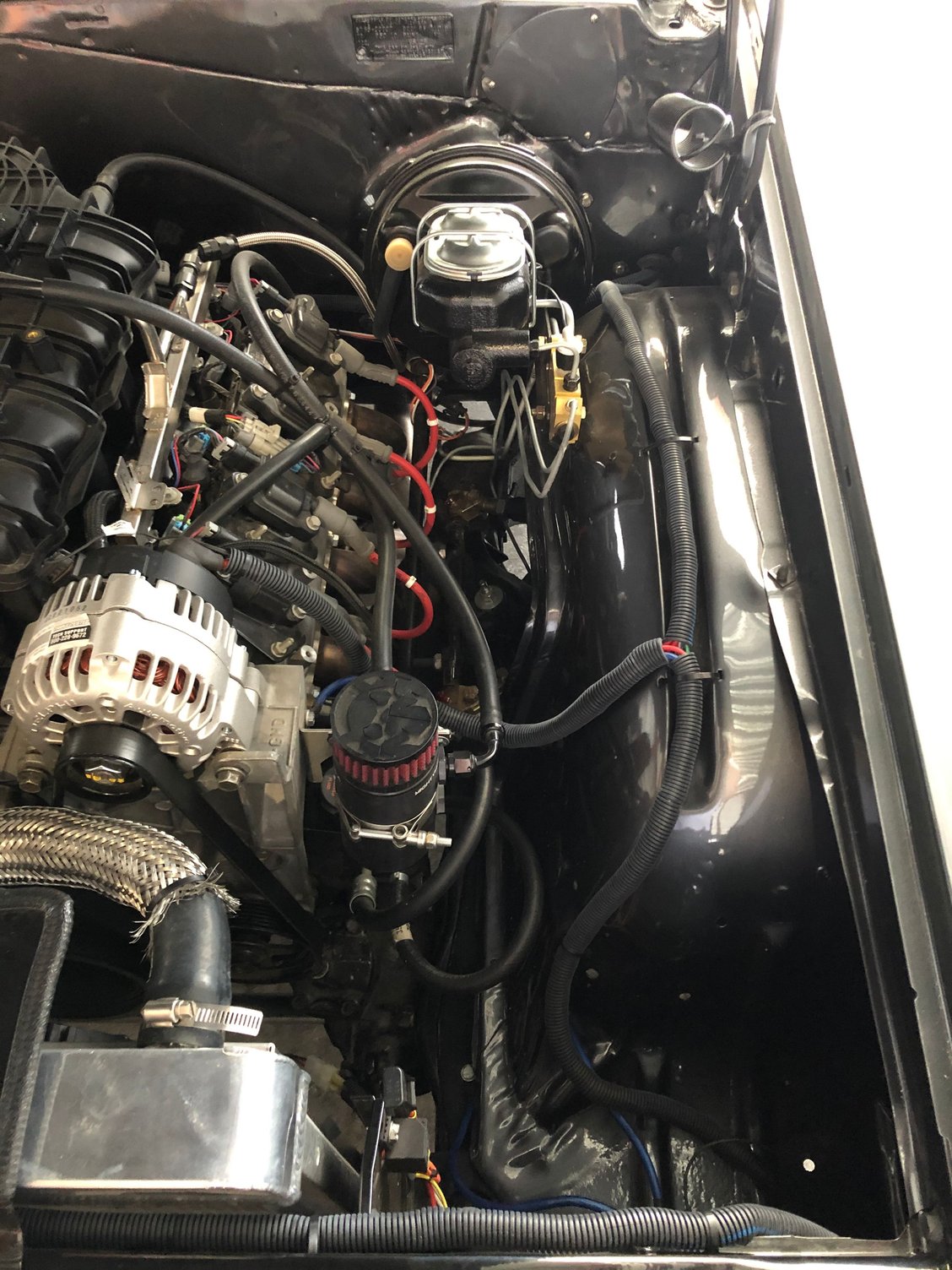

I have a 1965 Cutlass LS Swap (6.0L) with forward bias engine mounts and hooker long tube headers. I have no problems with the brake lines being too close.
