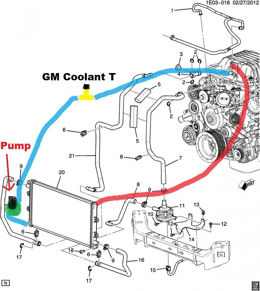

There can be air trapped in the top of the heat exchanger and or the brick and still have water passing through. No the pump won't stop running it will actually rev up really high when an air pocket goes through it. If a big enough slug of air gets to the pump it can actually air lock the system and fluid will stop flowing.
Depending on the setup no matter how well thought out these things can be a PITA to get the air out of. I have even heard of guys having to use a shop vac to suck the air out of their system.
My setup consists of mostly factory GM parts and through dumb luck it works incredibly well and has been easy to bleed. IATs are normally less than 20 above ambient and only climb about 10 to 15 above that during a hard pull and then it comes right back down.
This is a very crude drawing of my layout.
mine is like that aswell but with a icebox before the pump. and i do not have a "T"
