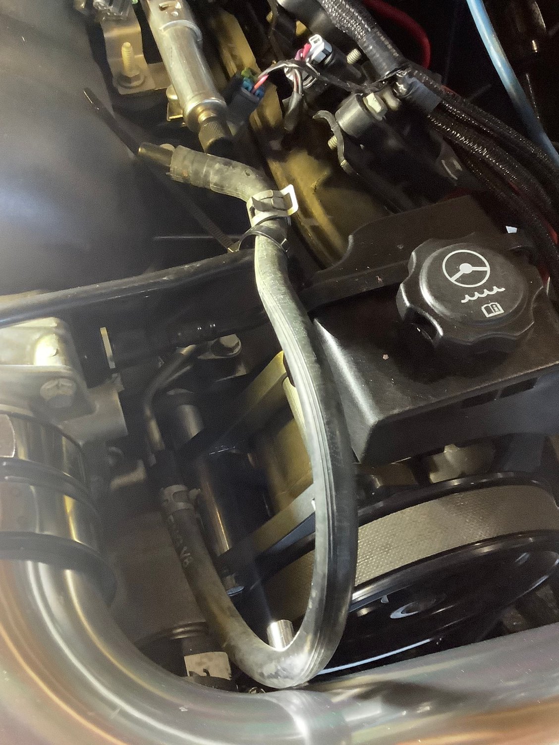

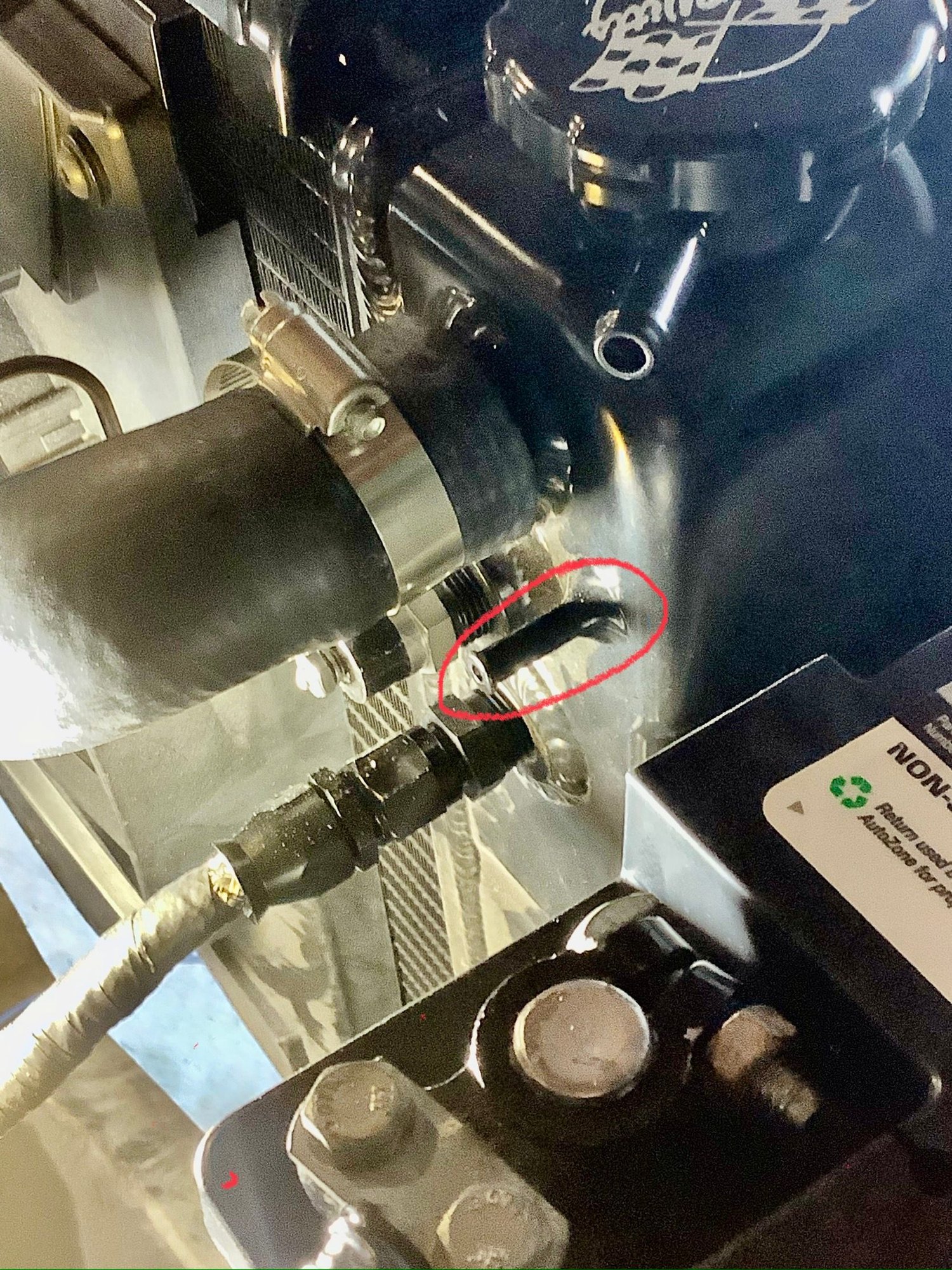

I installed an LS3 motor and Dewitt radiator in C10 truck. From the photos, can someone validate I have circled the correct location for the radiator steam vent connector. Also, the tubing in the second photo is what needs to be run to this connector.

Just give the nipple a little air blast and see if you get either air bubbles or just air in the radiator tank. Of course remove the radiator cap first.
Just a note I would not use those spring type clamps. I use FI type clamps. I think they look better than the typical screw type hose clamps.
I doubt your current hose will reach. Maybe a longer FI rated hose?

Thanks for the information. Air will enter the radiator tank from the nipple so assume that means I’m good to go in using it for the steam vent.
