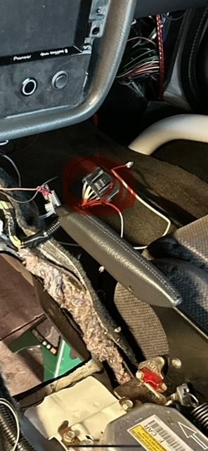

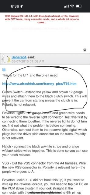

Attached are pictures of what I'm working with, 96 TA original AUTO car now with a LQ4 swapping in T56... I'm I correct with the wiring of this switch?
Thick brown and yellow wires off the auto shifter to the pigtail pictured for the clutch switch? polarity does not matter
Clutch switch
LT1 wiring?
