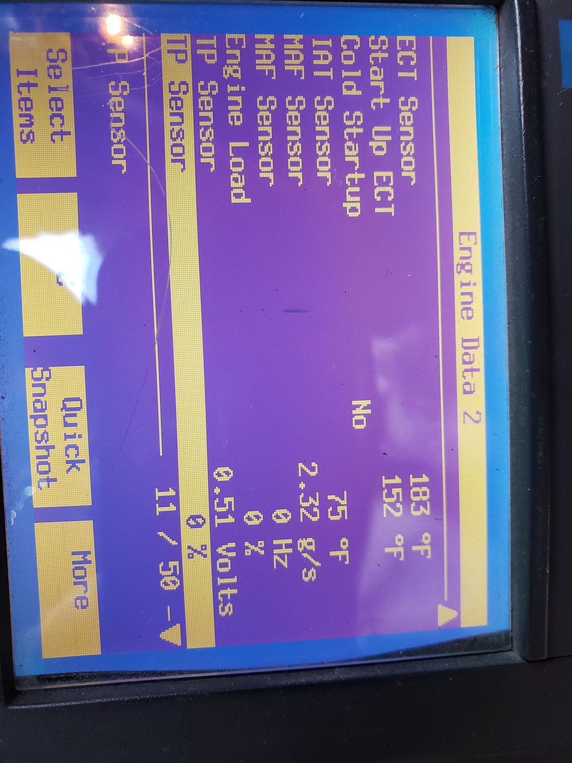

Long story short, I have no idea how long I've had this problem. My car never had a check engine light, but since I changed the gauges, I have one now. The code won't clear, and if you clear it with the engine running, you feel a slight hesitation when its cleared, but instantly comes back. I swapped sensors with another car, same issue. Scanner shows it stuck at 2.32g/s and 0 hertz. I've checked all the wiring and I have 11.75 volts on the pink wire with ignition on, and 5v testing between the ground wire and the reference wire. Also checked the PCV system and everything seems to be good, couldn't find any vacuum leaks. Also, if it was a vacuum leak,, would it set that code that fast? Anyone have any other suggestions?

It reads exactly the same. Also, following the service manual, I jumped the 5v reference wire and the ground and it still didn't change.

Well just to follow up, my tuner checked the tune and the MAF settings were stock. So I hooked up the scanner, started the car and started wiggling wires, and sure enough, the MAF started reading. So looks like I have a little bit of wire repair to do and I should be good to go. Thanks for the help though, its appreciated.
