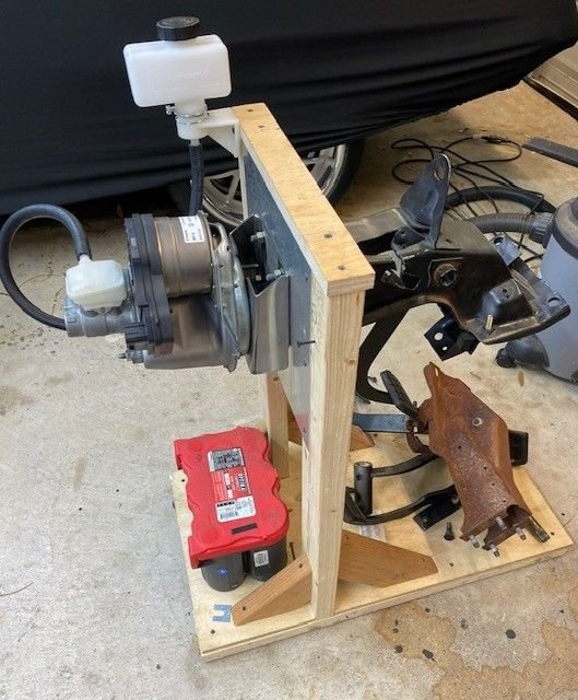

i got my gen2 ibooster from a 2018 honda accord and it came with a remote reservoir
Old Apr 27, 2024 | 02:45 PM
aknovaman's Avatar
Posts: 2,012
Likes: 111
From: Hog Back, KS
My vid shows the factory honda brake master cylinder for reference.

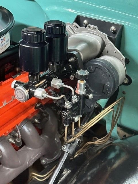

I can help you with that
Old May 17, 2024 | 02:12 PM
JPnTX's Avatar
Joined: Jun 2023
Posts: 28
Likes: 19
From: Houston Texas
If you're retaining the Bosch master cylinder you can use a Wilwood remote setup. On many applications it is a challenge to mount the reservoir high enough on the firewall to keep it above the master cylinder though.
