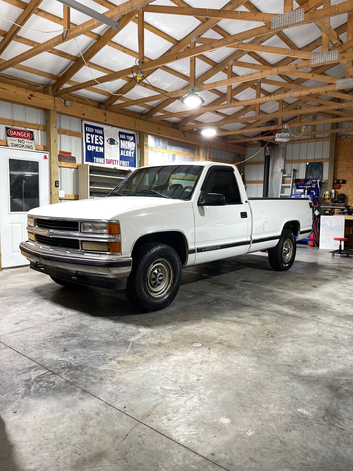

So I have a 6.0 swapped obs with longtubes into 3” exhaust to an x pipe with dynomax bullets. It has a slight clap in the 2500-3500 rpm range. I see where the nbs boys put an equalizer pipe on to make them equal length and get rid of the clap and make it more corvette sounding. My question is does it matter where the location of the equalizer is (before x pipe, after, etc) I know it has to go on the passenger side but placement location is a bit of a mystery for me
