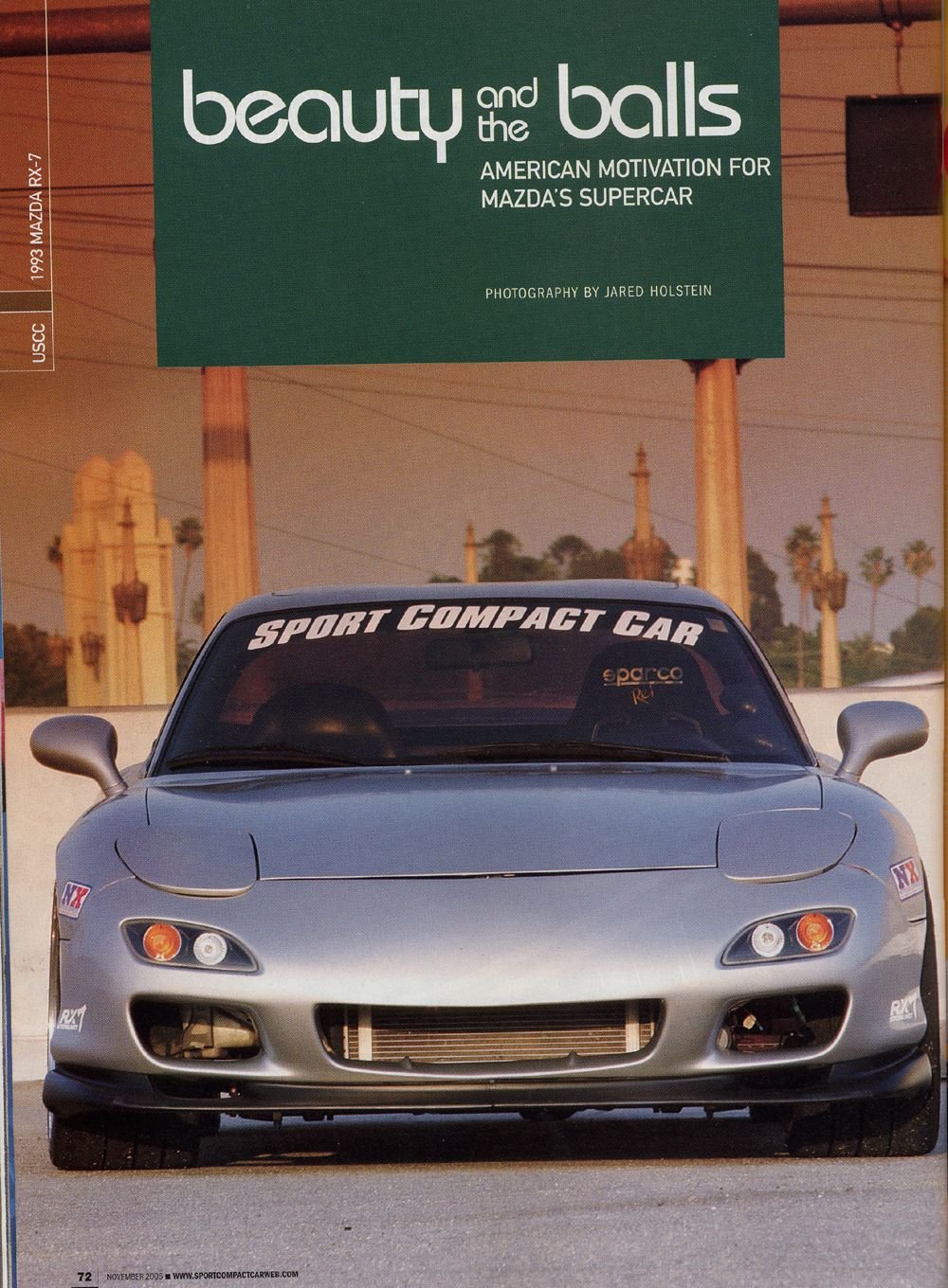

20 years ago I had a stock LS1 shortblock with AFR205 heads, LS6 intake, Ford red top 30# injectors, and 233/239 .600" lift cam around 11:1 compression with 1 7/8" long tube headers and dual 3" out back for a street car/road race setup in my FD RX-7 2800lbs with 285/30/18 square. It was great on the track and I put redline at 7100rpm. It had 20K hard miles on it and never missed a beat plus it was my commuter car. I didn't own a trailer and drove it to every event aside from the one pictured. Ran bottom 11's@128mph in road race trim and an old T56. I would suggest the Improved Racing oil pan baffle and Accusump plus an oil cooler (Improved Racing built in Tstat unit). If you can run the intake piping into the TB over the radiator without any bends you will gain 15-20rwhp over something with multiple 90* bends.
