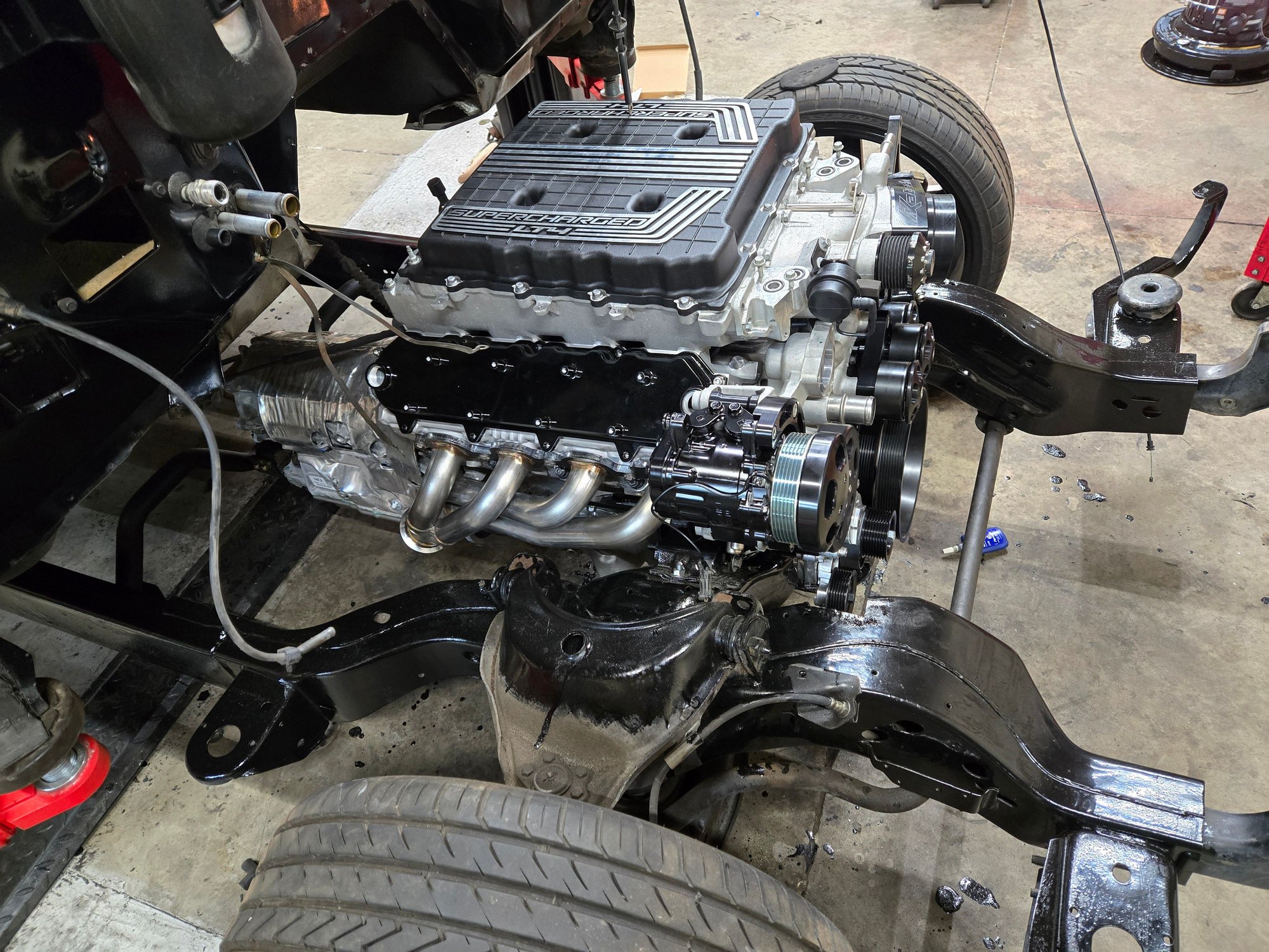

Zl1 drivetrain into an OBS for my buddy
ported S/C and heads with 103mm TB
Btr stage 3 PD cam
All bolted in its new home
Stock manifolds hit frame... bolted these cheap shorties on there fpr now but got some long tubes on order

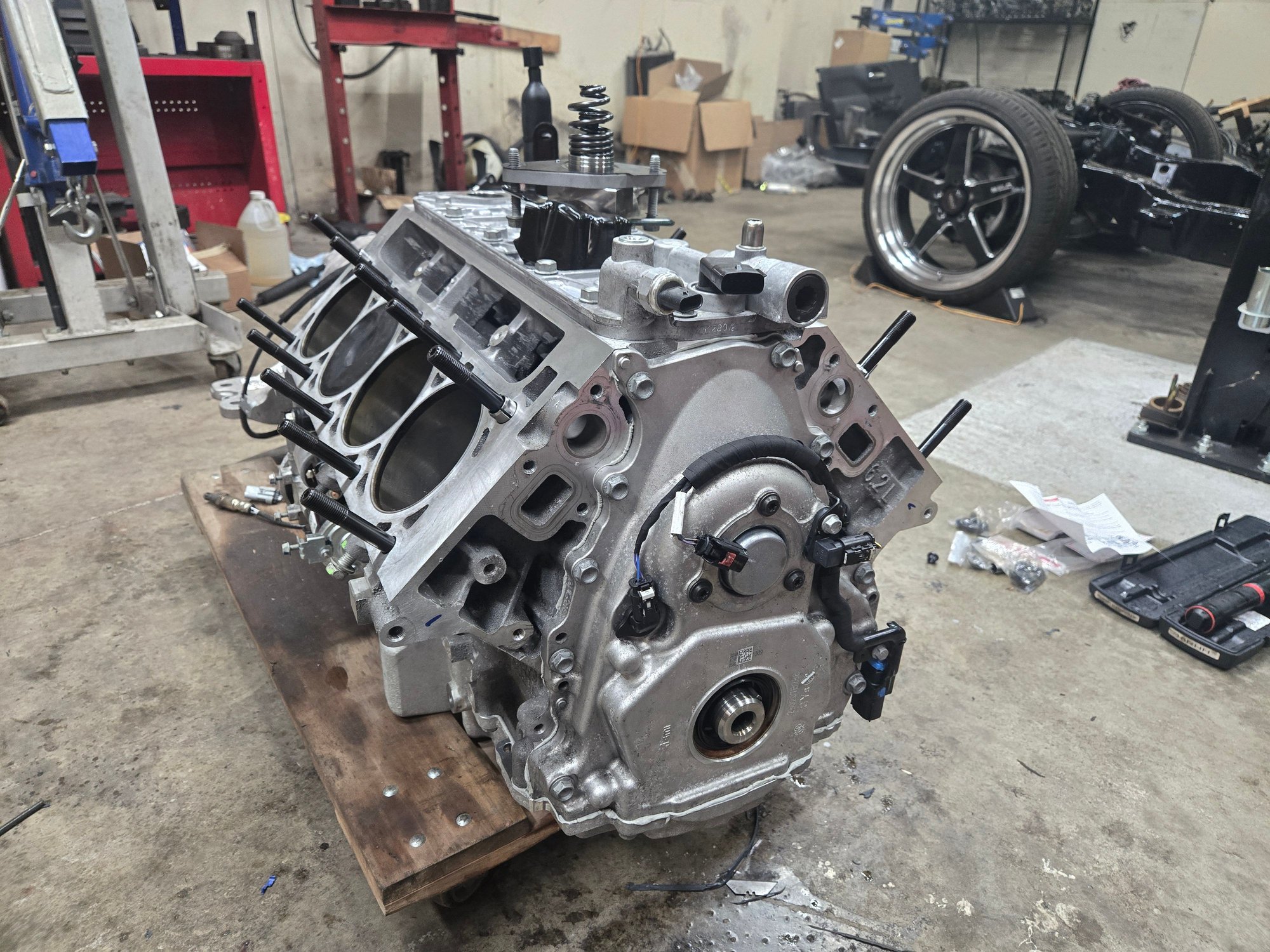

Studded with new tie bar lifters and cam upgrade...also locked out vvt

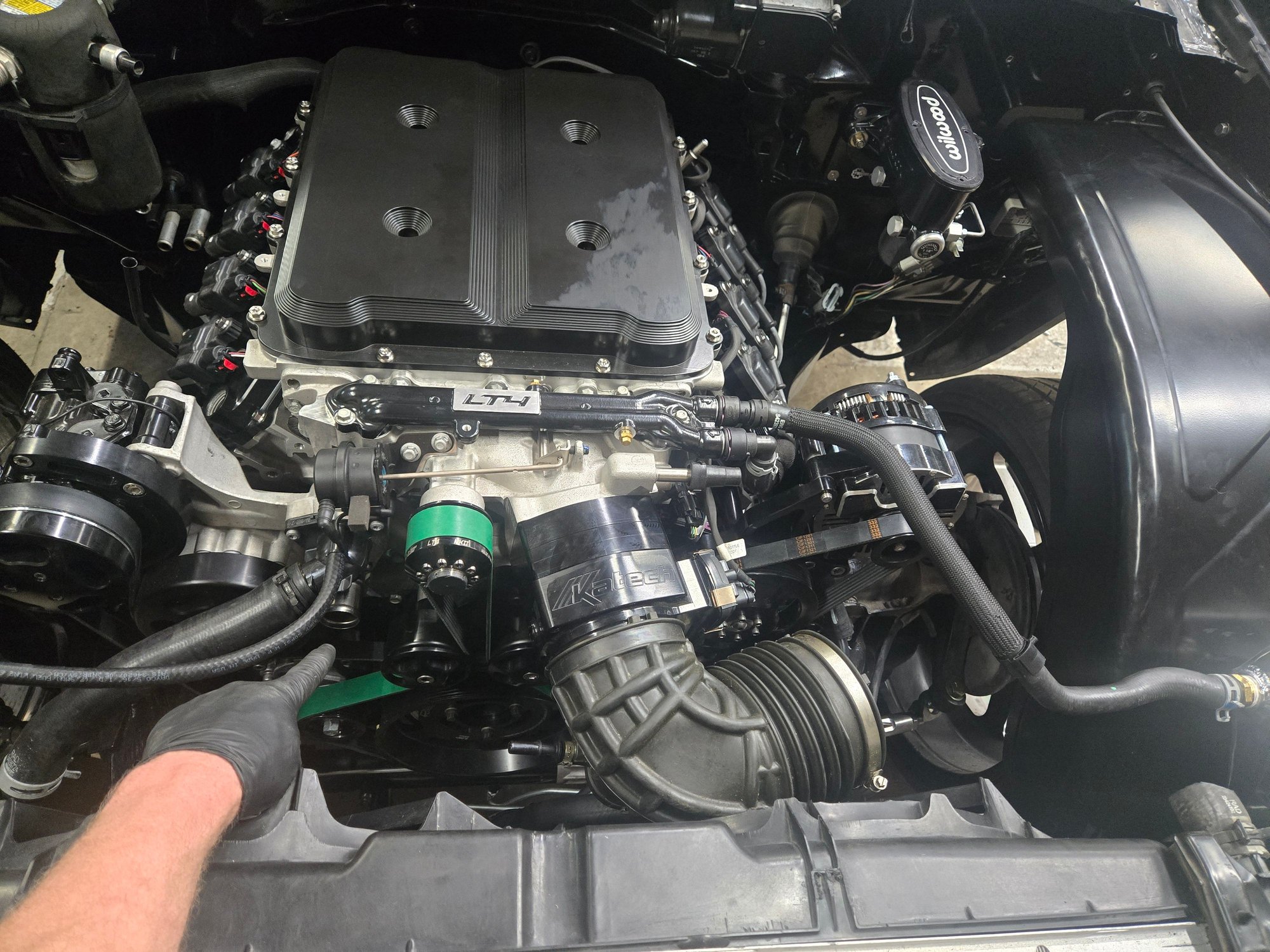

Engine in and all hooked up

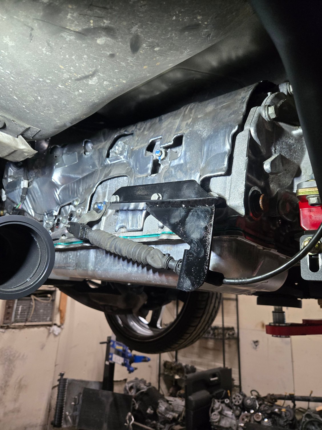

Made shift cable bracket to keep factory shift on 10 speed

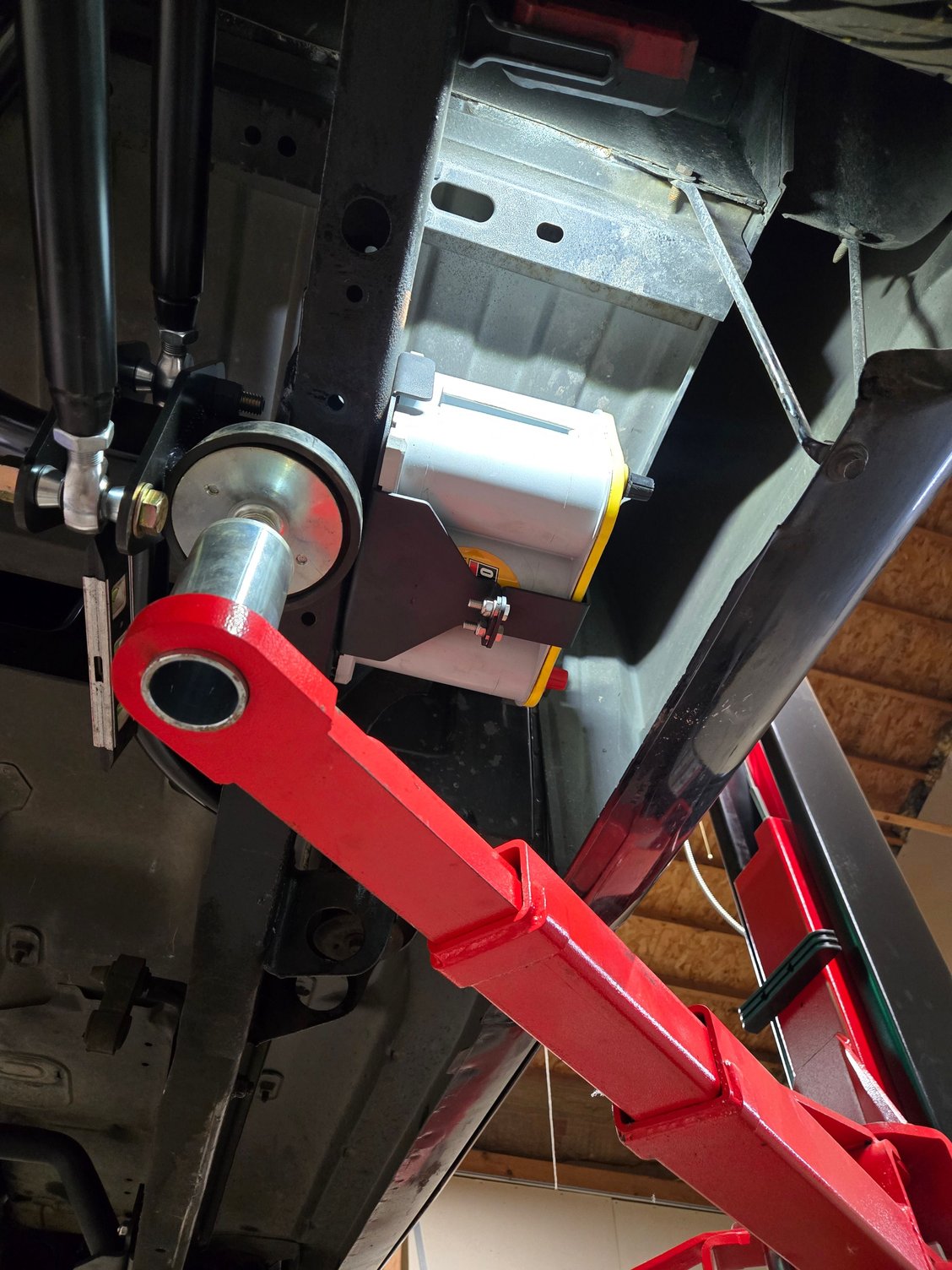

Battery on frame
Battery on frame

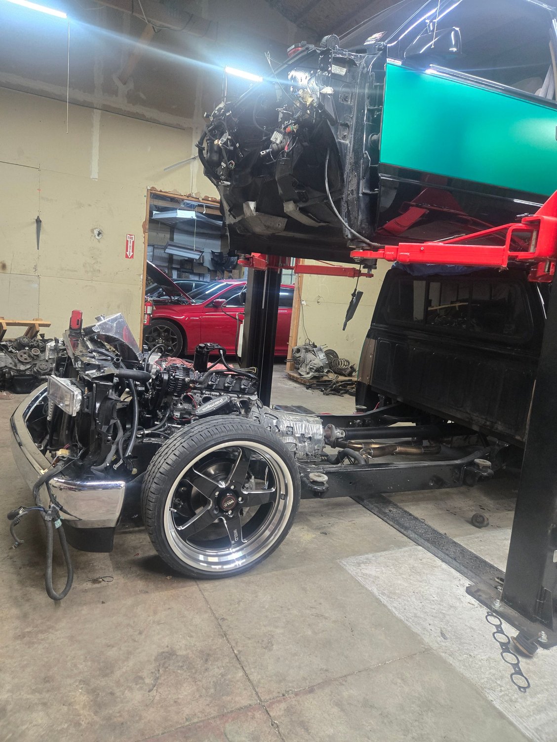

Cab off to get header off...kinda sucks

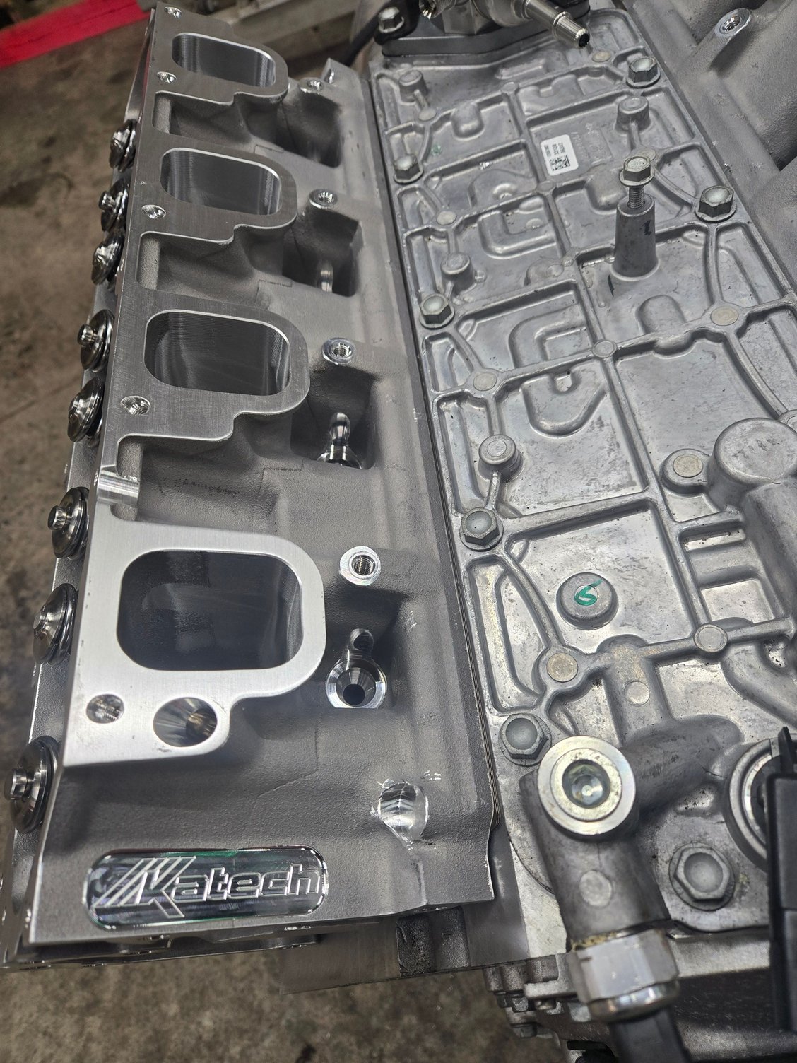

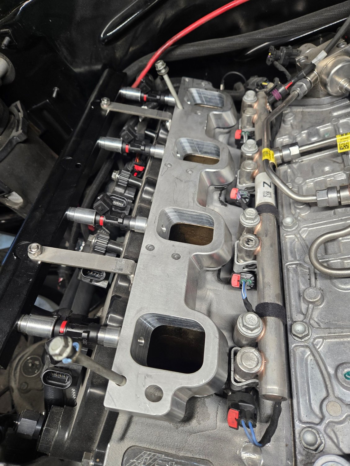

Port plates fitted under blower. Adding weapon x kit with flex sensor
