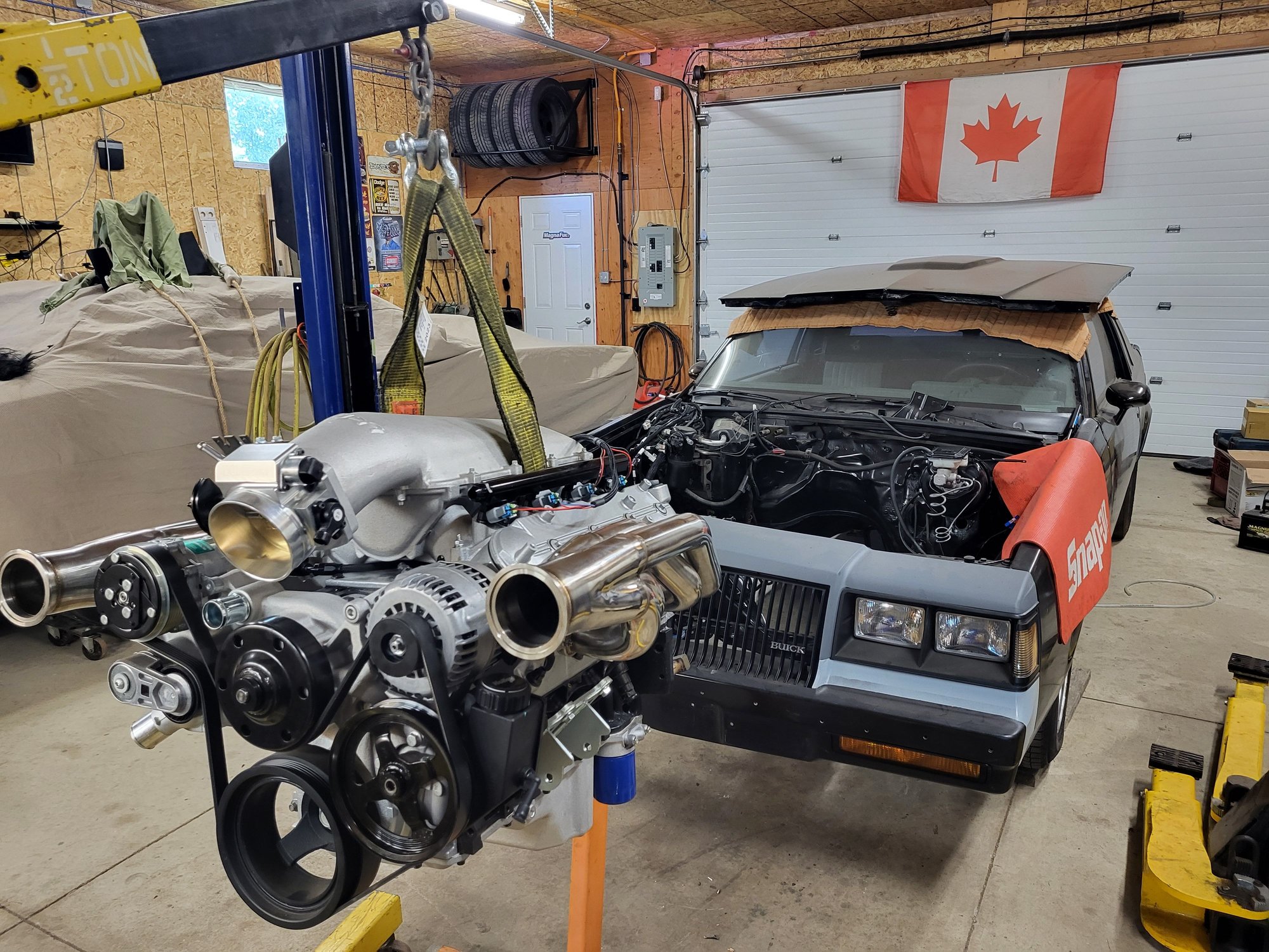

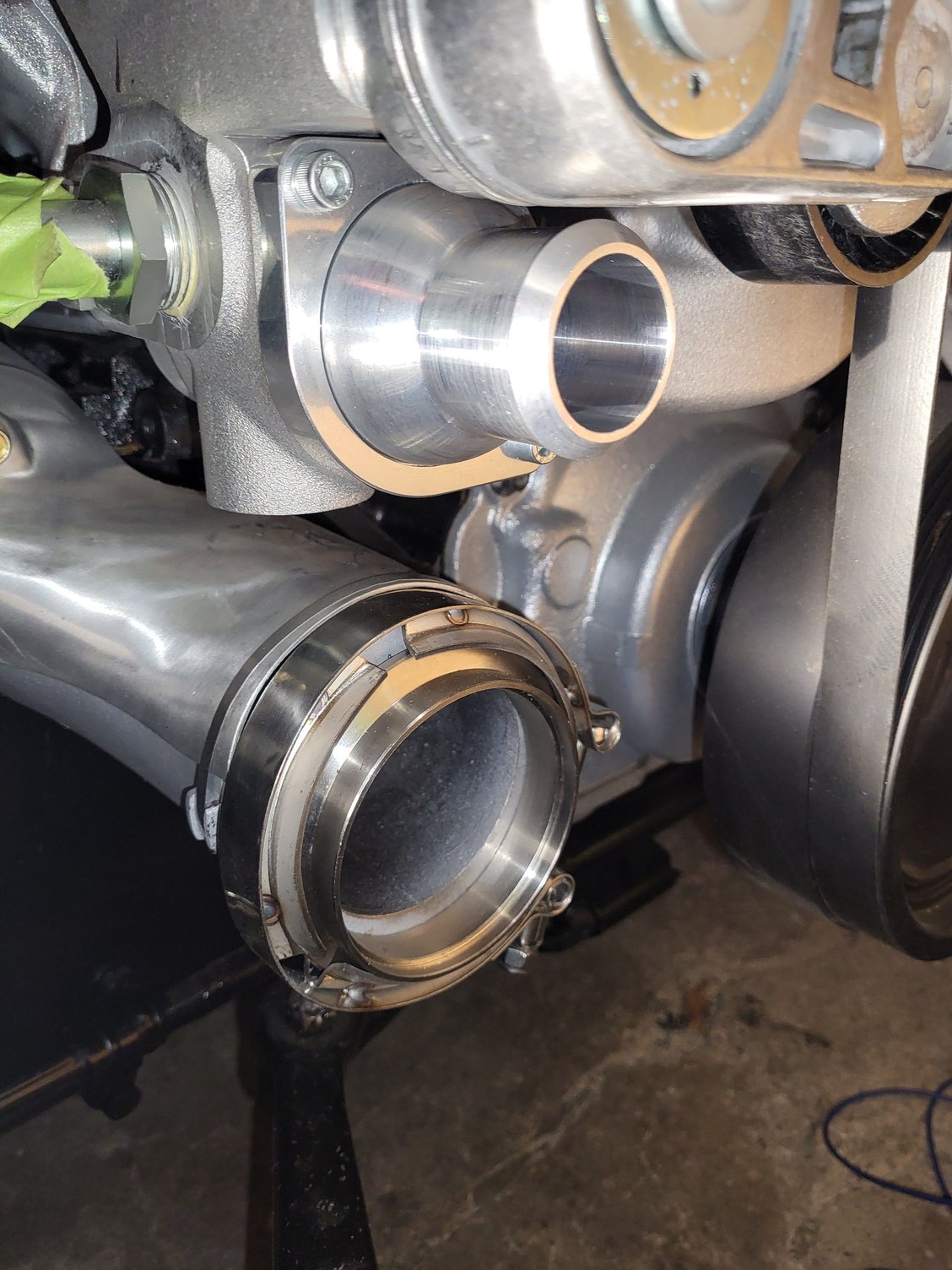

Holley mid mount and Hooker Blackheart turbo manifolds.
The thermostat inlet housing is pointing right at the manifold outlet, hot side.
I think a straight thermostat inlet would be better. An LS housing is smaller, 3" bolt hole, c to c. This is a 3 1/16" c to c. Any ideas what housing this is from or would work here?

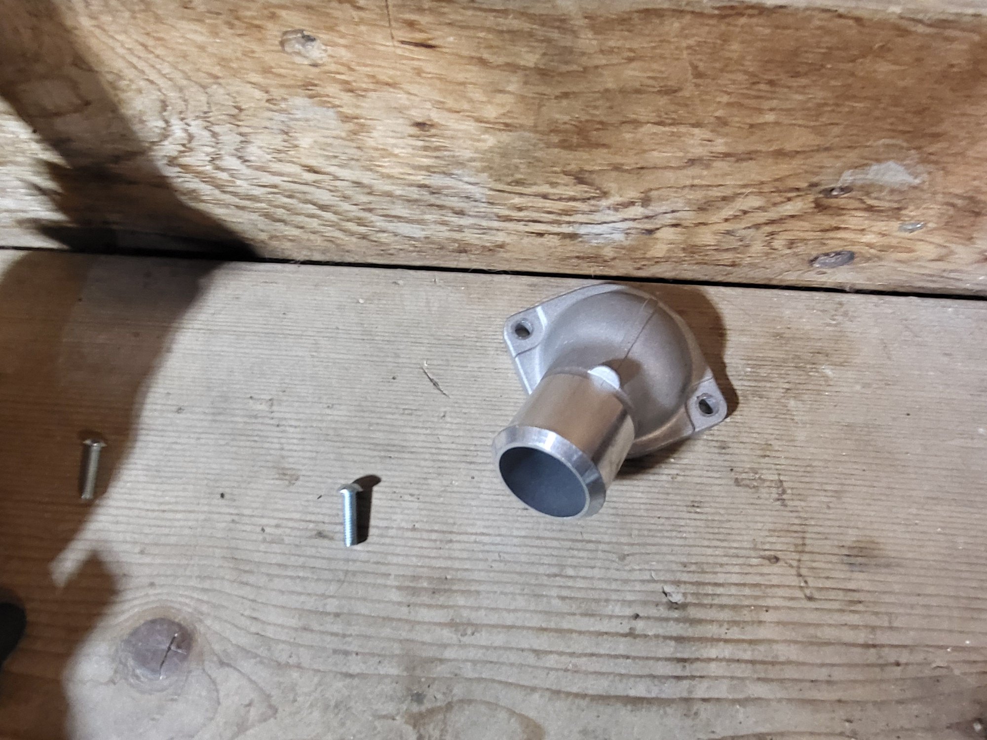

Originally Posted by jetech
That is an LS1 thermostat housing. This will definitely not fit. Already tried one for an LS1 and the bolt pattern is 3.0", I need 3 1/16"
Thanks.

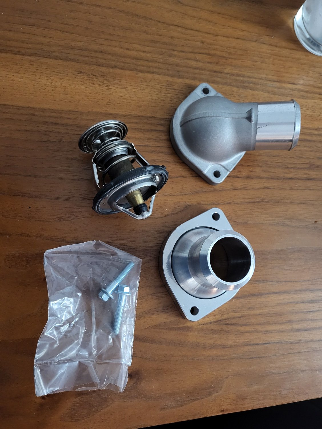

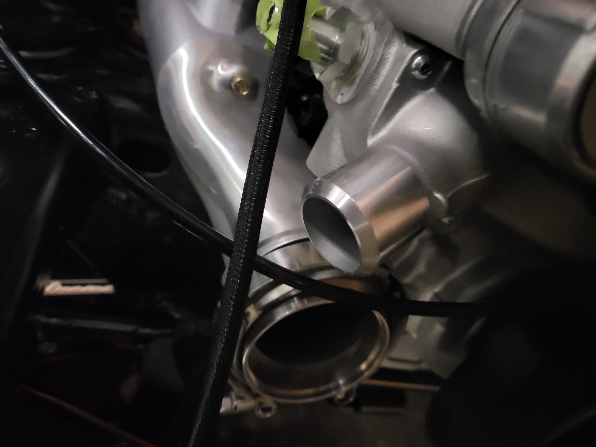

Here is the solution out of the box and ready to go. An LS3 Gen 4 thermostat housing from ICT Billet.
Appreciate the ideas but the holes are actually very small, M8. The thermostat is in a molded rubber gasket and I did not want to slot the holes to make an LS1 fit.
