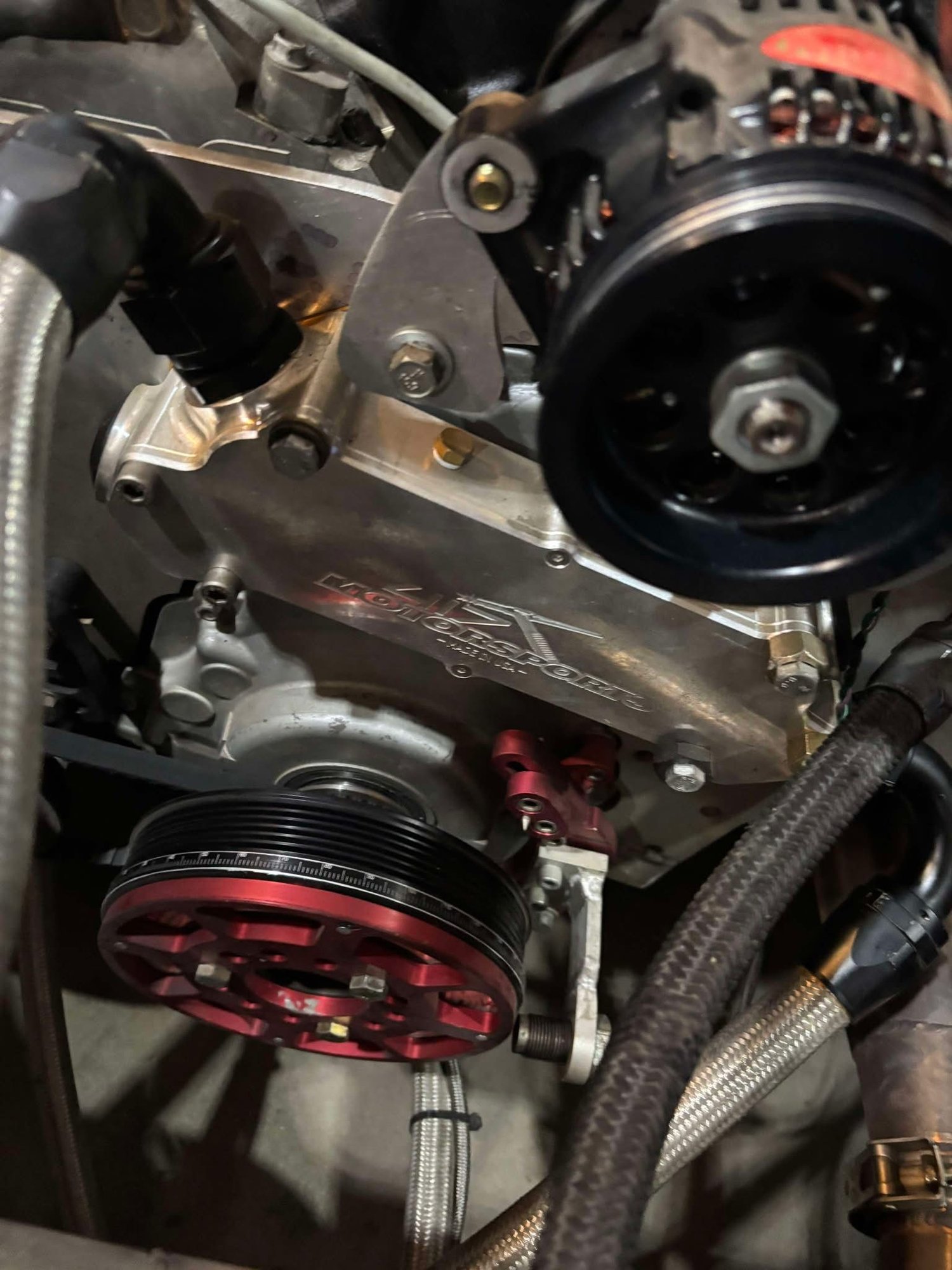

I have a LS 6.0 in my Foxbody. 16V battery and alternator. Here is how the alternator is mounted. 12 o’clock. I found a belt that tensions well with the adjusting bolt. The seller told me the belt come off first pass, so I’d need to figure that out. I had the belt come off on the dyno first pass.
What can I do different? Do I need a tensioner?
Any input would be appreciated.

Pitching belts is "almost" always an alignment issue.

Could be the photo angle but it looks like the alternator needs to come forward. a piece of string in the rear groove of the pulleys will give you a good idea of which way to adjust if you don't have a laser alignment tool.

Those $130 laser alignment tools are worth their weight in gold. Especially if you're throwing $70+ belts, but that doesn't look quite like your case, but still.

I would use a straight edge before a laser, but lasers have their place.
