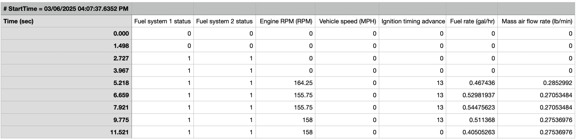

OK. I have the logged data. I'm not sure what I should be looking for, so I'm just going to share the image and hope you all can help? Values seem consistent, which seems good to me, but something must be off. Still showing a P1125 but no other codes currently.
Ideas? Help!
