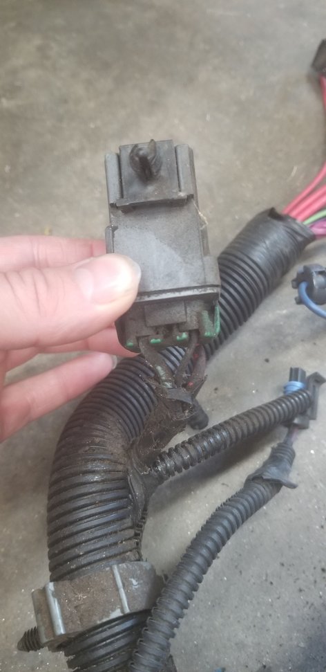

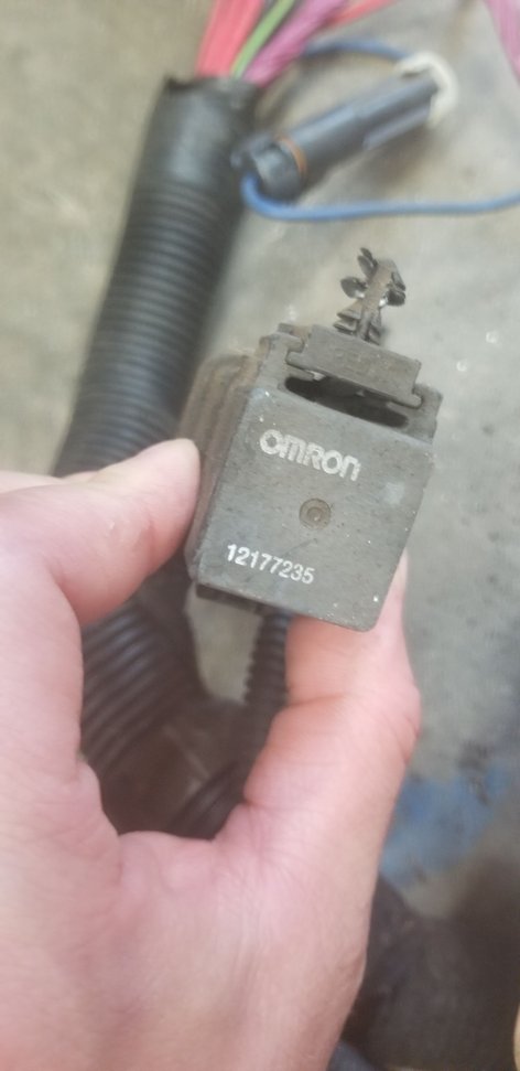

Does anyone have a manufacturer's part number for the relay below. Racetronix puts their own part number on it so I'm not able to find another one from a regular supplier.

HELLA H41410081
Look up a blower fan relay for a 2002 S10

just posted in your other thread, but it looks like this one

thats a hella sealed VF4 relay. Hella part number 87411B its about $3
the socket is hella sealed relay socket HL87173

If you want just a standard run-of-the-mill non-sealed generic VF4 ice-cube relay, you can get TE brand for about $1.

For future reference,The issue ended up being a bad connection in the fuel pump relay. The relay I had used, which was in the Racetronix kit, had a bad connection and burned, making intermittent connection.
I ended up going with the Waytek Relay Part# 75605 which is a Hella brand Part#7794307 (previously named Bosh), the connector Part# 75612, and the associated metri-pack connectors Part# 31085 and 32037.
