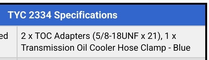

Likes: 36

I recently used this kit and it worked great on a TBSS. https://amzn.to/43swZEi
To hook up to the stock quick connects at the radiator I used two of these fittings from ICT billet.
https://amzn.to/4dPV9vU
