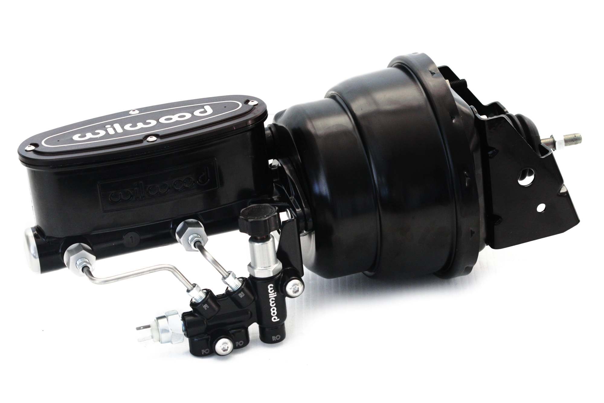

I am currently prepping my firewall on my 1966 Chevy II and would like to run a booster on my brakes. I own an L33 engine I intend to put in. I see many people running master cylinders with no boosters on LS engines. Is this because a booster will push the master cylinder too far forward and into the cylinder head? Would something like this work for me? I have Willwood disc brakes on all 4 wheels.

I don't see using that setup being an issue. 4th Gen Fbody cars have vacuum brake boosters and there's more room on the driver side to reach all the spark plugs than the passenger side.

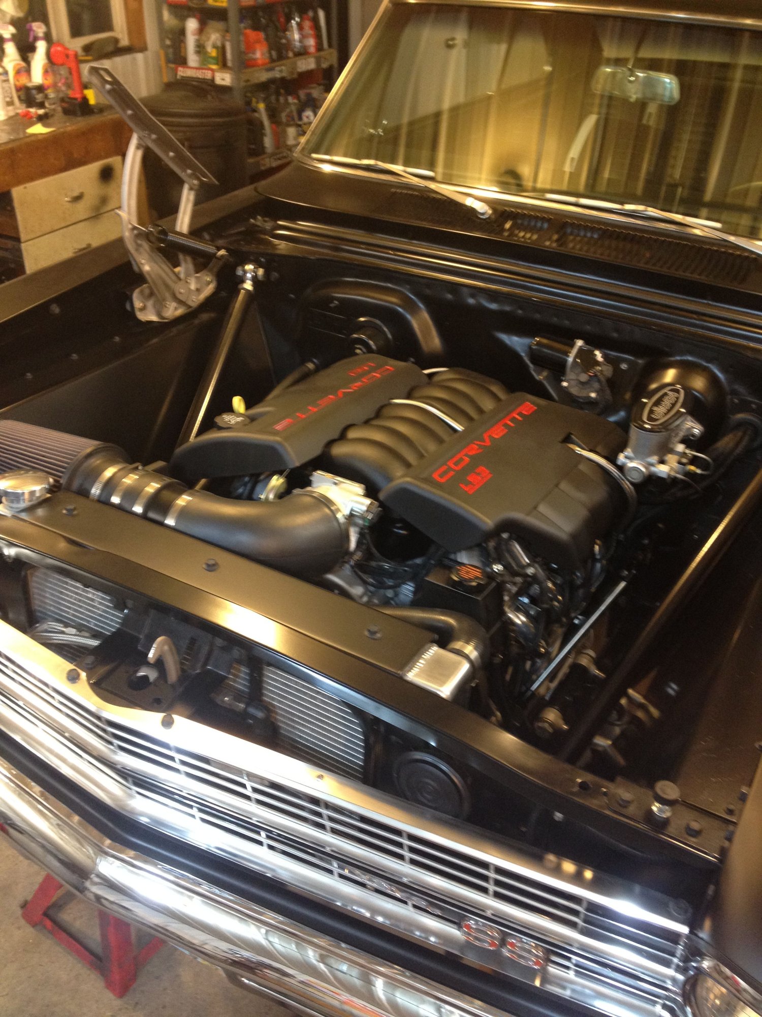

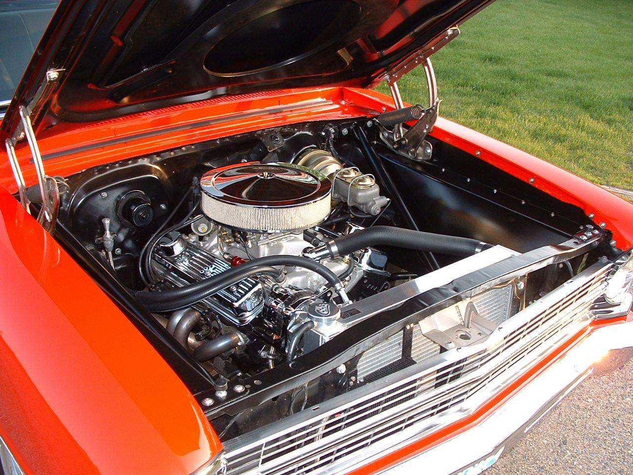

I've done two 67 Nova's. One with a SBC small cam and one with LS6
with a medium size cam.. Both had C5 brakes all around.
On the red 67 I used a booster with a C5 master.
The black 67 I used a Wilwood manual master.
Wilwood prop valves on both.
Both worked well.
The only real difference is that the manual brakes required a bit more pedal pressure
