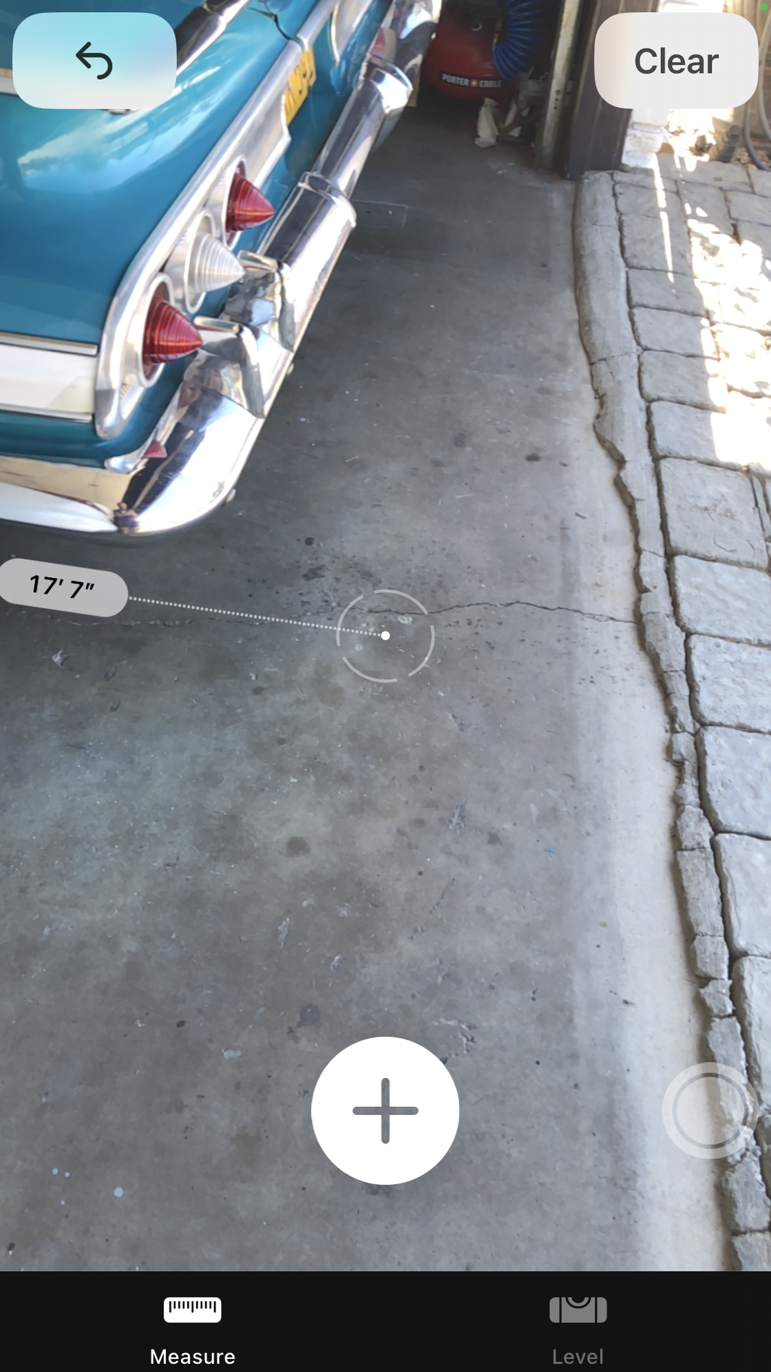

I would park the car in front of the garage, use a powered winch or set of pulleys and your truck to pull it into the garage to pull the motor/trans, then release the winch to roll it onto the pavers in the driveway to close the garage. rinse and repeat until the project is done. that way you shouldn't get a ticket unless your HOA has issues.
that way its parked on your property, and the jacks and engine hoist wont bust up your pavers or sink into the asphalt on your street when you actually do the work.
your driveway pavers will keep engine hoists or jacks from rolling properly when loaded, so dont even consider trying that.

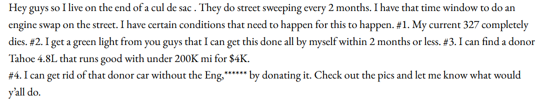

Doing the swap on the street? Not a good idea IMO. Almost impossible not to get oil/power steering fluid/antifrezze out the car without putting some of it on the asphalt or your cobble stones. Neighbors and the city will not like you. I would never be ok with a car on jack stands on a angled drive way.
Antifrezze will kill your dog/cat or neighbors dog/cat and any little critters that comes by.
Also jack stands can sink into warm/hot asphalt and kill you.
If this is your first LS swap I would buy a ECM/engine harness from one of the vendors on this site.
Don't know if it works for you but rent a indoor storage space that fits your car size for the length of your build time? Big enough to store parts and tools?

no you still cant work on it in the street, so plan on working on the motor in your garage, and doing teh swap with the car hanging out the garage.

and your car fits in the garage, so no problem there. you will need to roll it back when you have the engine hoist on it, and roll it back in to close the door

I swapped/restored a 64 Impala. Can your swap be done in the street? Sure. It is going to suck, and you will be beholden to daylight and weather conditions. If you catch a week of rain? You basically just lost a week of work. Working in the dark with flashlights is never fun. You're essentially setting yourself up for a an endeavor that is going to be more frustrating than fun due to the conditions in which you are trying to accomplish your goal.
I can tell you from the start that you need an F-Body oil pan. The truck oil pan will not fit, and you are still probably going to have to notch the crossmember. For manifolds, you will need LS3 Camaro manifolds if you aren't doing headers, and they will need moderate clearancing. You aren't using the truck's driveshaft without modifying the driveshaft tunnel in the frame. Inland Empire does make two-piece shafts for the X-frame cars.
