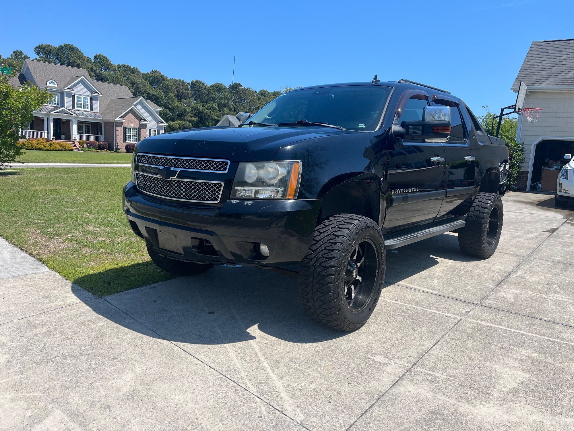

your 07 is a nice looking rig, you've kept it well.

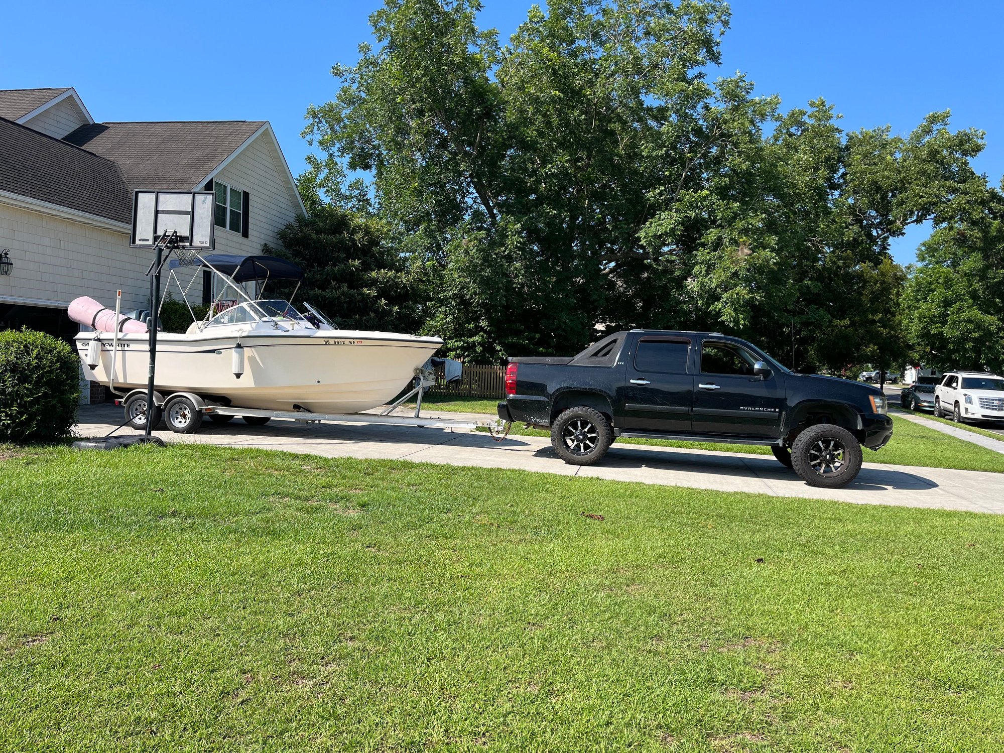

The truck is rust free, and has the lift which keeps the bumper and everything out of the water when I launch on our not steep neighborhood ramp in salt water. I have to go in up to the rim to get the boat off, and waves would touch a normal truck bumper. Downside is the guy before me tried to run 35s with a smaller lift and he beat the crap out of the inner fenders to clear and rough cut the bumper, then eventually he put the right lift on it. The 5.3 4l60 does fine as a DD and towing my 5500lb boat, but I’m looking at a 9-10000 lb boat and need more gears and power, and need to keep true 4x4 for low tide slippery ramps. From what I’m reading I think the swap will work, but the BCM and making sure the transfer case work are my variables I havnt figured out.
