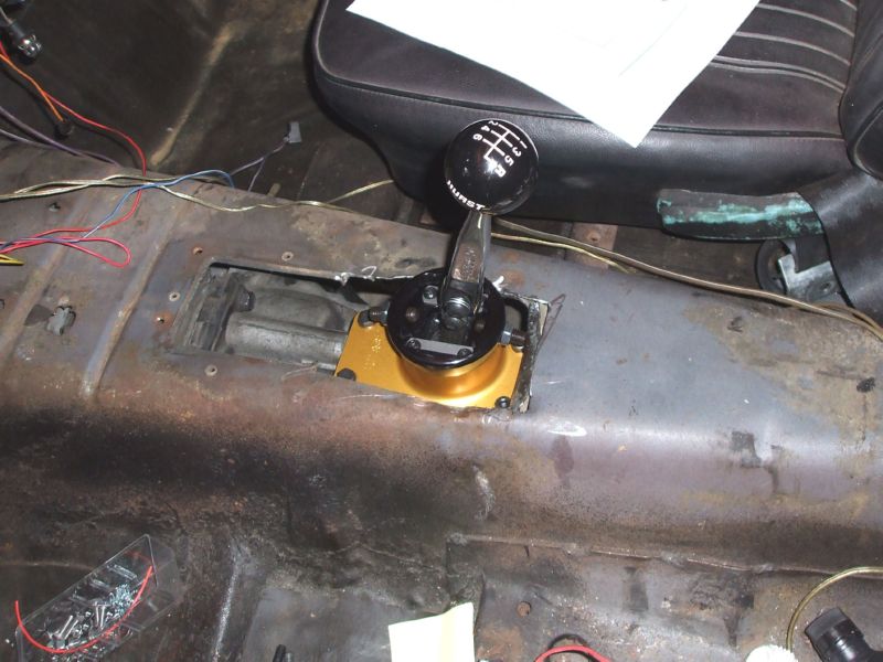

I'm using a Hurst Billet/Plus with the straight chrome stick. The T56 is so far back that I don't need any curve. All Billet/Plus and Comp/Plus should accept the same stick--Summit shows 27 different sticks under the category "hurst shifter sticks".
In 2nd gear:
In 1st gear:
