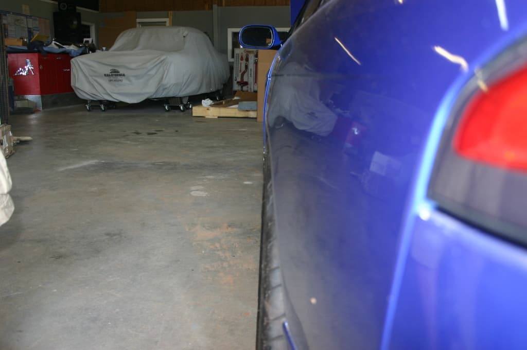

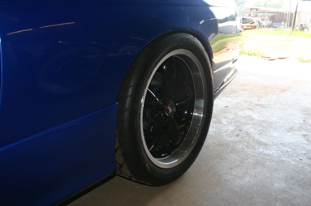

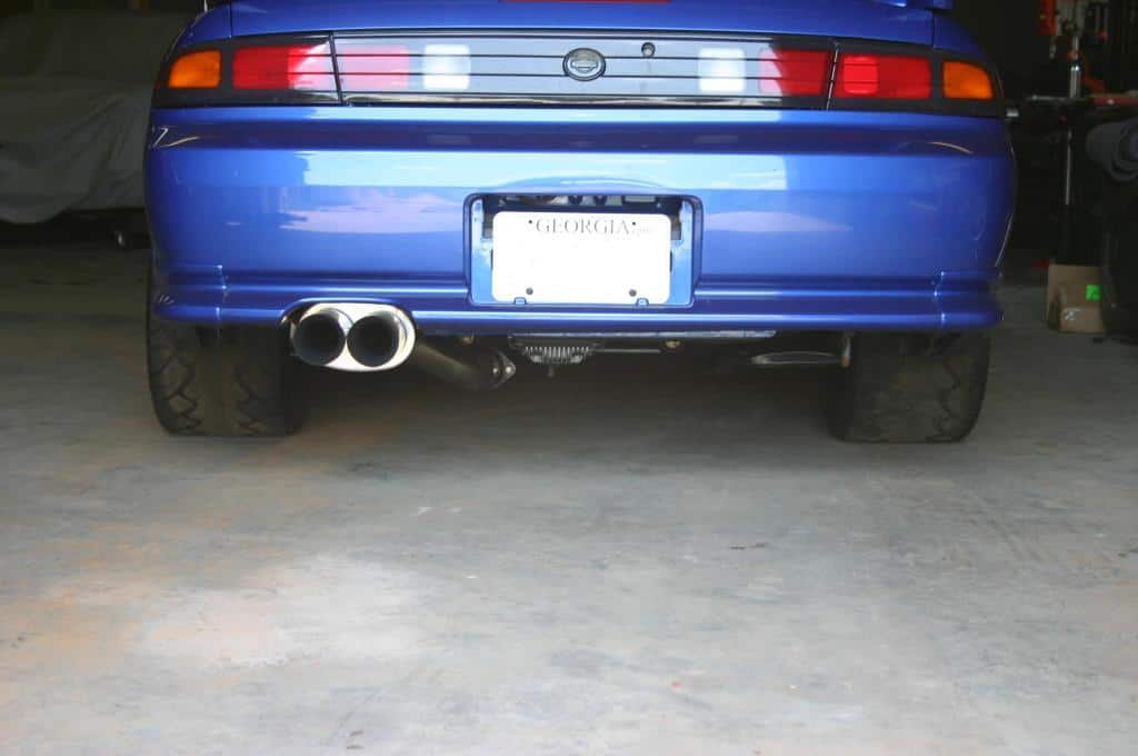

I know its an old thread but I can add a little input on your question. I have put 295 35 18 BFG drag radials on 18x10 wheels with +42mm offset with only the lip rolled on the stock quarters on my 97 240SX.
