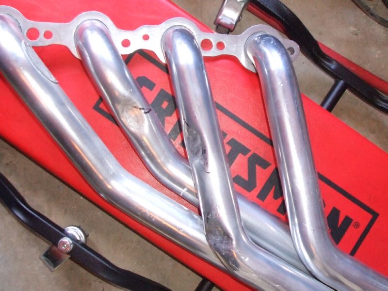

I'm running the Hookers with ATS mounts. I had to make 3 dings to clear the steering box and pitman arm.

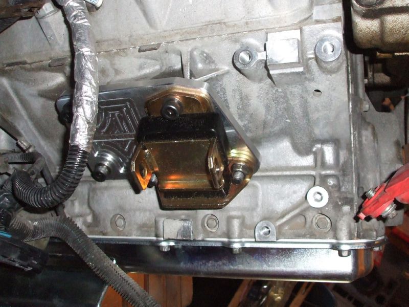

im not sure what the diff is with the ats mounts but i have the stainless works longtubes and they clear fine. but i have the one form the car shop in olly's sticky http://carshop.carshopinc.com/produ..._id/74328/LS1GM . and im not running a power box. the maunual may be smaller crwating more clearance. if this helps

I ran the hooker long tubes with my Ls2 and s&p mounts and only had to put
1 small ding in the header where the pitman arm goes onto the bottom
of the gearbox. You can't even see the ding unless your under the car.
When I say ding I mean the size of a nickel. Good Luck

i dont mean to sound dumb , but here goes.... are those mounts suppossed to be upside down or is tjere a chance you can swap sides with the ats parts so the mounts install right side up and that would raise the motor up and possibly clear the headers. no?
this is the pass side of mine
you see how it slopes toward the back as it goes down on the right side and yours slopes toward the front it looks like.

The ATS plates intentionally put the mount upside down to lower the engine. You can't swap sides (turn them into S&P mounts) without a little cutting and/or grinding. Also with some frame stands, you may have to trim the lips on one of the energy suspension mounts to get them to drop down all the day. http://www.blown.net/ls1swap/DSCF3110.html - look for the red & yellow paint marks on the mount to see where I cut.
