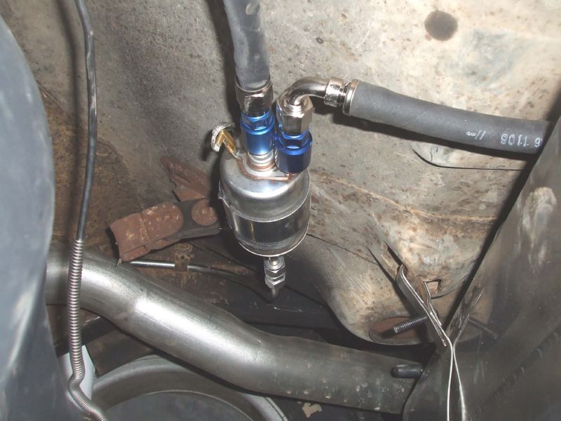

Corvette FPR is a life saver!
FPR on rail...
In relation to suspension...
Top of rock valley tank...

Ok so thats a stock filter assembly that has two lines out one side for regulation and the one that feeds to the rails? How are you connecting the steel braided line to the assembly?

On the inlet and return, I'm using the Russell quick-connect to AN adapters. They don't fit very vell, btw. Some people use compression fittings. On the outlet, I used a Dorman tube and a compression union to connect to a shortened/bent reproduction 3/8" stainless hard line. I think the Russell and Dorman part #'s are in one of the stickies.
