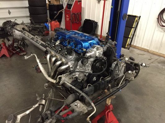

Front and rear cradles have to come out. Here is a pic of mine for visual reference. Its not bad, Corey and I had this one out in about 3hrs like this.
