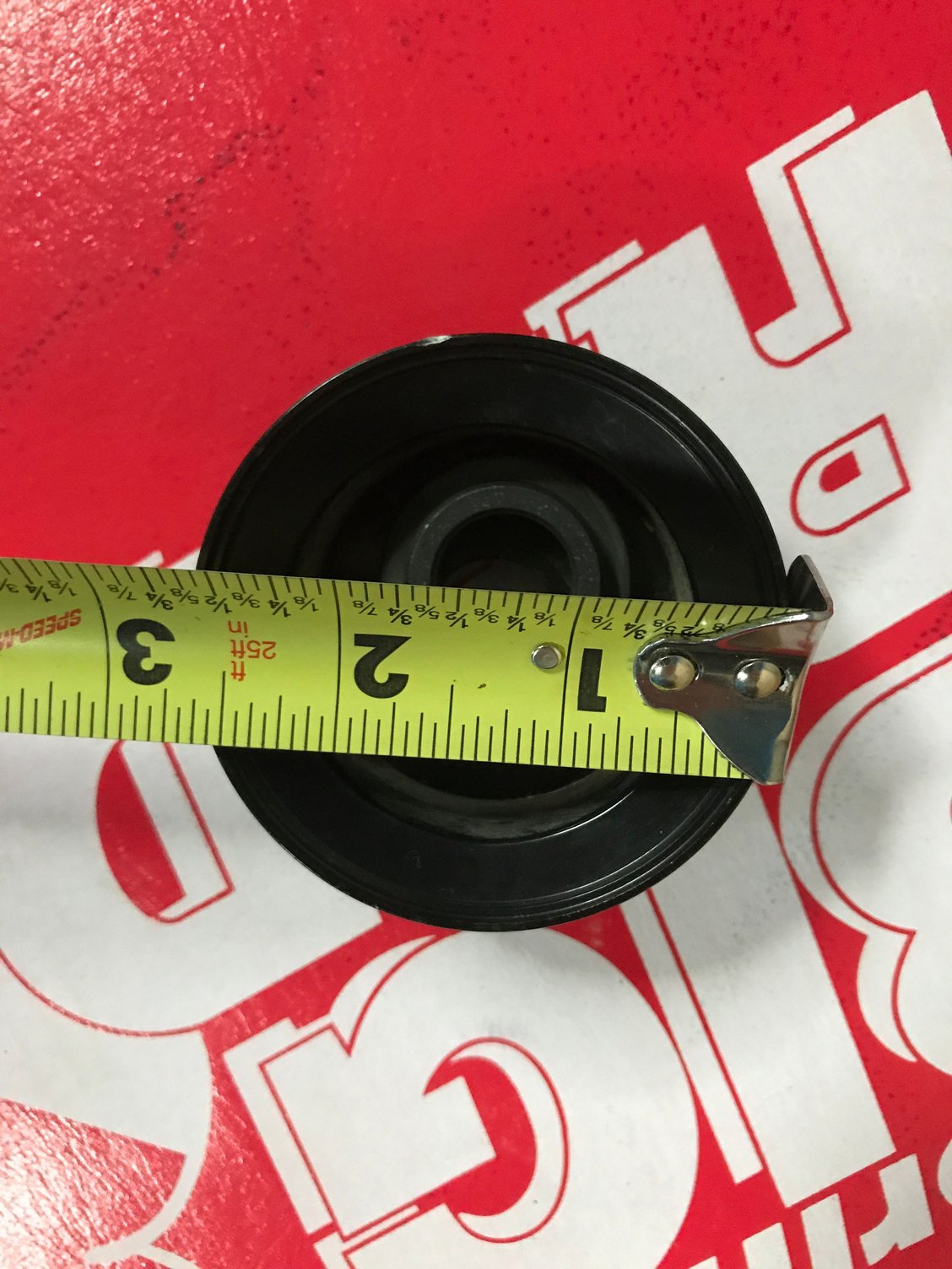

The belt on this pulley (stock) is 77.5"
Old Apr 18, 2017 | 07:59 PM
prostreet513's Avatar
Joined: Nov 2016
Posts: 23
Here is the OverDrive Pulley
