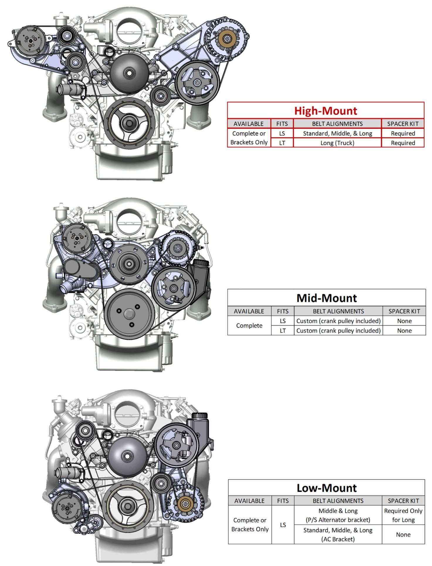

- What’s the best accessory brackets to purchase. Both 824 and Muscle Rods sell their versions of brackets, but I’ve seen newer support for the Holley brackets. I think I’d like to purchase the Holley brackets but I don’t know which mounting location (see below picture) to purchase; high, middle, or,low
