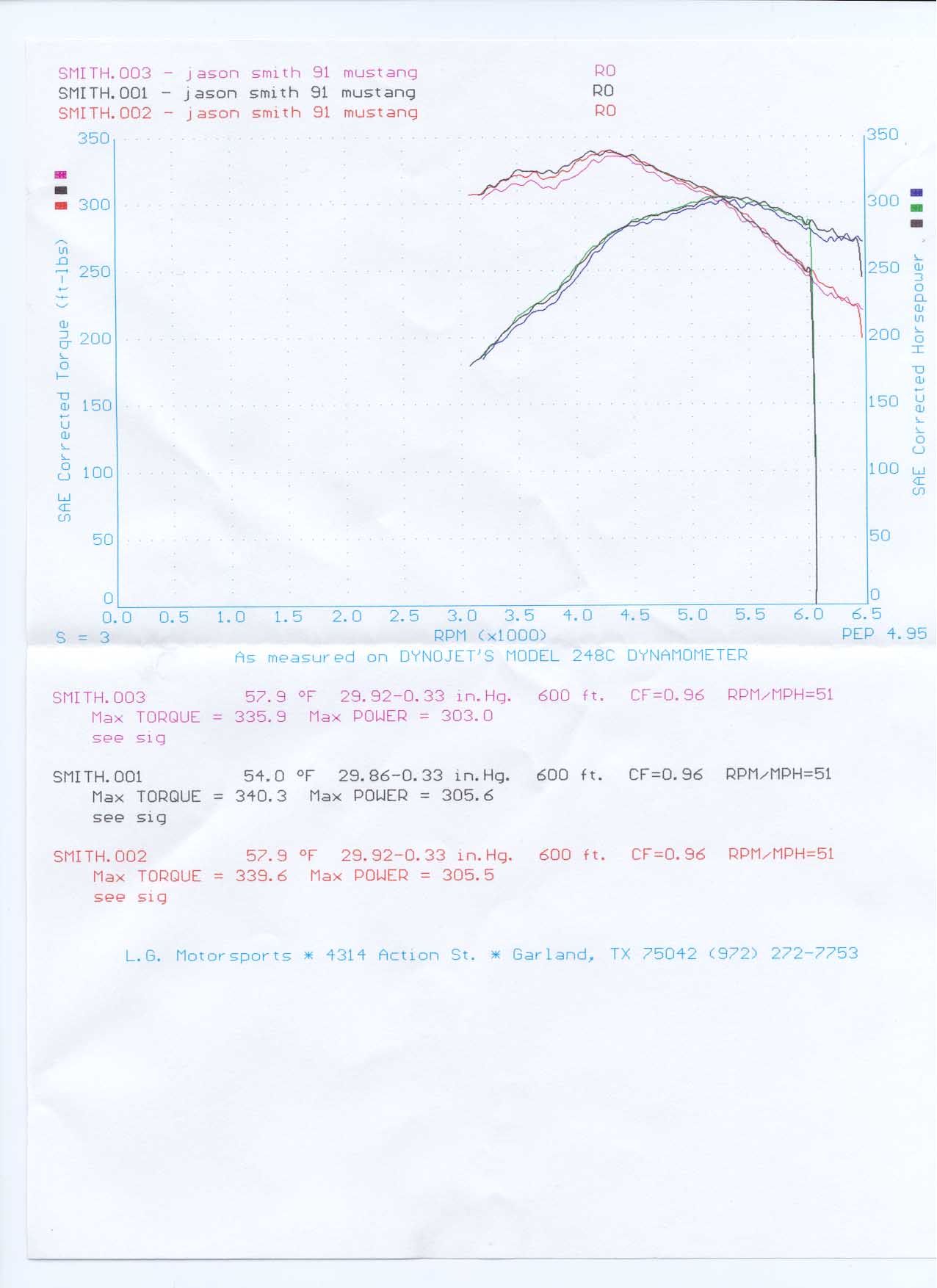

I have at 5.0 with heads, cam, intake...basically all the mods minus a power-adder on a stock 302 block and 3.73s.
Here is dyno sheet from LG.

I can't see your dyno chart, but if I remember correctly, your mods are similar to mine. I'm guessing peak power is around 5,500 rpm, so I'd try playing with different shift points between 5,500-5,800rpm.

This is this a link to the graph.
http://sally.cz28.com/images/sally.jpg
