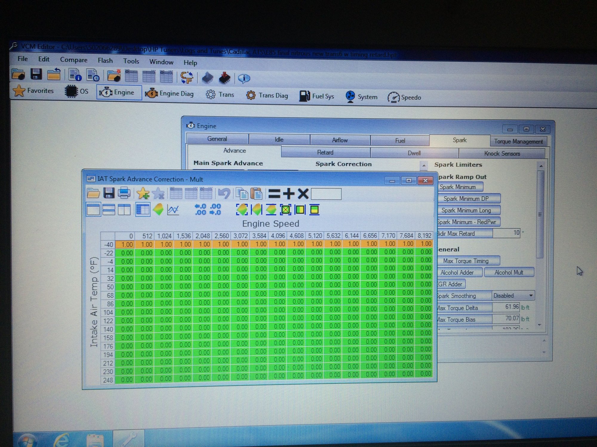

Hey guys I'm new to the forum. I found an old post about building a timing retard box with relays using the IAT circuit. Has anyone done this and had success? I built the box and installed it. The data log shows IAT at -40 degrees but it's not pulling timing. I'm using the tables in Hp Tuner for making the changes.

These are the tables I'm using. But I must be missing something somewhere.
