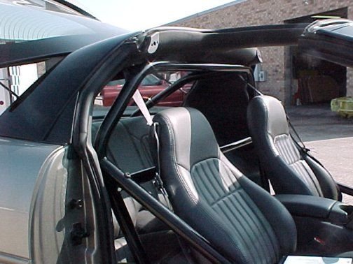

Im looking for a bolt in style cage for my 00 WS6. I checked Wolfe race craft and didn't see any pics of the 4 pt....Is anyone running this set up, or have pics? Not really wanting the cage with the bar running down besides the drivers seat.

I'm running the 6point in mine and 5 point in a buddies car. I installed them both and they fit nice.
You won't be disappointed with the wolf bolt in cage. I suggest the rear bars going into the speaker holes. It would be easier to install because you won't have to drop the tank. Looks better in my opinion too.

Need a min of the 5 pt for Nhra stuff. Imo I’d just do the 6 so it triangulated on the body evenly, makes the car a lot stiffer too

Not really worried about the NHRA stuff, Im doing this for my own personal reason in case something ever happened. Spoke with Wolfe and they do have the setup I wanted, just didn't have pics on their webpage. Its the same set up as shown here without the bars running down beside the seat.
