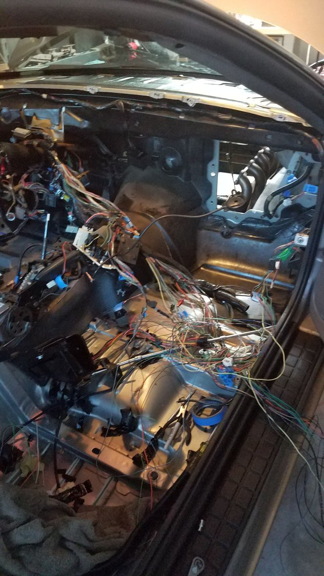

As far as the engine, not sure yet. I started rewiring and I want to clean up and possible paint the engine bay. I don't have immediate plans to tear into the engine. If I had the funds I'd put a 383 together. If nothing else there is a chance I'll tear the heads off and clean up the ports a little, but not right away.

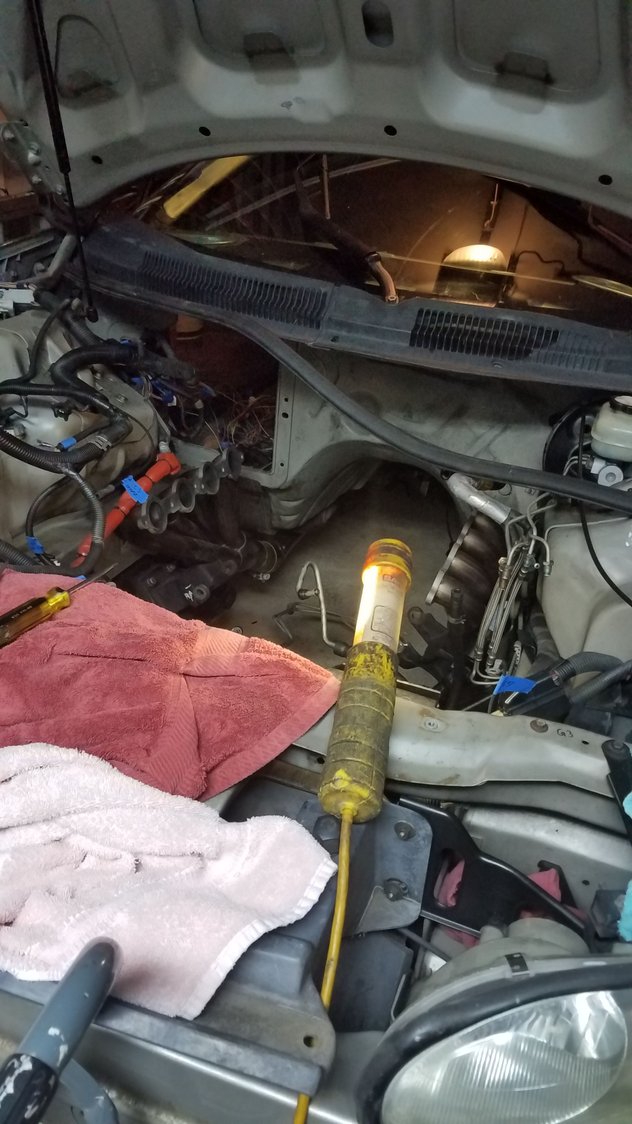

Beyond the point of no return. All to lose a few pounds.

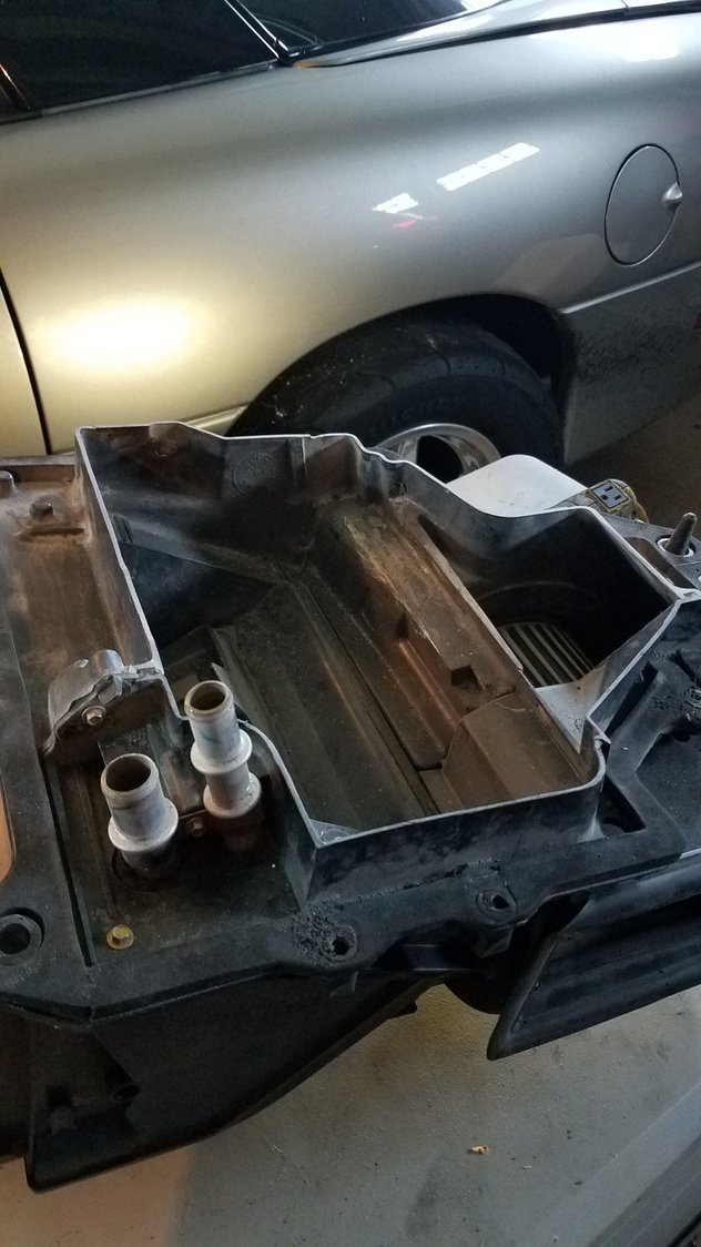

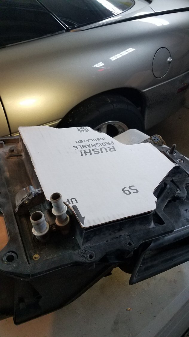

As of now im going to make my own block off plate. I have a sheet of .032" aluminum i can use. Just need a good way to fasten and seal it to the blower housing.

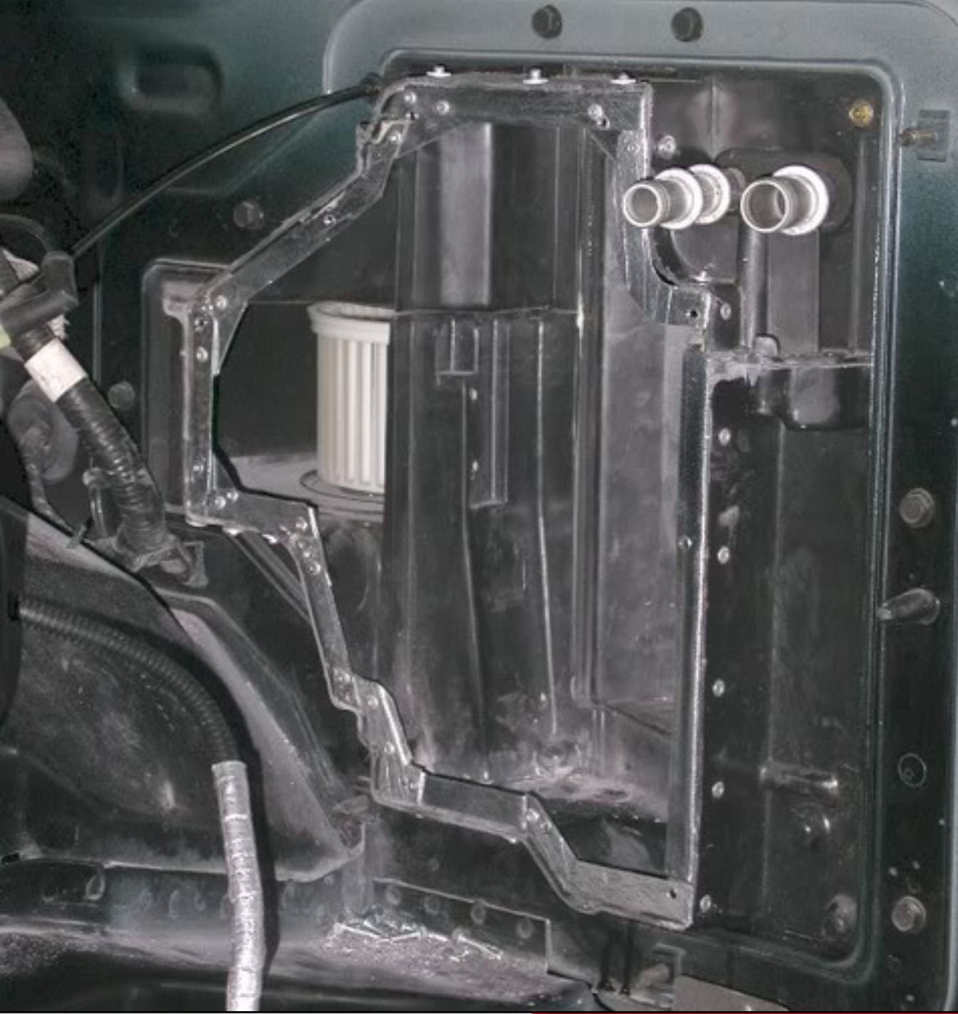

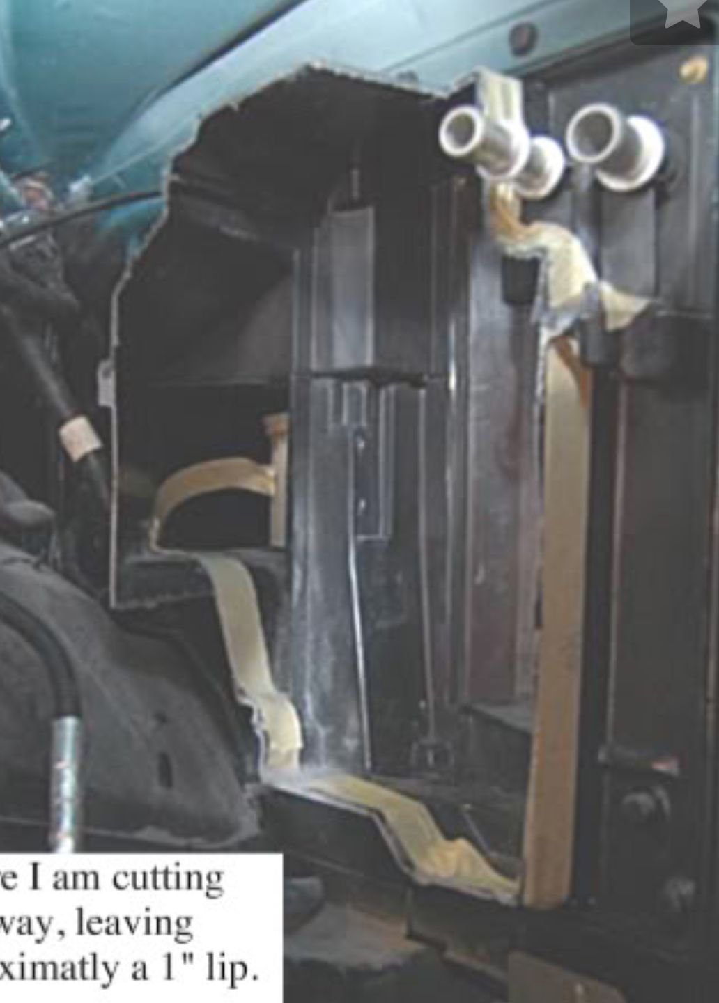

I did it some time ago, here is the link, but Photobucket blurred the pictures.
https://ls1tech.com/forums/drag-raci...-c-delete.html

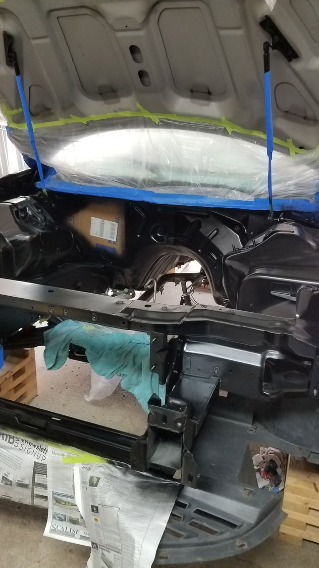

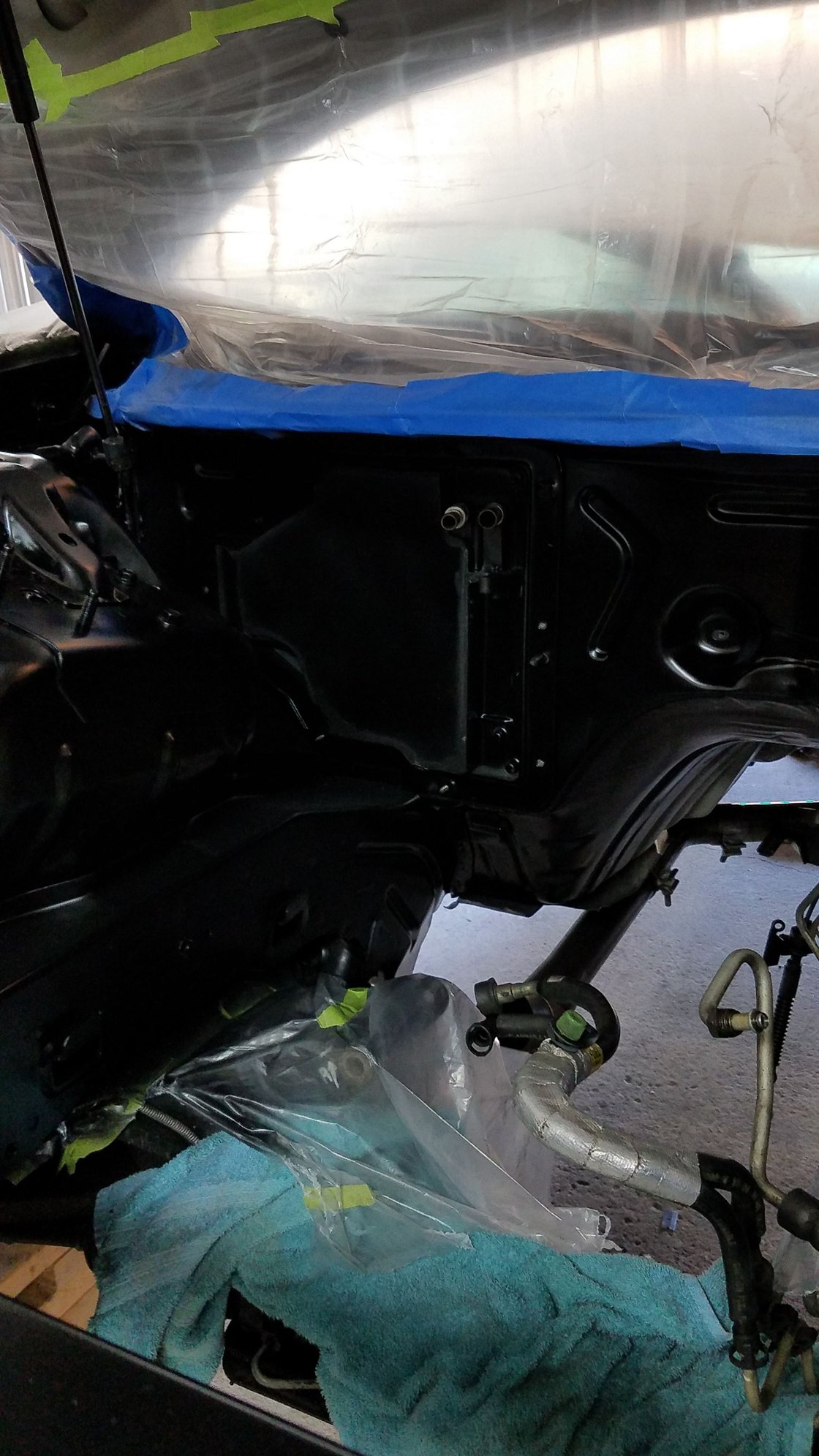

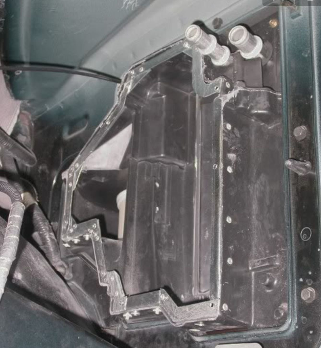

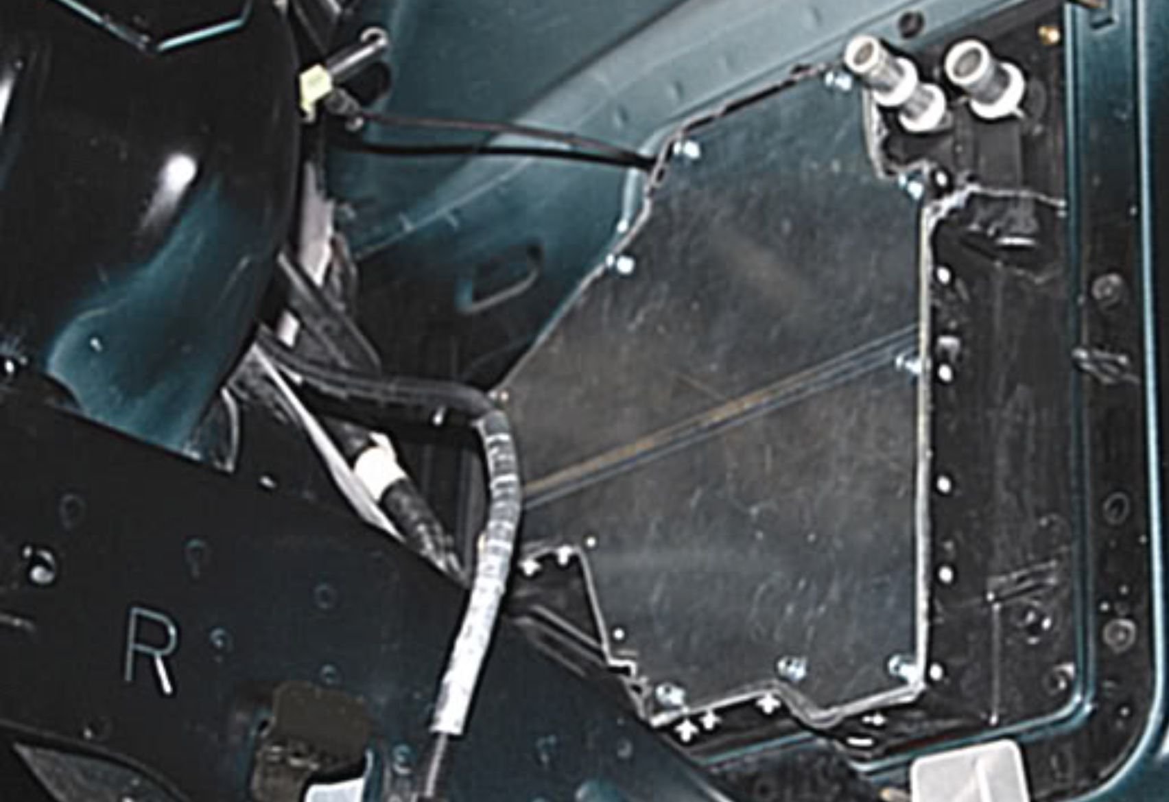

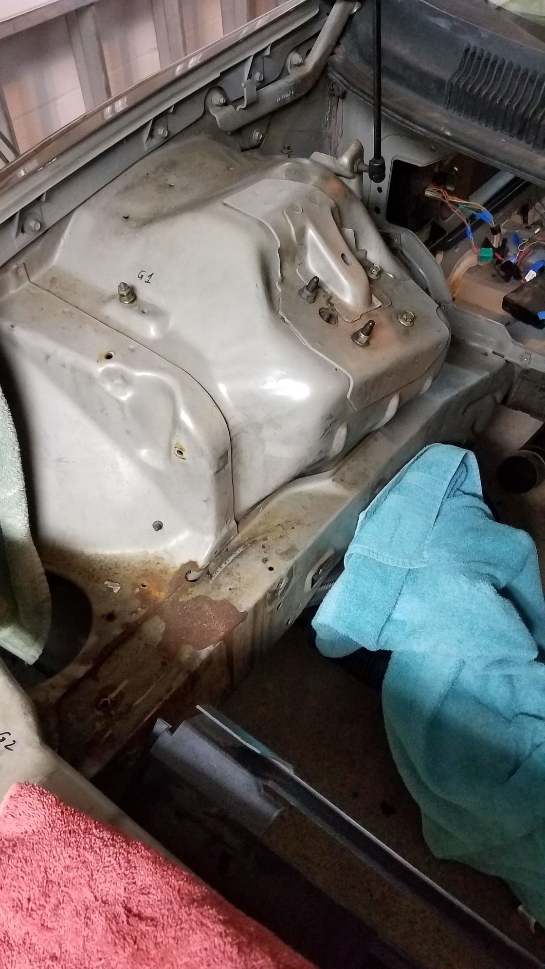

I thought I would be a lot further along by now, but was working a second job to save some money for a transmission. Now I am finally making a small amount of progress. Other than a broken transmission this is what started my madness. When I began to clean the rust under the battery tray the cheap paint came off way too easy and I decided to refresh everything. I really liked the look of Hot Rod black, but it didn't go with Pewter so I used a satin black instead.

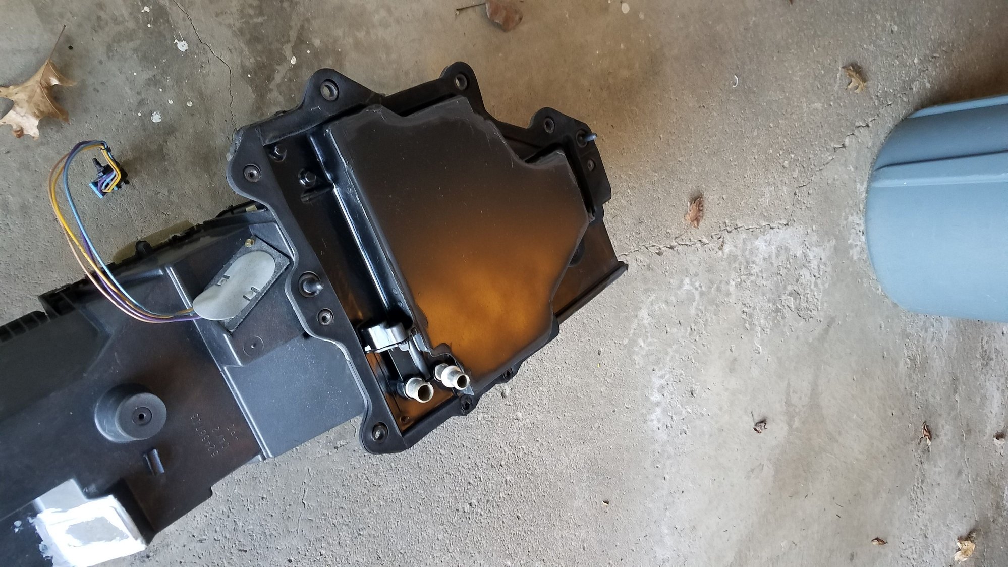

Here is the airbox. I used an aluminum plate, riveted to the airbox with some tabs and added seam sealer.
The last picture shows the airbox installed but it is rather dark and difficult to see any detail.

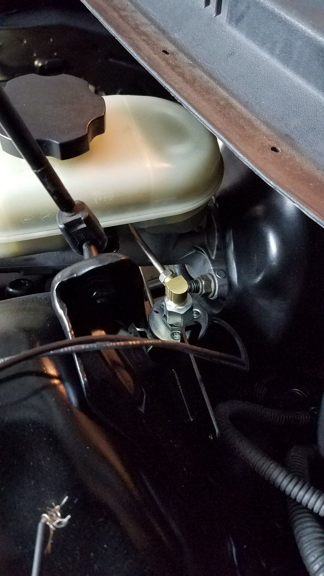

Line lock stealth mode. Sure hope this new plumbing doesnt leak.

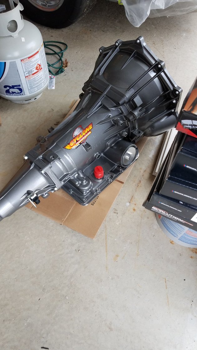

Thanks to Rich at Cyclone Transmission. This is one sexy A4.
