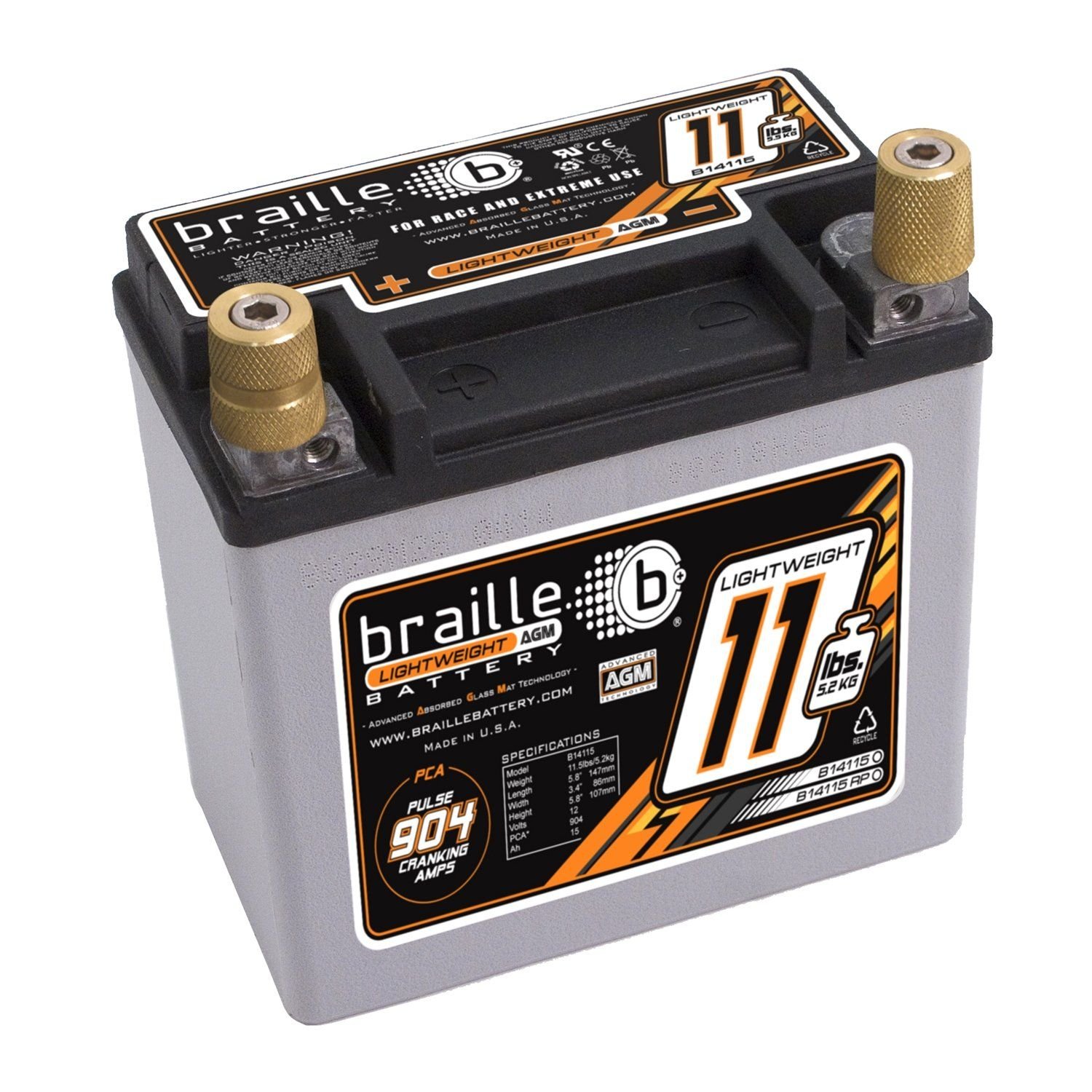

im looking at this one..https://www.jegs.com/i/Braille-Batte...B2015/10002/-1. for a street car...is it any good..any feedback ...or what else could i use ...thank you
