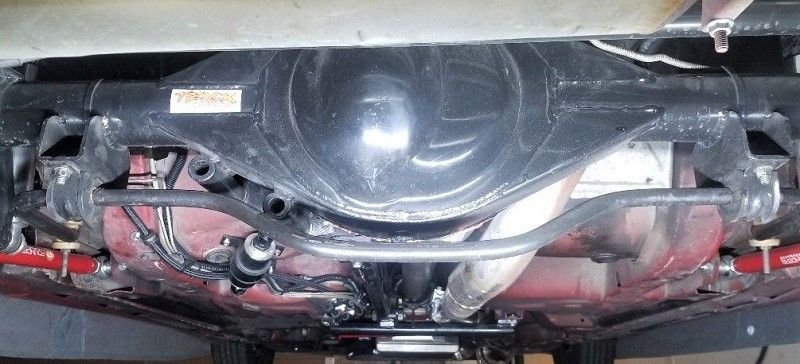

2000 Trans Am
Car weighs 4060 with me in it.
It has been 9.76@142, but "normal" sixty foots are pretty lame at only a low 1.5 (been 1.42 with nitrous on old combo)
May pull the driver side tire up a few inches.
No wheelies, no drama, goes straight, but get the "twist".
No front swaybar
Stock rear swaybar
Spohn short chassis mount torque arm
Spohn adjustable panhard bar
Spohn adjustable lower trailing arms (@ 4* downward slope to 9" rear axle housing)
Viking double adjustable rear shocks
Stock springs (95k miles)
Front, aside from no swaybar, is stock springs and stock struts.
Didnt really want to do a rear anti rollbar at this time
Can I stagger the rear shock settings to kinda trick the suspension?
In other words, can I tighten extension on left rear, and tighten compression on right rear and limit/lower the amount of twist?
Car lifts in the rear on launch, and usually maintains that lift for a while
Bottom pic shows how car sits at rest

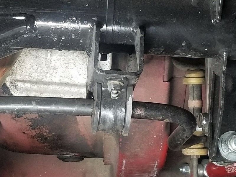

I do run a stock swaybar.
My swaybar mounts are welded onto my 9" rear. I'd never even try to run ones that were just clamped on.
The mounts came on the housing when I bought it. I ordered it that way.
I'm just going by what the highlighted area above (in previous reply) says, copied from your page.
My mounts are exactly 28.5" center to center. (one end of tape measure held onto outside of opposite side bolt, as I only have 2 hands, lol)
Bottom pic you can actually see the original wear mark on the bar, roughly 3/4" outside of bushing area, which (x2 = 1.5" + my 28.5") agrees with your 30" factory measurement.
