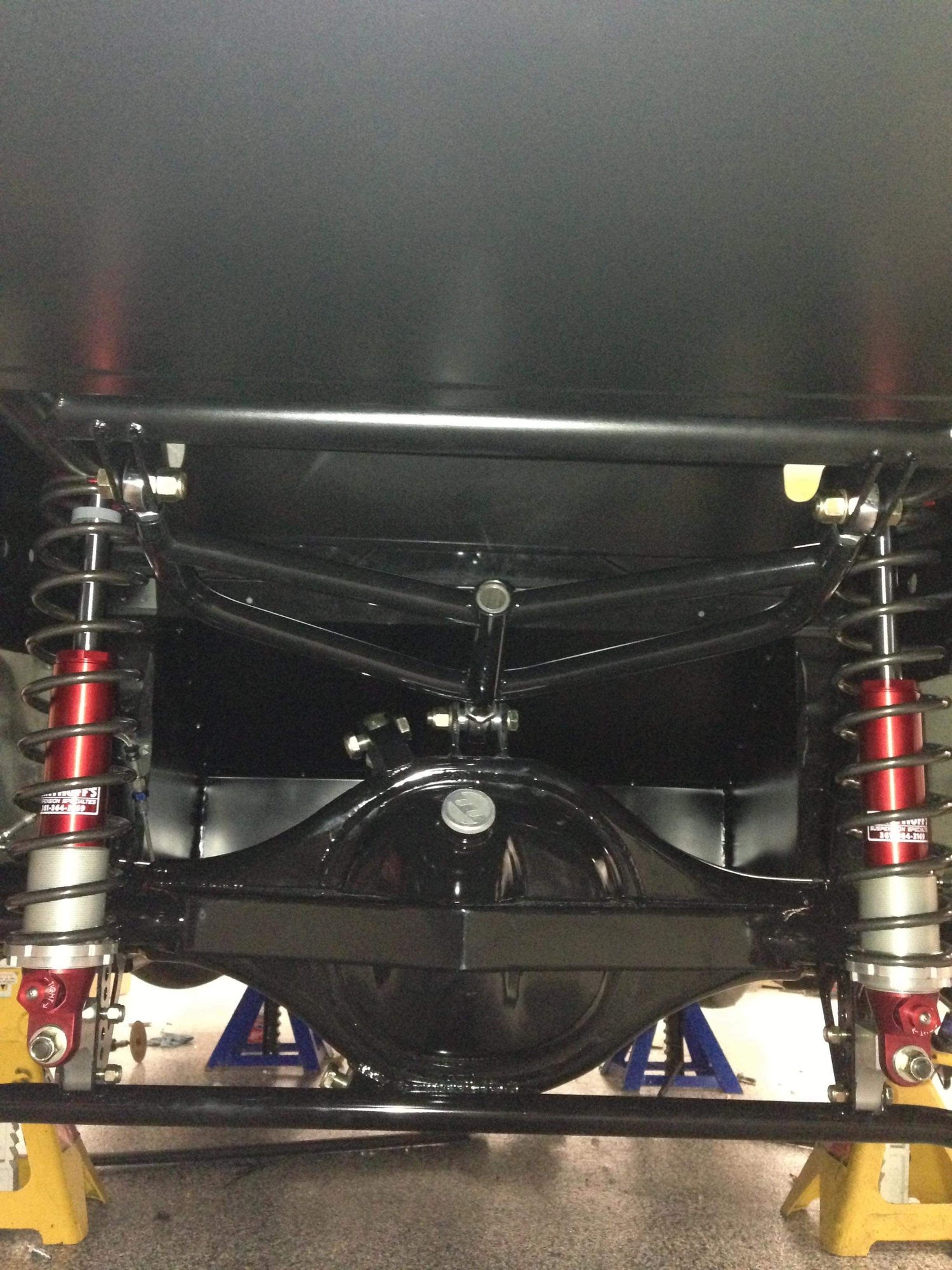

I did see that, one thing I am wondering is if it can be mounted on the bottom. I think kraweics car is set up with it on the bottom.
His is mounted to the bottom of the housing but the front portion is tied to the bottom of the main hoop of a 25.x cage. Other wise there is no where to attach the main body of the wishbone to.

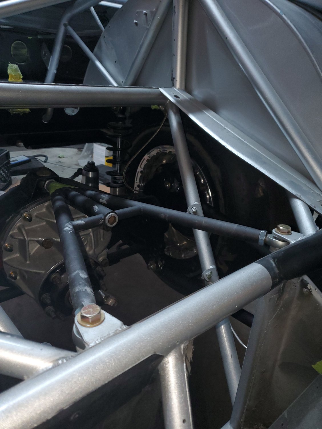

Tied into cage, shock and wishbone mount
