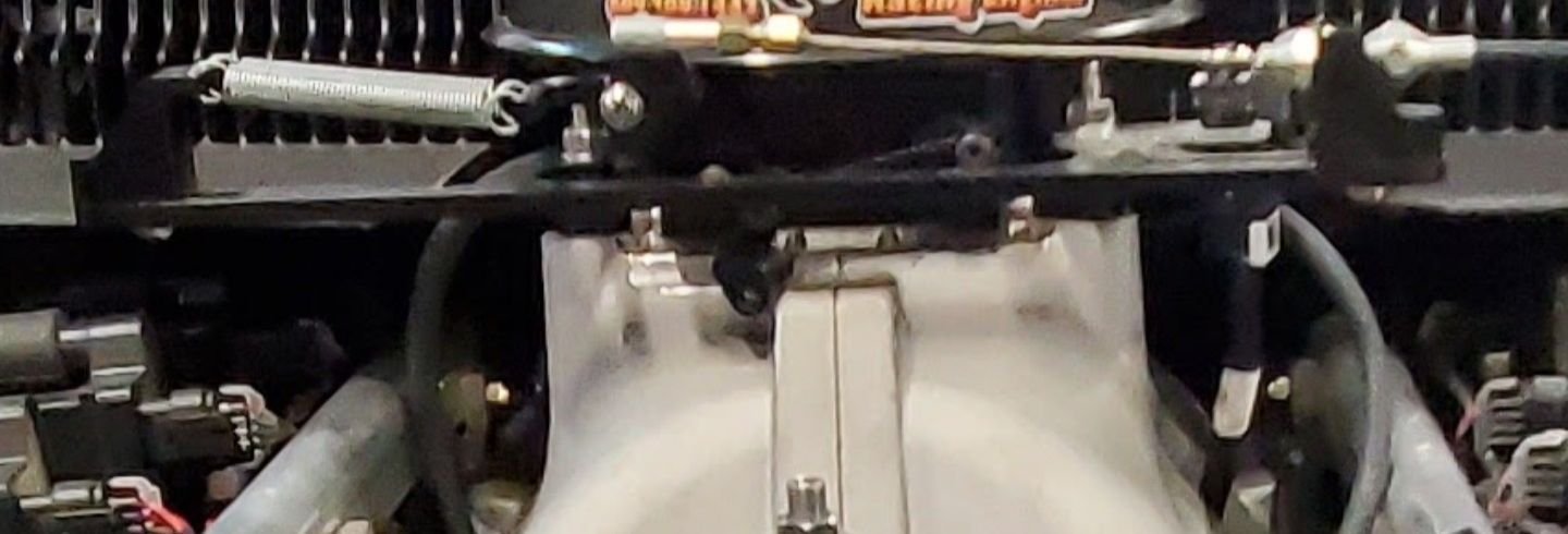

This is the 6" VFN Sunoco extended to the windshield pin on. There is a 2" wilson spacer, a 1" nitrous plate, and a 1" burst panel plate on top of the Cid with a dominator on top. In a 96 camaro. Should be the same from 93 to 02
ok , so including the dominator , U probably have close to 8-9 inches on top of the intake right ? I think I should be good with my 4.5” hood with a 4500 Accufab on top of mine , they’re only bout 2-3 inches tall

The front of the hood is even with the top of the spacers which is only 4 inches from the top of the intake. The back is even with the bottom screws for the float bowl. Remember I have a six inch. With a 4 inch cowl you would only have 2 inches off the intake. Your going to have to cut the hood.

I have an LS7 CID and Accufab 4500 TB with no spacers. The top of the TB is dead even with bottom of windshield.
YES !!!! That’s what I wanted to see , so it looks like I’ll have plenty of room , thanks brotha , any details on your throttle cable and bracket setup ?
I'm pretty sure it's a Holley billet aluminum throttle bracket with Lokar cable. Just know the intake needed a little machining to get the linkage to fully clear
