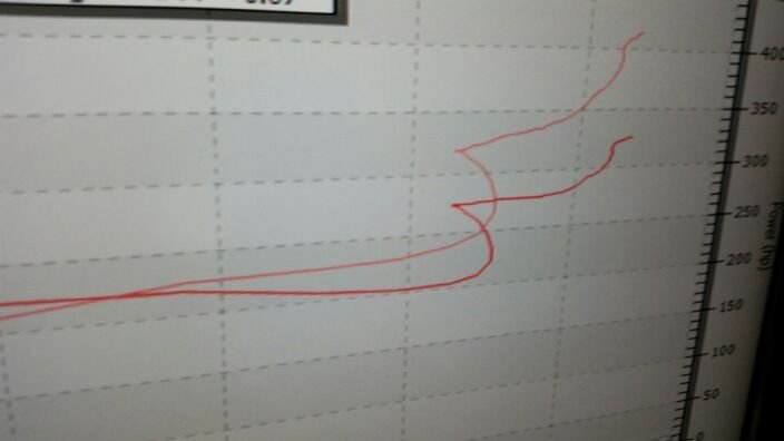

Am I flashing through my converter?
What's going on?

I've seen lockup look like that, or a shift?

Take a look at log data. I seen all kinds of funny graphs but these are new to me.

We logged the trans and it went from around 3300 rpm slip to around 900 at 7200rpm. Think I'm just pushing through it that bad? I guess the most logical thing to do is have the converter restalled so that it's where I want? I'm wanting to spray it but the way it looks I would probably slip it farther...

With a non locked up converter graph you should read it by MPH, not rpm. You look at rpm for slip but the mph shows a lot more.
