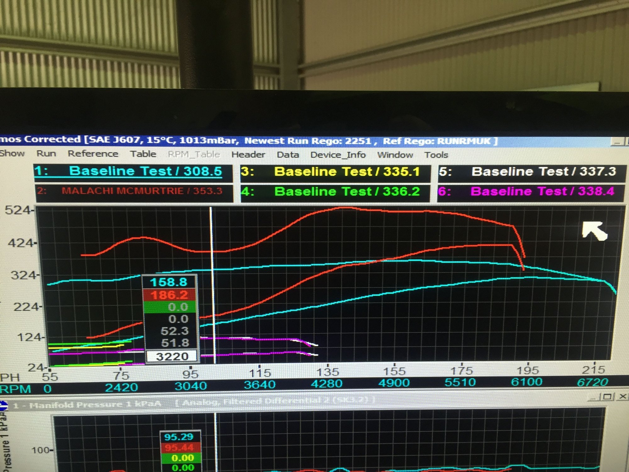

Old Feb 26, 2016 | 06:56 AM
MALACHI_TT's Avatar
Joined: Oct 2012
Posts: 57
So we are still tuning, had some other cars to get through also, and spending limited time on it. Doesn't help with the hottest days in 10 years being the days we want to get onto it, as well as the atmospheric correction up the **** and reading incorrectly by a long shot!
Still around 2000rpm left to map out, as we are starting from scratch. Will be around 550hp and 600ish ftlb by time we are done.
Yea the pic shows 15° and 1013mBar but that is WRONG!
Check for yourselves, the weather in Alice Springs has been around 41° the whole week, and around 900mBar.
Should hopefully have it done in the morning and take it for a test tomorrow afternoon if everything else goes well.
Still on pump 98 also. (Not sure what that equates to in US)
