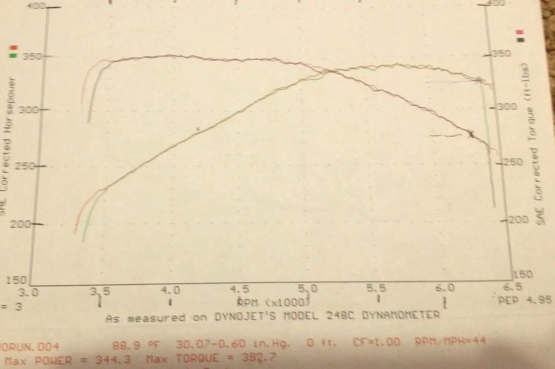

Here is what mine did with a 221/221 Cam. Pretty similar to the 220/220 Cam.
I believe this was with longtubes, 160 thermostat and a lid only. Stock catback. Unlocked converter. It dynoed 285 rwph stock. It picked up about 25 or so rwhp with this cam.
Really strong down low, but not so strong up top.
Not sure of you plans and goals with your project, but I also had a 230/232 cam that outperformed the smaller 221/221 down low and everywhere else, even better throttle response. Just throwing it in there.
