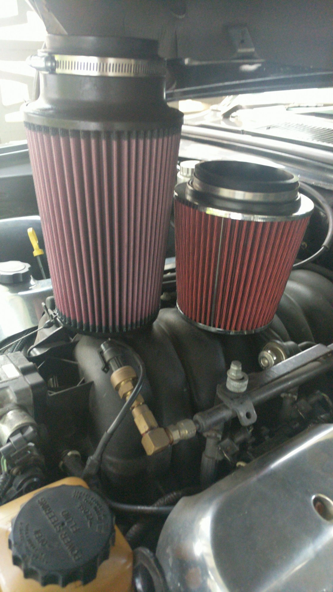

What is this pod air filter you are speaking of? A tiny choked air filter can kill tons of RPM/HP.

Post some pics op.

New vs old filter. New is a 9" K&N.

Those fuel pressure sensor fittings are just waiting for a fire. I have a video on my YouTube channel that shows what happens when you hang all that off the end of the fuel rail.
Andrew

Yeah I was waiting for someone to comment on that cluster **** of fittings. I've been meaning to simplify it but maybe an aftermarket fuel rail is just easier. I went and watched your video, did you end up with a new rail?

I was lucky to have discovered that fitting right before a 500 mile road trip. I'm not joking when I said that it would have burned my GTO to the ground. I needed to do an emergency repair because we were on a schedule. I made a few phone calls and managed to get a local guy to fix the rail. We made the trip and the fixed rail is still on the car. I have a spare, just in case.
Get that **** taken care of. You don't need to see your Holden up in smoke.
