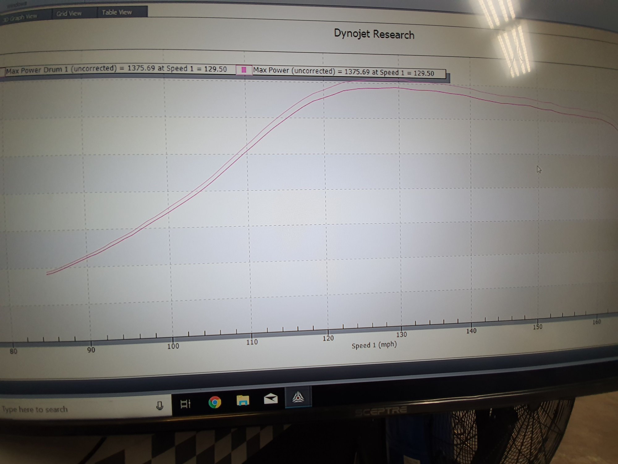

Managed to tune my truck yesterday
ran out of fuel pressure if not i woulda gone for more
29-30#
402 ci stock block
Twin china turbos
4l80e unlocked
8400rpm
1375 wheel
Terminator x
has ac, heat, leather seats, sound system, all factory gauges work, etc

Nice OP! Seems like its dropping off up top, Chinese woobois out of steam? I like the sorta matching bumper exit lol
How did u get 8xxx rpms
You keep your foot down

Am I reading that right, those are uncorrected numbers?
yes corrected made more, but i wana know what its making actual without any number fudging
And falls off top because holley closeed loop pid sux a lil so boost was tapering off
St2116lsr lifters

Wow the piston speed must be insane at those rpms with a stroker.
