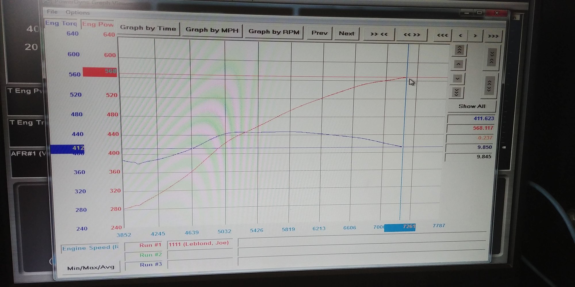

*the clutch slipped on the dyno* video link https://youtu.be/-bYzmGNH3NM @28sec
Did 568rwhp today, but the run was cut short cause the rpm signal was off. Gonna dyno next week and should be good for 580rwhp.
The hp is still climbing and should peak around 7400-7500.
I am satisfied with the results on 91oct.
FED heads are the goods; custom 262 TFS program.

Strong power curve. Cant wait to see full pull and some draggy pulls or drag strip passes

It might peak at 7800. Crazy power curve. That torque curve from 5200 to 6200, though.... wow
Old May 4, 2020 | 10:41 AM
Johnnystock's Avatar
Joined: Feb 2007
Posts: 2,686
Likes: 41
From: Canada
I am impressed with torque too. The car seems to pull forever. I like it!!

Nice power, what size camshaft?

Great torque curve.
cam specs?

239/253 720' 702' 112lsa.
That's a healthy camshaft.
Is it a cam motion low lash solid?

yes..

What intake is on it?

I think this is the only time I've seen those TFS heads actually work. Kudos to FED.
Great results man! I love LS3's with a 239 intake lobe.

Custom sheet metal by Goertz1. It clears the hood. Its between a LOD and a Hi ram for runner length and a big plenum. 102mm.

Yeah I was confident about FED program. Its one of their old design, they dont do it anymore. The extra ptv prevented me from having to notch the pistons, which was a big deal for me.

I see those intakes are custom made runner length for your combination. Do you tell him how long you want them or does he figure that out for you?
intake has me intrigued

You can pretty much tell him what you want for runner length and everything...tapered or not,height, etc. He takes his base design and can work something out for you.

Just blew the slave cyl seal. Now that it happened I realizedit slipped on the dyno and thats the dip at 7000. It slipped for a good second. I have it on video.
