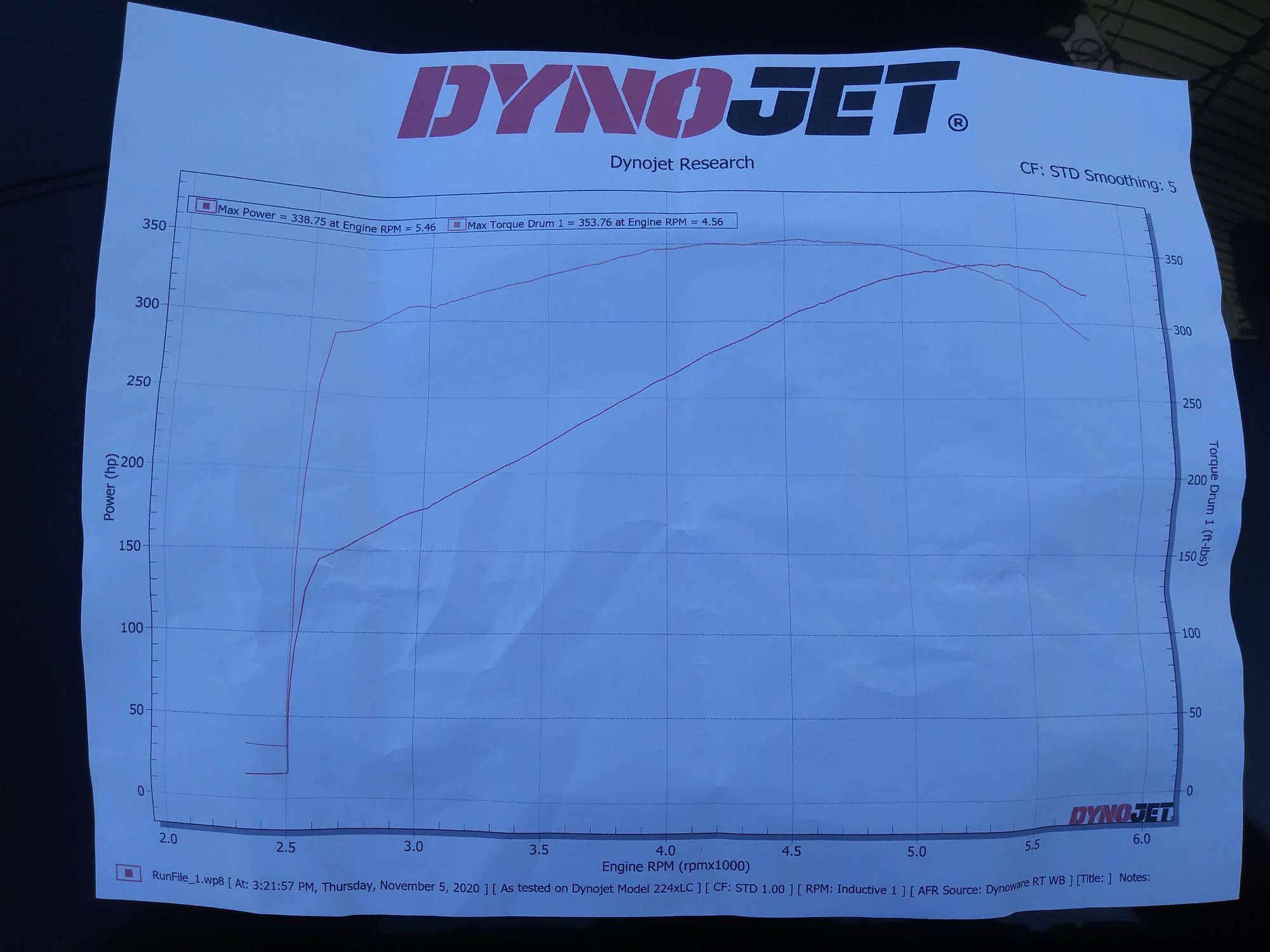

While in the process of getting my drivetrain build together...I couldnt wait any longer, had to put some mods on and see what she could do on the dyno. Numbers were as expected (figured 330-340ish tops from what I seen all online with these cars) the trq definitely exceeded my expectations though for an A4 lol. Overall I am happy. Curious about the drop off power up top, tuner let off I am assuming? I never asked but maybe I should have, cause it clearly wasnt ran to redline. I was told by some folks many tuners dont push it there unless requested, is this anything I should worry or ask about? Setup below by the way.
01 C5 A4, Vararam cai, de screened maf, SE 1 7/8 longtubes, SE non catted x pipe, B&B Bullet axelback, SE plug wires, NGK TR55 plugs.
338.75rwhp & 353.76 rwtrq on 93 pump

First of all interesting plan, cool.
Second, you have to have your tuner convert to SAE, not STD correction factor. SAE is industry standard. Will take two seconds, your numbers will not be the same...
Do you have it yet tuned ? Perhaps why he for whatever reason, didn't run it to redline
As far as the horsepower drop off, might be valve float, have seen this, exactly the same.....
