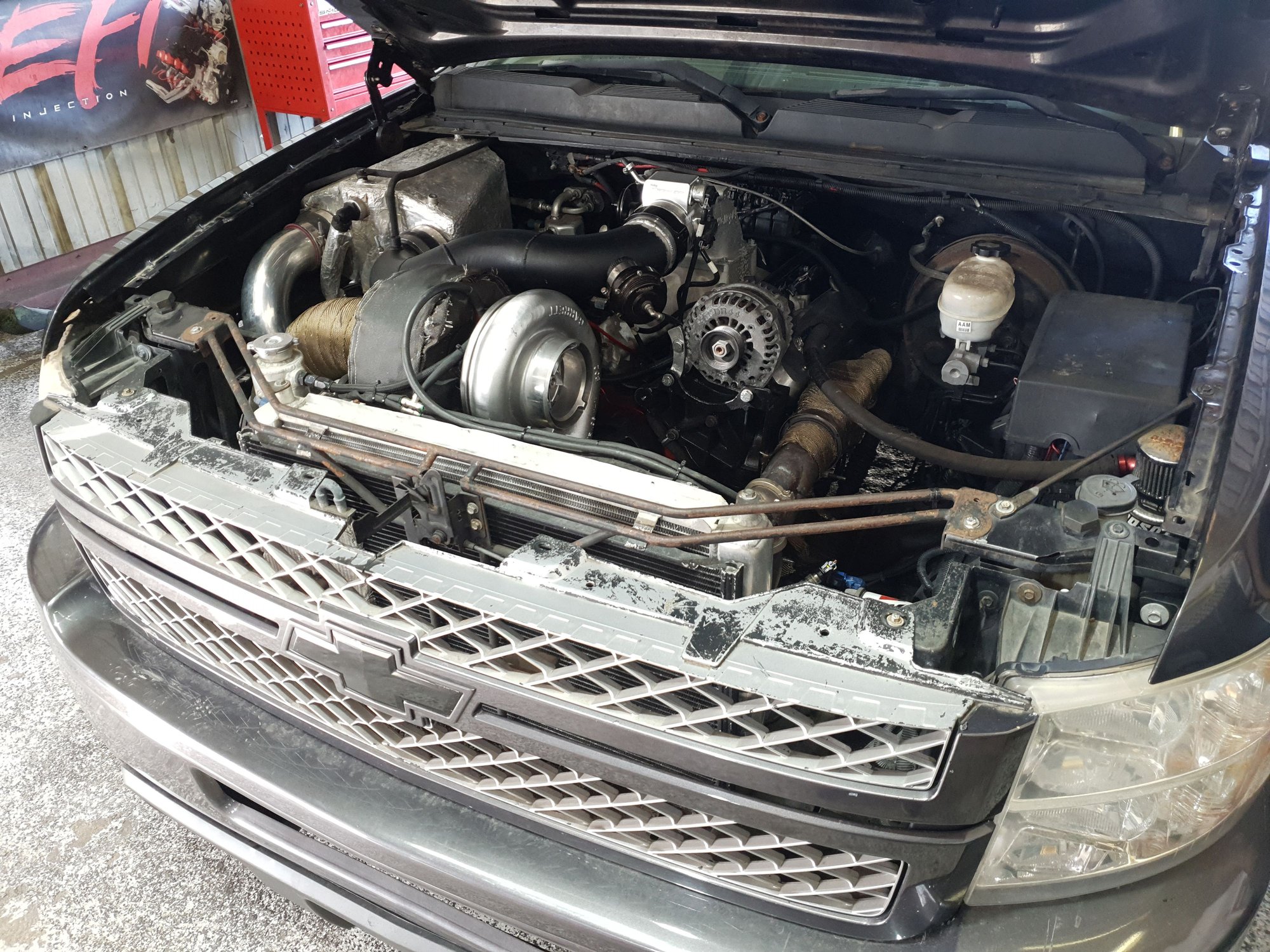

1410RWHP
416 ci
Stock 821 heads
Th400
pump e85
FI garrett 98
9 inch
Ran out of fuel pressure unfortunately
34#
Some aftermarket heads, a better fuel pump i think on the same boost itll do 1600😁

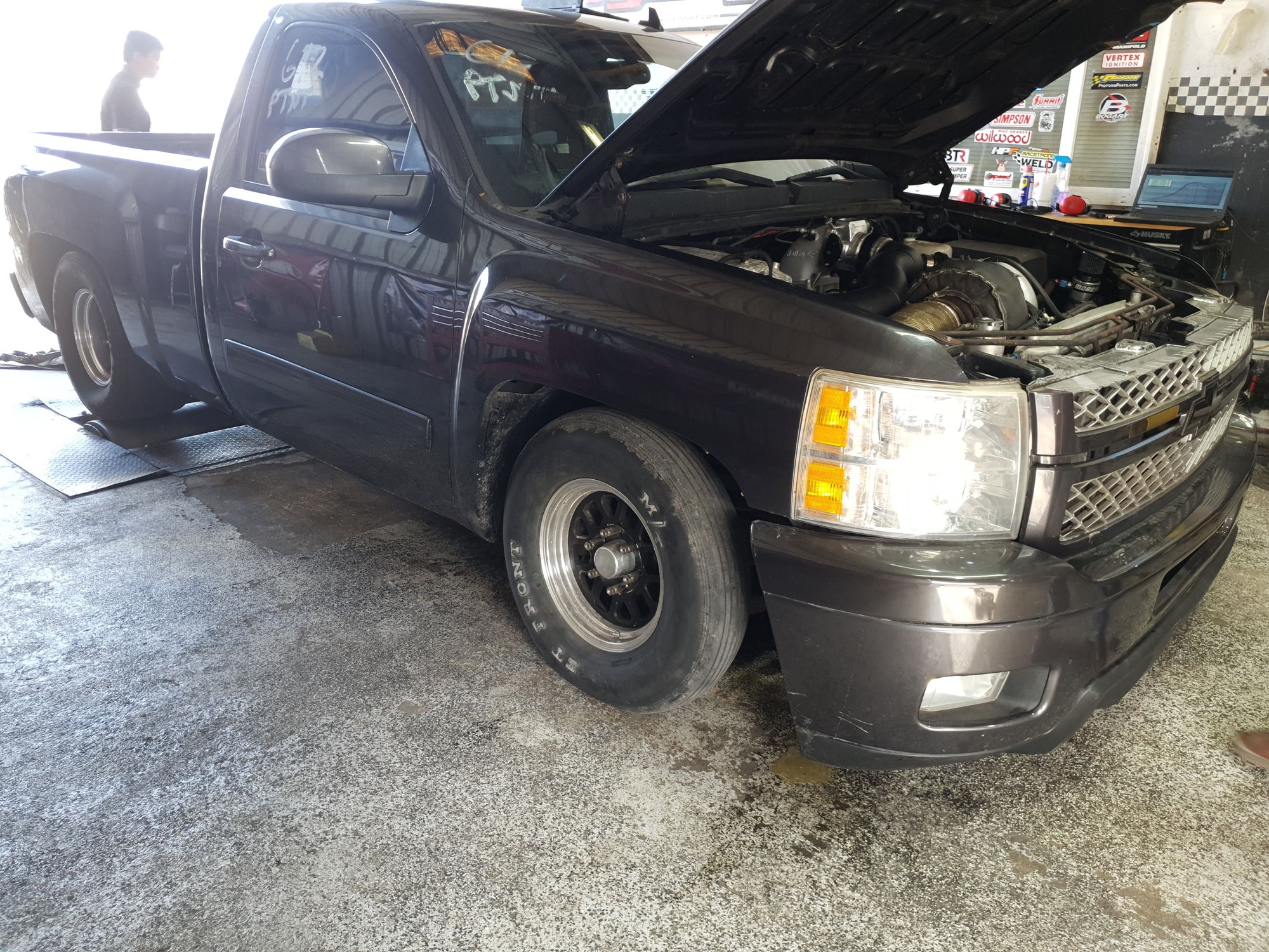

Truck went 5.2 at 135 yesterday on a soft ramp 33 psi , footbrake no transbrake.
Truck weighs 4600 w driver.

Details of the 416ci. Who built it?
Old Feb 26, 2021 | 11:10 PM
subeone's Avatar
Joined: Apr 2013
Posts: 1,317
Likes: 93
A local shop here in Houston TX
USA RACING ENGINES sometimes called
The Wop Shop
